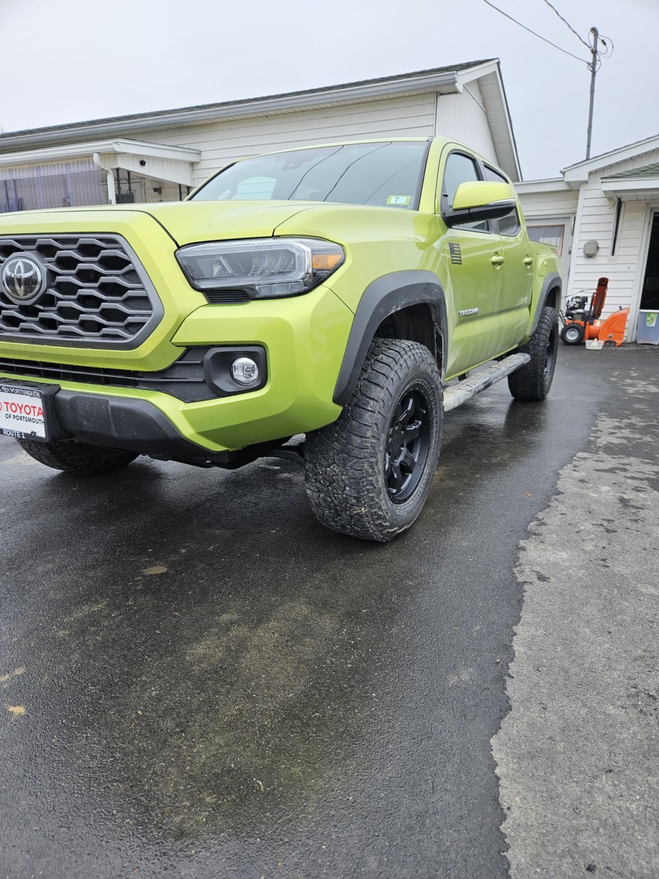

    Hi everyone!
    Brand new Tacoma owner here with a clutch question/ask for advice. I just picked up my brand new truck last week and am having a lot of trouble adjusting to the clutch - not killing it or anything but it's causing some pain and feels off. Specifically, I am having to push really hard and far, especially for a start-up shift for instance.
    I did some searching and came across some previous threads, including ones with specs saying the pedal should be 7 to 7.41 inches on the height measurement
    (For reference:
    https://www.tacomaworld.com/threads/2016-manual-tacoma-clutch-engagement-adjustment.640297/)
    Well I measured mine and low and behold mine is measuring 6.13"
    Questions for more experienced folks:
    -is this inch difference likely to be causing some of the issues I'm having?
    -is this better addressed by me or taken to a dealer? the dealer we purchased from is not local and I'd prefer to fix it myself if that's advisable
    -any tips/links to threads welcome
    thanks for reading. happy to be a part of the tacoma club!
