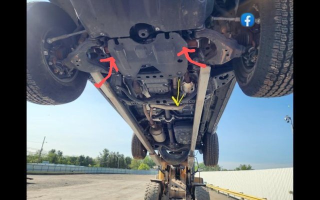

    In the bend is where it accumulates its already discoloring the exhaust and I'm worried it may get on rubber parts and destroy them prematurely.

    I have to admit, that's a first for me seeing a truck lifted by a fork lift :)
    5465, OBXPaul, SR-71A and 2 others like this.

    That's how salvage yards move vehicles around the facility. Really fun to drive!

    Lol I know I just pulled it from Google so everyone could visualize where the oil is hitting the exhaust. I guess it's a good thing in a way because if you got any oil leaking it's going there first and sends smoke signals right up very noticeable!

    We always just put the forks through the windshield so we didnt damage any of the suspension. Roofs and headliners were worthless so we didnt care if we damaged them.

    Oh ok, so you didn't lift your nice new truck with a fork lift. I can stop having chest pain now LOL
