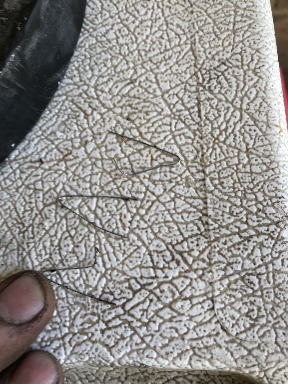

    I found this in the bottom of my axle housing after taking out my third member. anybody know what they are?
    EDIT. I figured it out. It's from the wire brush I used to clean the rtv off
