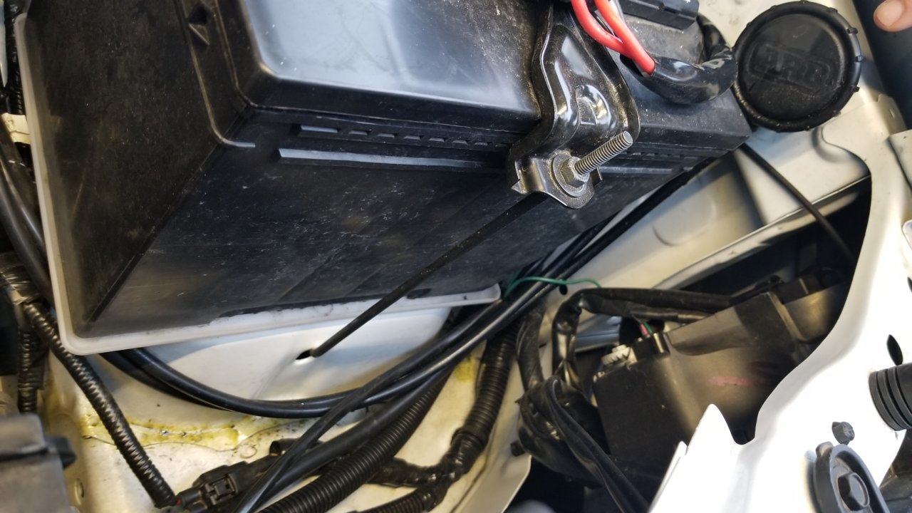

    One my lockers is spewing oil out of the breather which was mounted in the engine compartment. It was assembled July 2019. But my compressor runs just a bit to lock and then never turns on again. Any ideas? Getting ready to take a multiyear trip on 6 continents starting in May!

    2017 4Runner
    Have any drastic changes recently in elevation/temp? Mine has spewed a little oil out of the front diff one time, and that was when I drove up a mountain, then back down in the same day, about 3,000 ft gain/drop. It was also balls cold. I did some reading and saw one person mention that so I just chalked it up to that and kept an eye on it. Hasn’t done it since, even though I’ve been back to that place a few times.
    Edit: to clarify I have no front locker either.

    If your compressor is cycling off and on, and oil is coming out of your breather, chances are high that your locker's seal is bad. If your compressor does not cycle, it's something else. Compressor turning on repeatedly is a sign that it is leaking air.

    Thanks Actually I did take it to work about 10 days ago. I live at 2,000’ and climbed to over 5,000’ and the temp was around 20 degrees colder; around 10 degrees. Hmm, haven’t talked to Joe at Mule yet as todays his day off, still having lithium battery/switch pro issues of the camper battery running the truck accessories when the truck engine is off.

    Luckily the air compressor only comes on for a couple of secs to engage the locker and then never turns back on.

    Ah, your locker's good then man.

    So have they leaked enough to have to refill the diff? Or is it just oozing? Mine may have put our 1 ounce or so

    You can see the oil in the lower left corner of the photo below the battery
