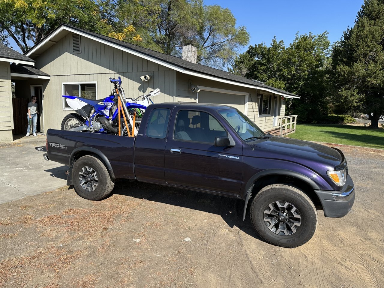

    VolcanoTacos
    VolcanoTacos [OP] Well-Known Member
    Sep 24, 2022
    #406505
    48
    I contacted them mid-day Friday and didn’t get a reply so don’t expect anything until tomorrow.
    This weekend we did load 2 dirt bikes ~ 450lbs and there is about 1” of suspension travel left before the bump stop.
    I will be sure to keep everyone updated in what GS says

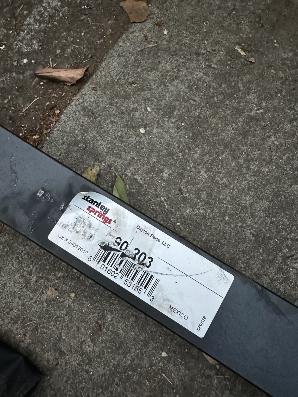

    VolcanoTacos
    Sep 24, 2022
    #406505
    48
    Well it’s been 2 full days so far. I got one reply and they said “that’s weird it sits lower than stock height, can you send me a picture of your stock springs” which I did and no reply in over 36 hours.
    They did not think the kink was weird or a problem. I would highly advise people NOT to get the standard duty springs from GS. Can’t comment on the HD.
    But anyone following this thread - General Spring DOES NOT make the springs they sell. They are just a distributor. The same springs are available at AutoZone for cheaper shipped. If you Google “90-203” and “90-201” for the standard springs or “90-203HD” for the heavy duty springs you will find the same ones available at RockAuto and others as well.

  6. Oct 11, 2022 at 3:44 PM
    #26
    VolcanoTacos
    Sep 24, 2022
    #406505
    48
    The springs that GS shipped to me are made by Dayton Parts and sold as “Stanley Spring” brand. On RockAuto they call it out as “Dayton” and as mentioned before you will see that all the parts houses sell the same spring. For example Napa’s part number is “NA90-203” which is obviously the exact same part with their sticker on it.
