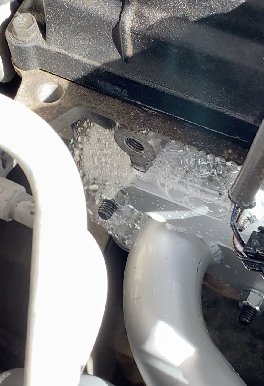

    Hi Guys,
    First post here. I have gained lots of great insight through TacomaWorld, So I need to ask you guys for some tips.
    I recently got an LCE Header to help make life going up-hill a little easier for my 2.7 2011.
    I took it to a local shop, gave them the kit, and had them do the install. 3 days later, what I thought was typical burn-off ended up being an exhaust leak coming from the header.
    When I tested it with soap water and reverse air flow through the muffler, I found a big leak with bubbles coming from all around the top and rear of the kit ( See Photo ).
    I brought it back in. The shop took it off, and reinstalled it, only to have the same issue.
    LCE thinks it's because of a damaged gasket during install. Also, my stock exhaust and manifold were fine with no issues or leaks ever.
    Any advice is much appreciated. Thanks!!

    I would take it back off, take a straight edge to the head and the LCE header flange to see if they’re straight. If those both check out, then you probably just need to get a new gasket. I have reused my stock gasket without issues before though, so I am wondering if something else is amiss

    Whereabouts are you located? If in central Texas Id be happy to assist
    also do you know what kind of gasket they used? A multi layer steel one like stock is gonna be what you want

    Thanks for the reply, Im in Northern Nevada unfortunately. LCE provided a gasket in the header kit...and they suspect it could be damaged from the shop install. I have another gasket from them coming in. Thinking I'll have another shop check it out, inspect and reinstall with a new gasket. Hope that would work, don't know what else it could be. The chances of an un straight edge on one of their headers seems pretty unlikely perhaps>? Seems like anyone whos wrote about them had no issues with the mod.

    I agree, the gasket is more than likely the culprit, but it won’t hurt to confirm the flanges with a straight edge. It’s typically the other connection that causes exhaust leaks from what I’ve seen. It might be a good idea to replace the down stream gasket where the collector meets the mid pipe too since it has to come out again.

    2nd mechanic/shop had no luck either. Gaskets were replaced, everything. When I reached out to LCE again, $500+ in labor later, I find out there could be a production issue on the header....I'm sending it back for a refund and am unfortunately just going to call it a loss.
    All parts including the studs were replaced in this attempt

    I will admit that their customer service is pretty solid regarding the issue. They also say they will be rolling out new production and it should be ready to go in at least 6 weeks. Now my question is, do I bank on the new builds and try again, or just leave it alone...

    Guessing the flange wasn't flat. Machine shops charge like $20 to surface something like that, but it creates a lot of heat and can burn off any coating

    With any style header by doubling up header flange gaskets this will an insure a leak free seal . Using high quality header gaskets from Remflex , Mr Gasket or Felpro and using alumna seal style design material will guarantee a leak free seal

    LCE was really helpful. After working it out with them, there was some kind of issue with the weld on the header I ordered (isolated flaw, I just got unlucky). They pulled what they had, and I believe they inspected them all...then did a new production run of the header and sent me the first one (tested and built by their main guy). Great customer service. They stand behind their product.
