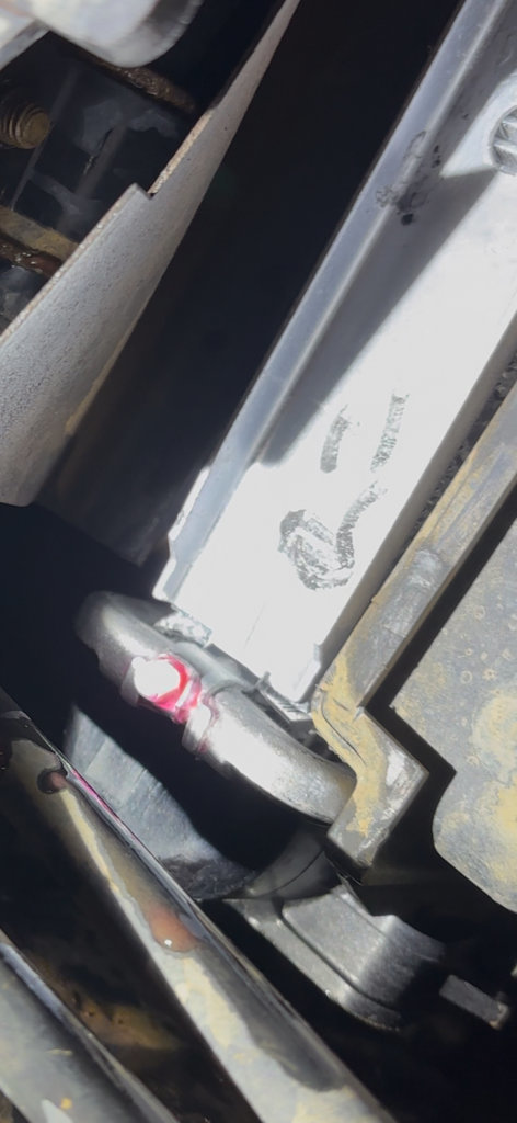

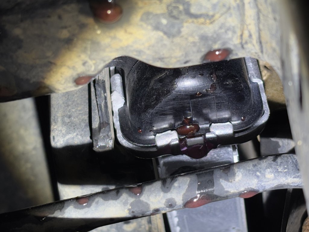

    Here’s where it’s leaking from. Not sure if the video is working.

    Clearer pic.

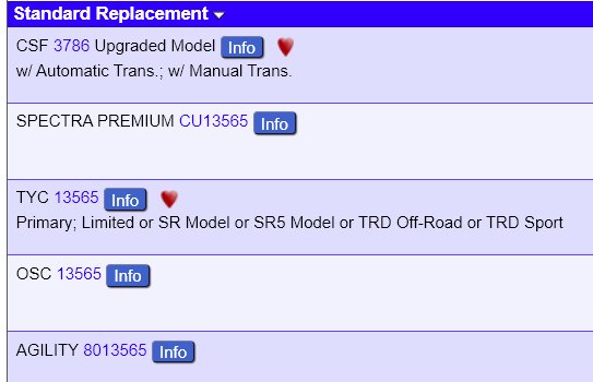

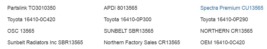

    The plastic end tanks are crimped to the radiator body. There's a gasket at each end tank providing the sealing. Not sure if you have a local shop that can pry open the crimp and replace the gasket.
    Alternatively order one of these aftermarket interchangeable radiators from a source closer to you:
    jardoo[QUOTED][OP] likes this.

    Yup this is what I did.
    One of the black plastic side things was cracked. He replaced that part with the old one on my old radiator. Everything is fine now.
