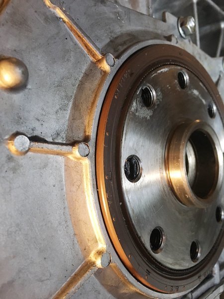

    I'm putting the new seal in, does this look right? I have the inner lip of the seal flush with the crank but sticking out past the cover. Is this fine or does it need to be sitting flush with the cover? @Torspd can I get our opinion on this ?

  9. May 6, 2017 at 2:16 PM
    #29
    Tacotruck422
    Tacotruck422 Well-Known Member
    May 3, 2016
    #186060
    81
    Seattle, Wa
    2015 DCLB
    Pro wheels, bilstein 5100's, 265/70/17 ko2's
    In more. Flush with cover

  10. Nov 5, 2018 at 2:22 PM
    #30
    BassAckwards
    BassAckwards Well-Known Member
    May 3, 2016
    #186002
    27,948
    2009 Tacoma AWD Turbo 2TR-FE
    Full-time AWD & BorgWarner EFR 6258
    Any updates on how this worked out for you? did you tap it in further than in this picture or leave it how it was, and did that solve your leaking issues? About to tackle a clutch on mine and after reading through your story, im debating whether I want to replace the rear main at all since it isn't leaking right now and my truck only has 55k on it. Im also supercharged like you, which led to the early demise of my stock clutch. Any insight would be greatly appreciated
  11. Nov 5, 2018 at 2:55 PM
    #31
    azzwethinkweiz
    azzwethinkweiz Well-Known Member
    Sep 6, 2016
    #196623
    974
    Tucson, AZ
    2013 4x4 DCSB V6 6-Spd, TRD OR, Tow Package
    Every main seal I've done including the Tacoma has been tapped flush. Had an experience on a Honda where the seal was past flush (sunken slightly) and it caused a leak. My Rear main seal came pre lubed with a clear grease... just tap her in flush and you should be good.

    I took a peek at the FSM and this is what it says about the seal depth:
    "Using SST and a hammer, tap in the oil seal until its
    surface is flush with the rear oil seal retainer edge."
    The procedure also wants you to put sealant on the first 2 or 3 threads, of the flywheel mounting bolts.
