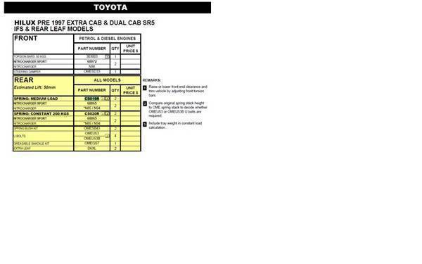

    The CS019R is made only for 1997 and earlier truck. It is shorter than 98-04.

    I used the 60062 shock with the dakar pack, no shackle and it overextended. When I put the leaf pack in, I had to compress the leaf pack at least 1/2 inch to connect the shock..... = shock to short. Then after wheeling a bit, they were wasted. Gonna screen shot the 2012 arb catalog in a sec. I put the shock info in my build if I remember. I upgraded to 5125s from DSMS and love them.

    Yeah. They gave me the run-around. I ended up with @ 3-1/2" lift when I put the leaf pack in originally. That was with the cap. I am a regular cab truck though but the down flex will be the same as a extra cab.

    Adding shackles I used the Bilstein 5125 11" offroad shock. Without the shackles I would have used a 9 or 10". The OME shock is 23.11" extended. The 5125 9" is 24.35" extended.

    Holy crap. For the 98-04 X or DC the Dakar without AAL is 2.25. Yeah I was scratching my head over the fact that you are a 4-banger single cab, but that can be a factor to your failure. In the end, droop is droop.

    Look at the specs on the extended length of the 5100 for the Tacoma. I pulled an overload leaf out, then put it back. The height difference in negligible.
    The 5100 that is made for the truck (with a 3-4" lift in the rear):
    5100 spec for Toyota truck
    Part# 24-185752 collapsed length 16.00" extended length 25.63"
    It recommends using different bumpstops in the catalog.
