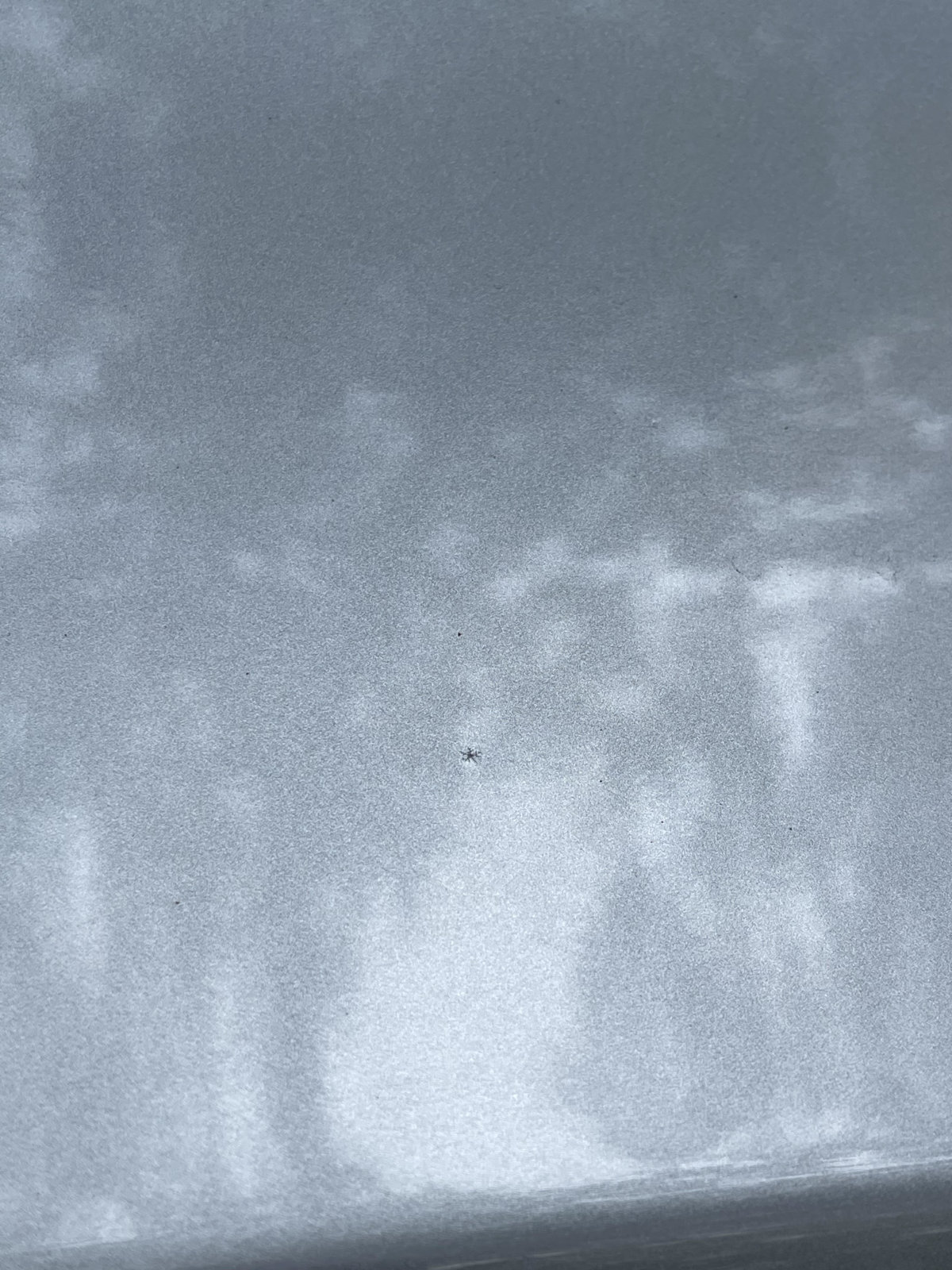

    We bought a brand new2023 TRD OR 2 weeks ago and it has been in for alignment twice---got it straight the second time and while overlooking the side of the bed noticed a blemish in the paint.
    Is this poor paint by Toyota or something that is caused by a rock. We live 30 miles from dealer and want to get your thoughts on what you think it is. If its because of crap prep-work, we will take it back to the dealer again for the issue.
    Included zoom shot as well, it looks like its cracked from underneath---just don't want it to spread and rust.
    Thanks!!

    I’m no painter but it does look to be busted out and not in.
    There is a goodwill campaign (probably not the actual name of it) by Toyota to remedy the 3rd Gen paint issues, which are well- documented on TW.
    Good luck getting it sorted out.

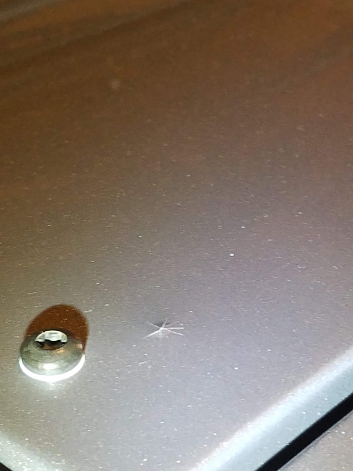

    Had a similar issue in 2018 when my wrangler came in. Dealer removed the panel stripped and painted matched it perfectly. Was told the cause was Robbie robot laying to thick and too many coats. Do know but if that's truly the cause but it was fixed perfectly and still looks great today.

    Looks pretty similar, i could care less about the size or shape of it, i just know that is about to peel and spread eventually and this truck will be ours for some time.

    Yeah, that’s a pain issue. That certainly goes all the way down to primer.

    I get that you want your new truck to be perfect (at least for awhile), but damn! And since you asked, it looks like a small rock chip to me. I would put a small dab of touch up paint on it and call it a day. And even if it was a (very) minor factory defect, I'd still do the same rather than drive 30 miles one way to the dealer to point something that smalll out. But do whatever will help you sleep at night.

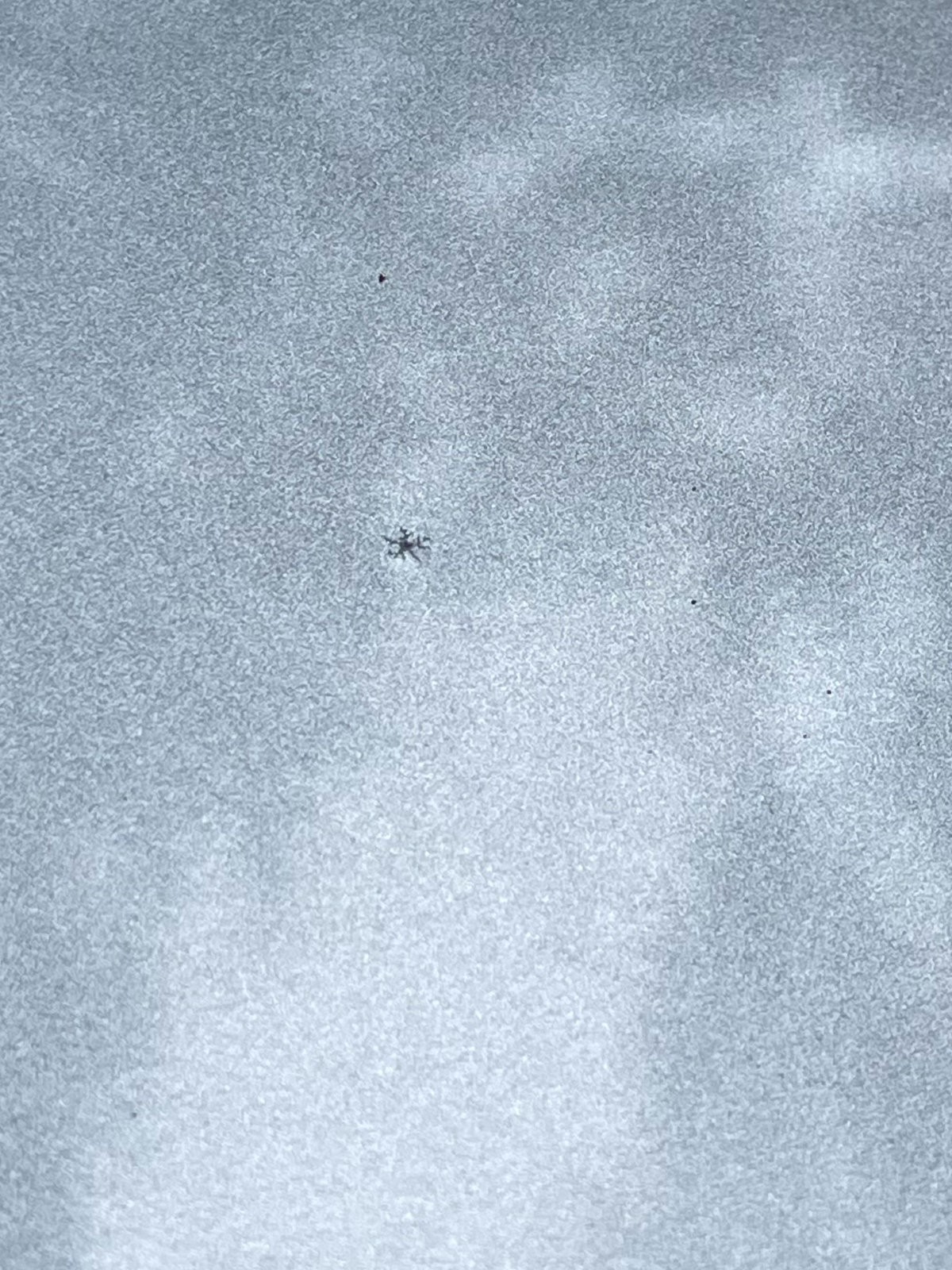

    There are actually several spots. I was just curious if Toyota had paint issues to be honest (I read so many issues with white paint). Never had paint issues on any of our new vehicles. If i created the paint chips, so be it. When I buy a new vehicle with paint chips already "installed", no thanks LOL

    That looks like the beginnings of filiform corrosion. If so, that panel will need to be sanded and repainted, or it will continue to spread. Touch-up paint won't help at all.
