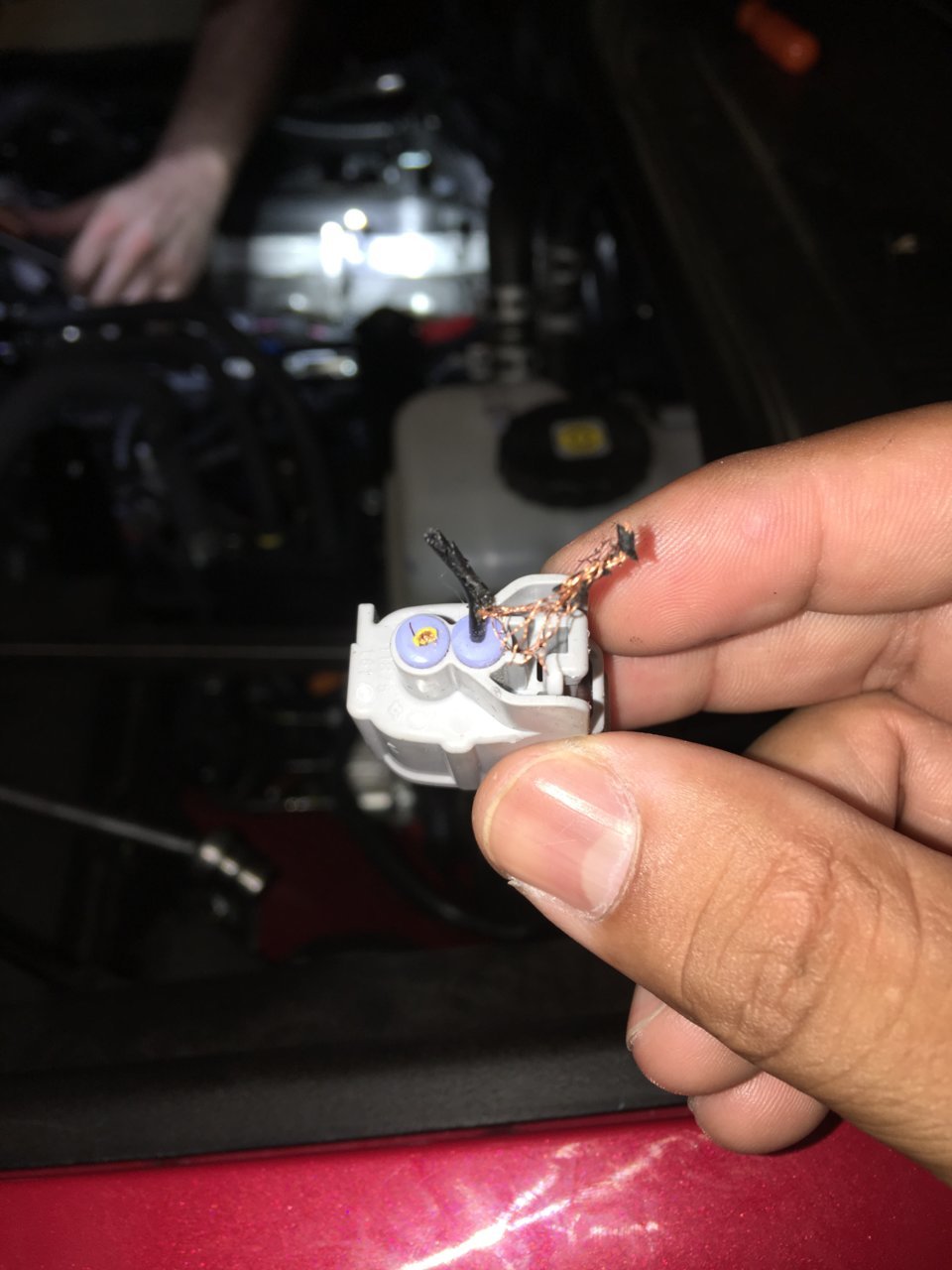

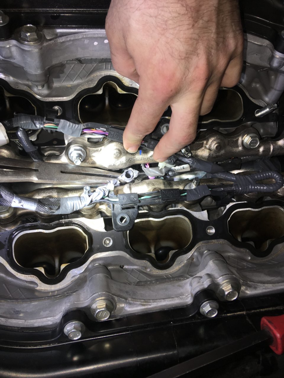

    Baronmutatis
    Baronmutatis [OP] Active Member
    Jul 13, 2018
    #259226
    34
    sanford
    2018 Tacoma Double Cab
    I'll try the cayenne. I think it's because the truck was so new and reeking of fresh plastic inside and out. Bill is $50 parts and $1100 Labor
    the little shits chewed quite a IMG_2791.jpg IMG_2792.jpg bit
    MOC221_ and shakerhood like this.
  14. Aug 1, 2018 at 7:56 PM
    #34
    shakerhood
    shakerhood Well-Known Member
    Aug 9, 2015
    #161370
    37,086
    Southern Ohio
    2017 MGM DCSB Off Road, 6 Speed MT, P&T
    Wow that really sucks to see that damage, my cat just brought me another mouse a couple days ago.
  15. Aug 1, 2018 at 8:00 PM
    #35
    Baronmutatis
    Jul 13, 2018
    #259226
    34
    sanford
    there are several cats prowling the area. the other car in the carport hasn't had a problem. but the truck was fine and four days of being parked later it was immediately not good on startup
    hopefully after a few thousand miles the wires won't "smell" as good to the critters
    shakerhood likes this.
