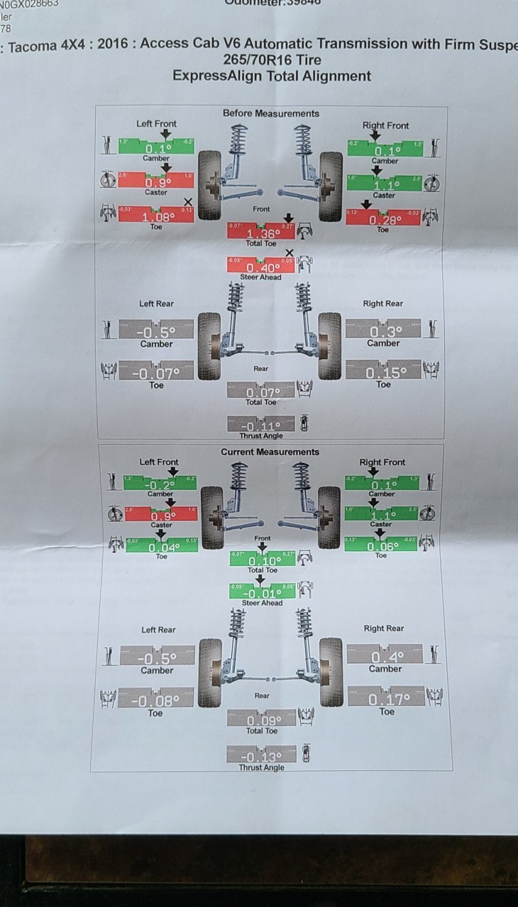

    Alignment issue as well... but mine went to the left (37 miles on mine). Brought it back to the dealership of purchase where they put it on the alignment rack, toe was out a bit, realigned the steering wheel, swapped the front tires from left to right and THEN checked air pressure... rear right was 34.4, front right was 39.7, rear left was 36.5 and front left was 32.9, on a 90 degree day! Reset to 36.0 on all 4, rides like a dream...

    I was told the LCA bolt was seized on the driverside.
    New lift, tires and alignment.
    Truck drives straight. Steering wheel points slightly right. (12:30)
    Doesn't bother me.

    Could likely be the intermediate steering shaft is off 1 spline or whatever you call it. They would need to slide it off, turn steering wheel straight and then put it back on. It's not your alignment.
