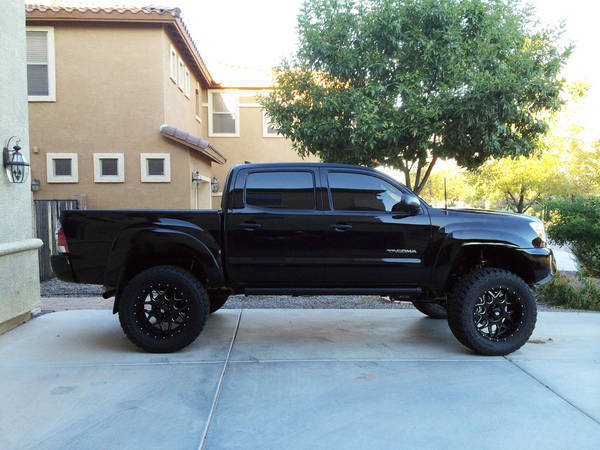

    I'm no super brain about lifted trucks. I purchased my first brand spankin' new 2015 just 1 month ago. 4.0L V6, 35x12.5x20 Mickey Thompson Baja ATZ's. 6 inch ProComp suspension lift.
    What realistic performance gains can I expect by spending the money going to 4:88 gears? Is that the best ratio for the truck? Who's done it and doesn't regret it? What should I expect to pay?

    She'll be in the shop tomorrow. Total cost is $2K to re-gear to 4:88.
    In AZ, I drive up north freqently. Elevation changes go from 1200ft to 9000ft. Sometimes I'm pulling a trailer. I wanted the power of the 4:88 on the tall and frequent climbs up through the mountains. This is why I chose the 4:88 as opposed to the 4:56.
    Any last minute words of advice?
