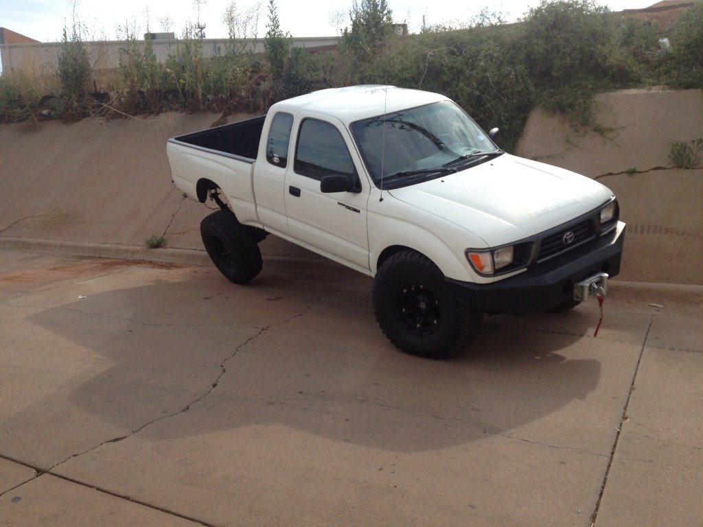

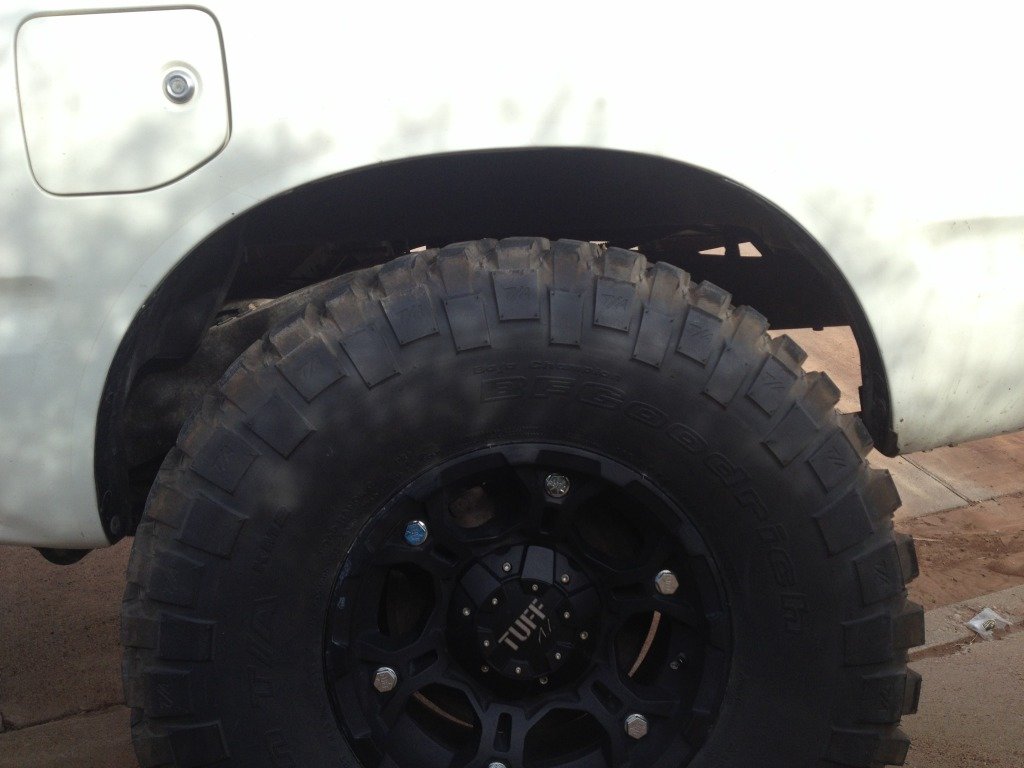

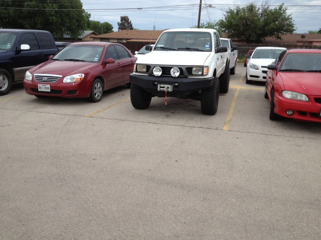

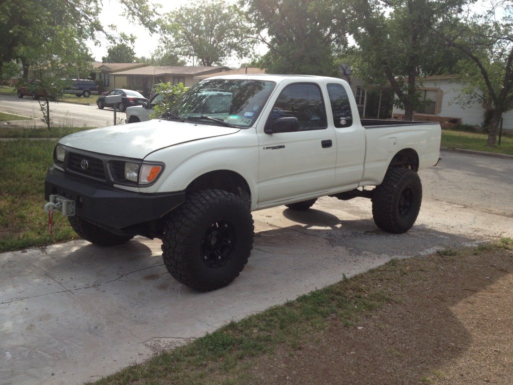

    Gave it a bath, and finally got the rest of the adhesive off from that black stripe. I think it looks alot cleaner without it.

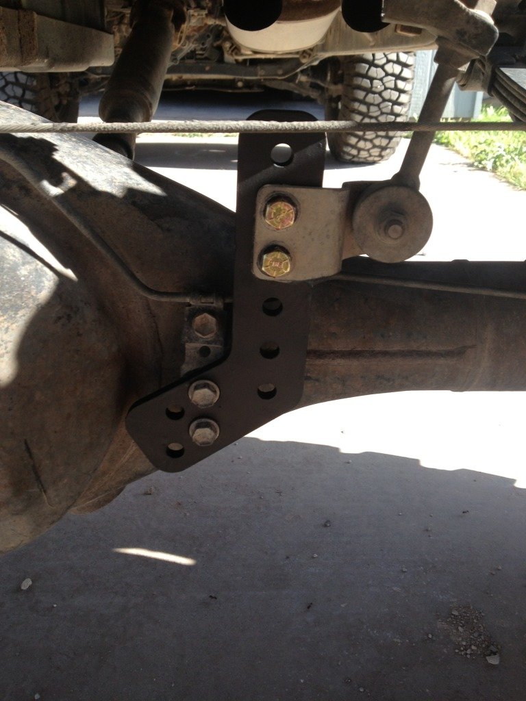

    I think im gonna need some axle relocation plates. My tire is sitting about 3/4" back in the wheel well.

    Axle relocation plates seem to be the latest rage. I'm wondering why I don't have a rubbing problem in the rear when stuffed.
    Nice truck too, love the early 1st gens.

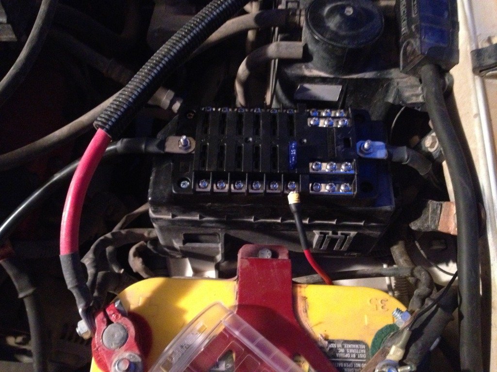

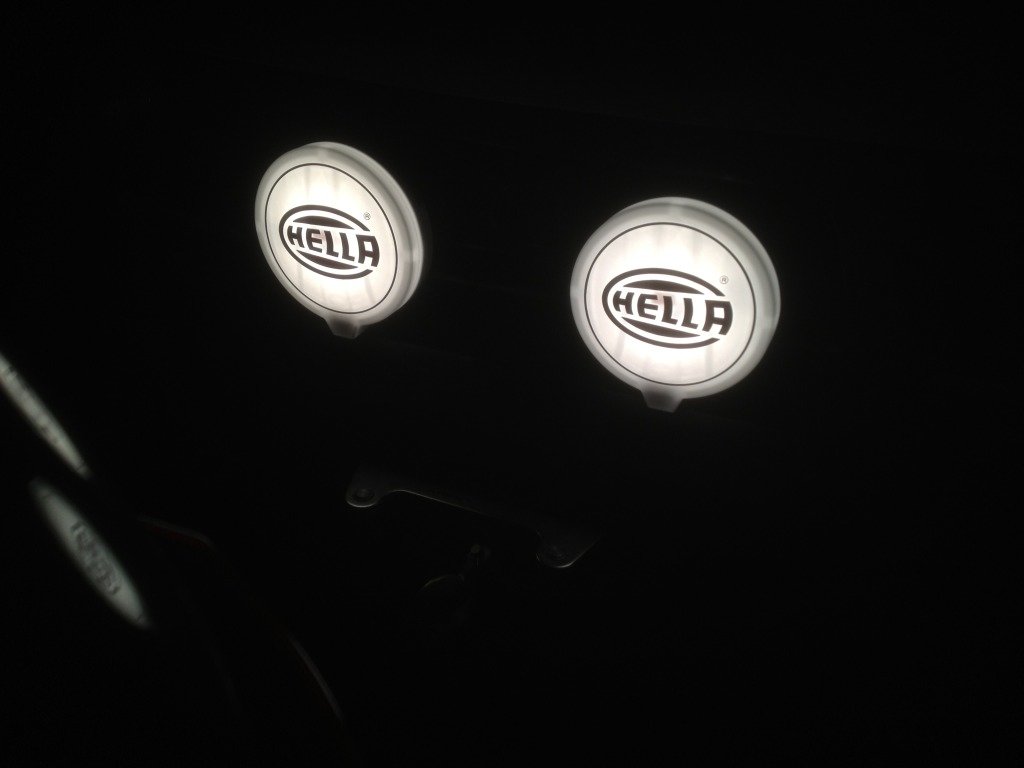

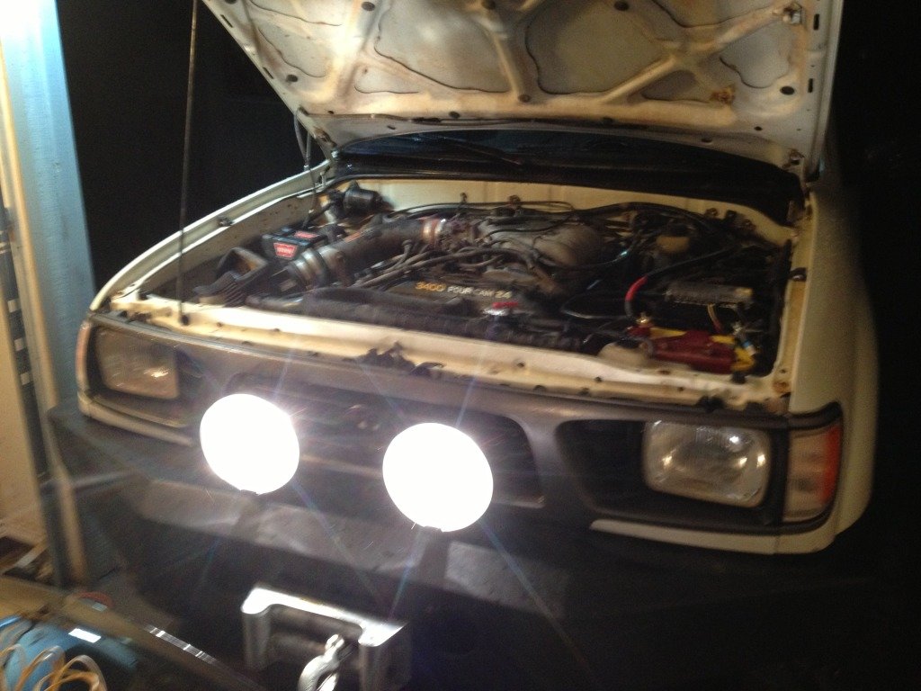

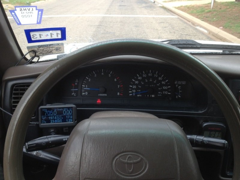

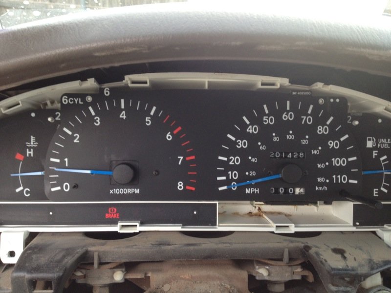

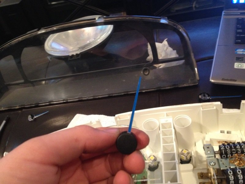

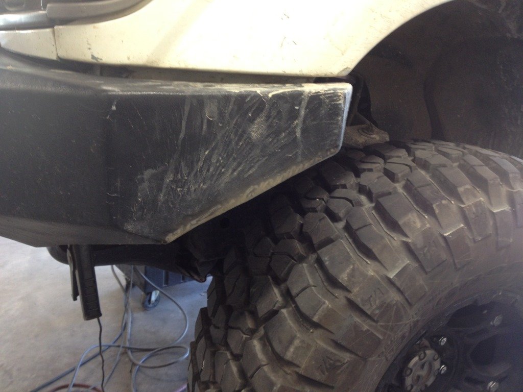

    Well ive been busy with some mods:
    Trimmed my bumper a bit since i had some slight rubbing
    Installed a BAMF BPV bracket
    Installed a blue sea fuse block
    Installed some Hella 700FFs

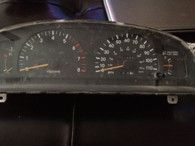

    Took apart my guage cluster and painted my needles blue, also put leds behind the dash

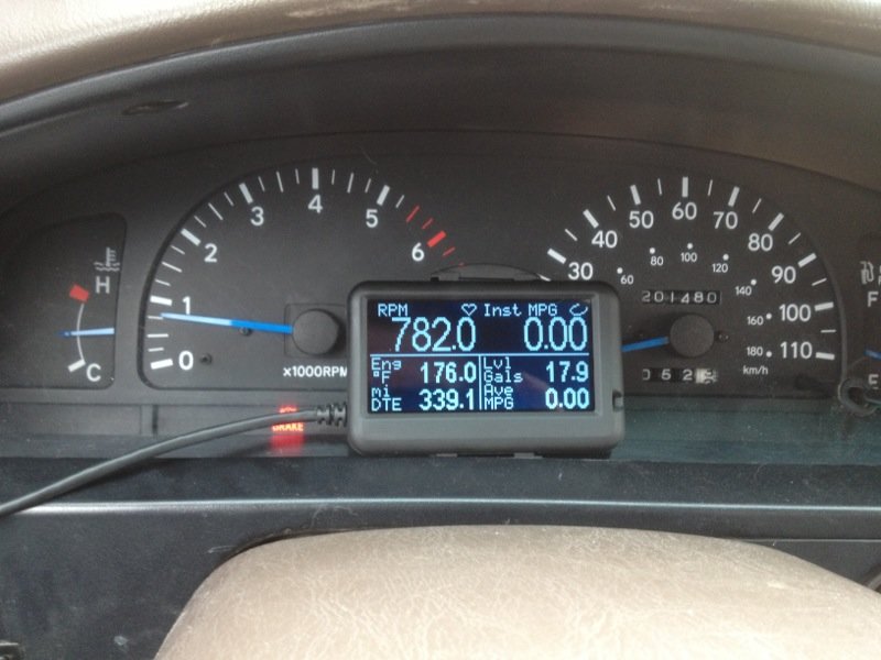

    Also installed an ultra gauge i got in a group buy
    Also ordered some BAMF sliders!!!! :woot: :yay:

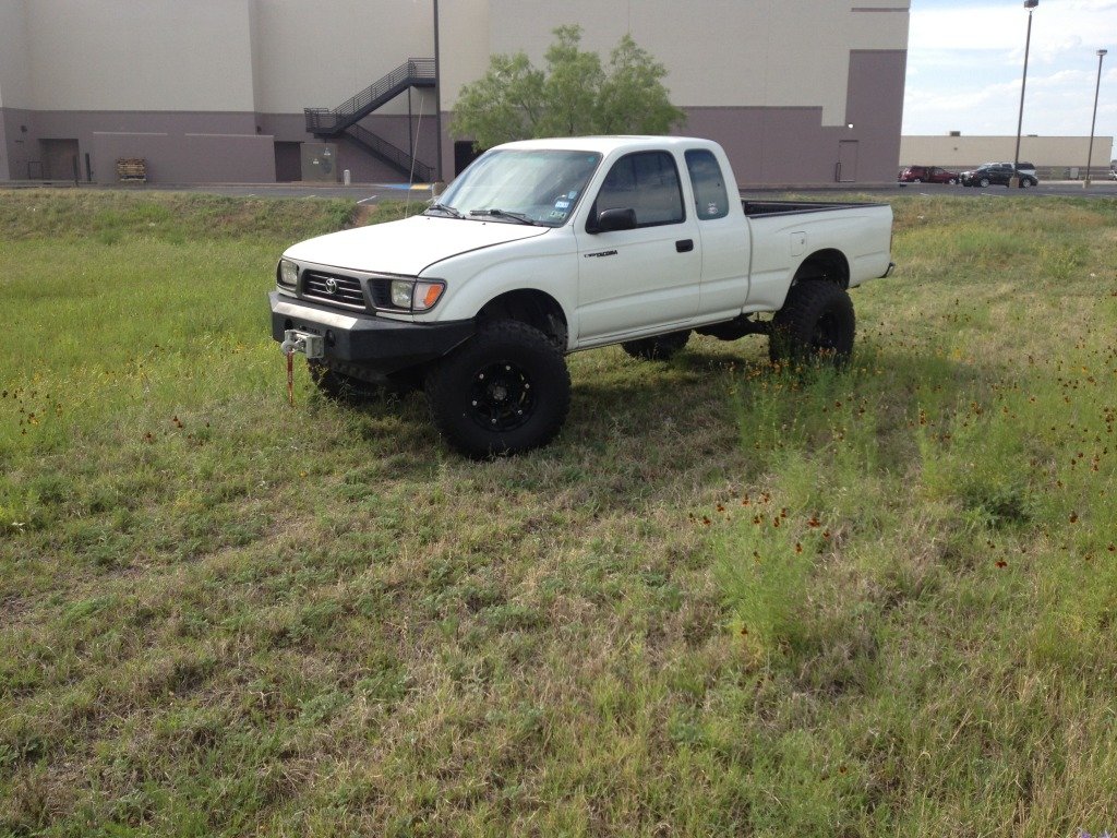

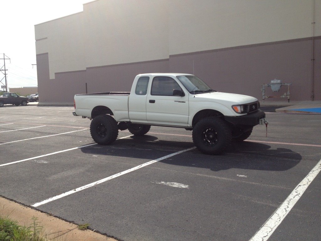

    Awesome truck! Id love to upgrade to 33's. Got a few questions. About how much lift are you running up front? How do the tires fit? Any trimming? Do you feel a loss in power? Do you think a regear would be necessary? Thanks!

    Thanks man! I think I'm at about 3 inches up front with the bumper and winch and all. My wheels have 3.59" backspacing and I think they fit perfect. I don't have any frame rubbing and I just beat my pinch weld back to stop the rest of the rubbing. I still need to flex it out a little more to make sure im not rubbing more. If you've already trimmed for 32's then you shouldn't have to worry about too much more cutting.
    As for the power loss I've found it to be negligible. It doesn't feel much different then 31s at all and I've only lost about 1.5-2 MPG. With weight in the bed it is a little more noticeable but not bad at all. I think a re-gear for 33's is a waste of money. When I step up to 35's then I think a re-gear will definitely be necessary.
