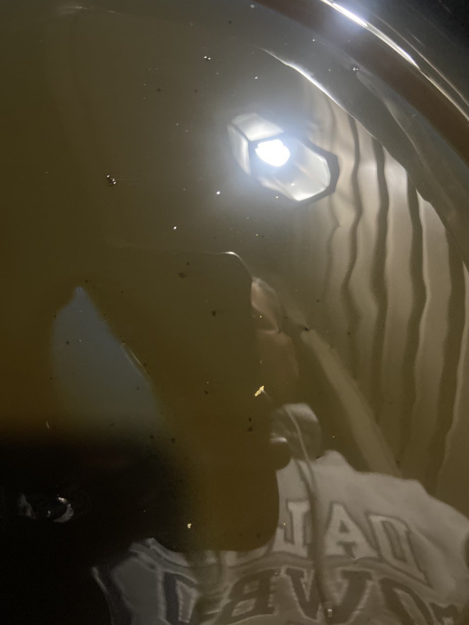

    upload_2022-1-17_11-52-38.jpgOil filter was glittery
  12. Jan 17, 2022 at 9:00 AM
    PhoS
    PhoS Proffauxssional
    Apr 8, 2020
    #324146
    1,311
    PNW
    08 FJ Cruiser
    Contains MSG
    Color makes me think more wrist pin. Do the short block, get the heads refurbed g2g?
