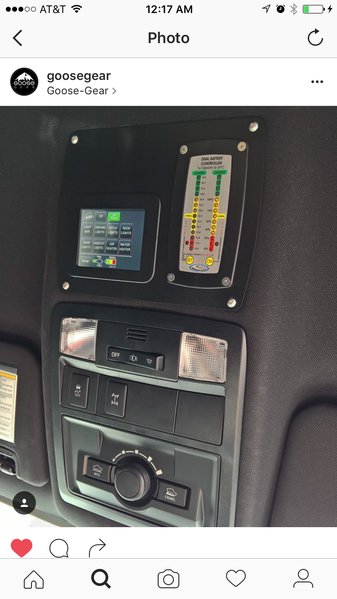

    Any details or information on the install of your SPod and Luna controller?

    I can tell you a few things... to completely remove the headliner in the 3rd gems you have to remove the windshield. Don't cut within an inch of the Mts controls on the roof. All the wiring is run down the a post. I don't have a pics of that portion of the build though.
