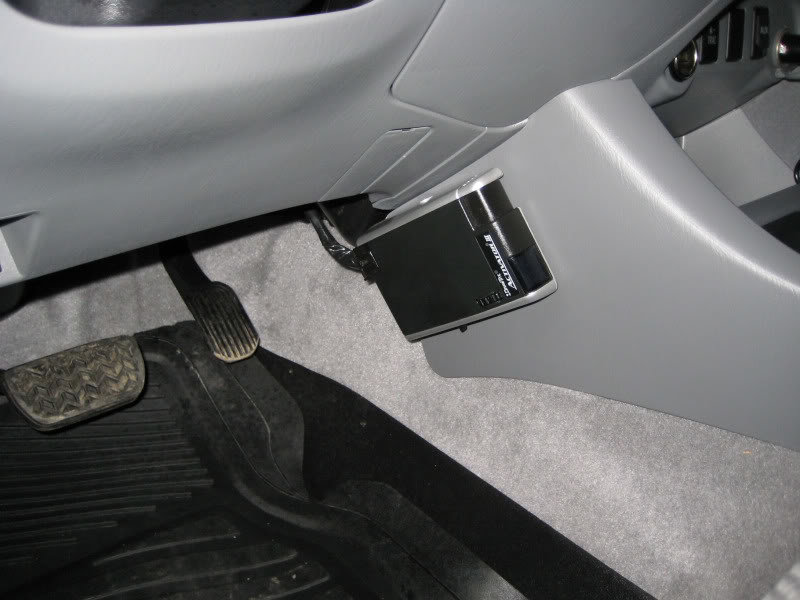

    Mine is mounted on the LHS below the tip out cubby, fits nice in there. I do give it the boot from time to time but no biggie all is well. The cubby still opens fine too.

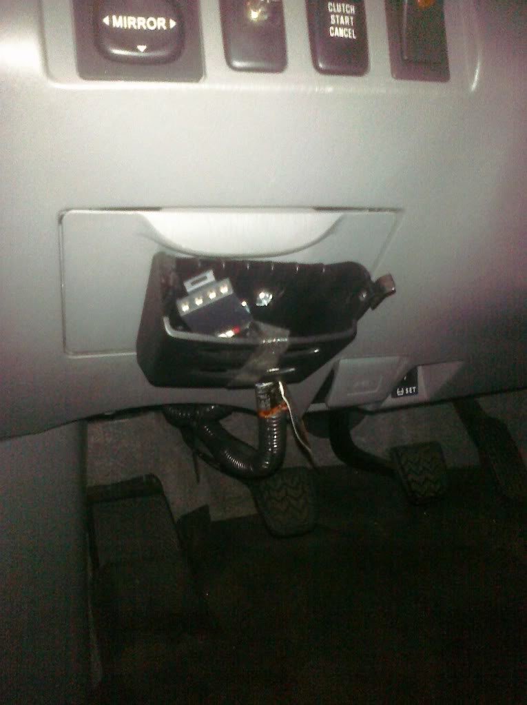

    I put the bracket/holder on the coin cubby. I keep the actual brake controller stored in my TT and only put it on when I use it. I keep the wires nice and neat with velcro attaching it to the bracket. I'll get a pic up in a bit

    Thanks for the suggestions. Install was mostly plug and play like some mentioned. Ended up mounting the ground to an existing M8 bolt that attaches the break assembly to the firewall. I picked up an M8 nut to sandwich ring connector on to the existing nut (had to cut connector in half to fit on M8 bolt). I also ended up mounting my break controller on the coin tray with the metal bracket. This way...when I'm not towing, I have the option of just pulling the entire coin tray. I guess eventually this may be handy if I'm trying to get full value for trade-in...just replace coin tray and console looks new.

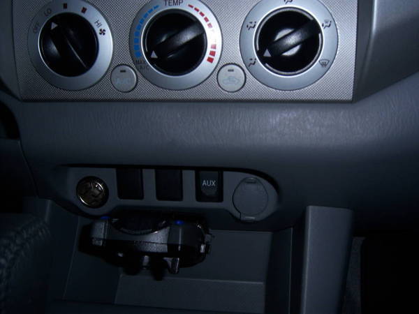

    I mounted mine just to the left of the small cover in the pic with the back of the controller even with the lower edge. At first it looked like it would get in the way and may get the occasional "boot" but so far it has worked nicely.
    I kept the wires together with wire ties and they are invisible in this location.
    I also used a Prodigy P2 which was a plug and play installation (once I found the damn pigtail!)
