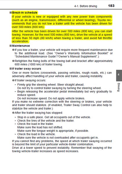

    The owners manual (who knows better than the truck's designers) says not to tow for the first 500 miles. For the first 1000 miles don't go at extremely high speed, avoid sudden acceleration, no continuous use of low gears, and no constant speed for extended periods.

    But, if you have time for doing the breaking period 500 miles, I would recommend you to follow the instructions of the user manual :

    Safest answer is to follow Toyota's recommendations posted above, per the user manual. Everything thing else is anecdotal and unsupported or mildly-evidenced speculation.

    I was looking at page 156 under breaking in your new Tacoma. Its nice to see more useful information from the manual about towing.
