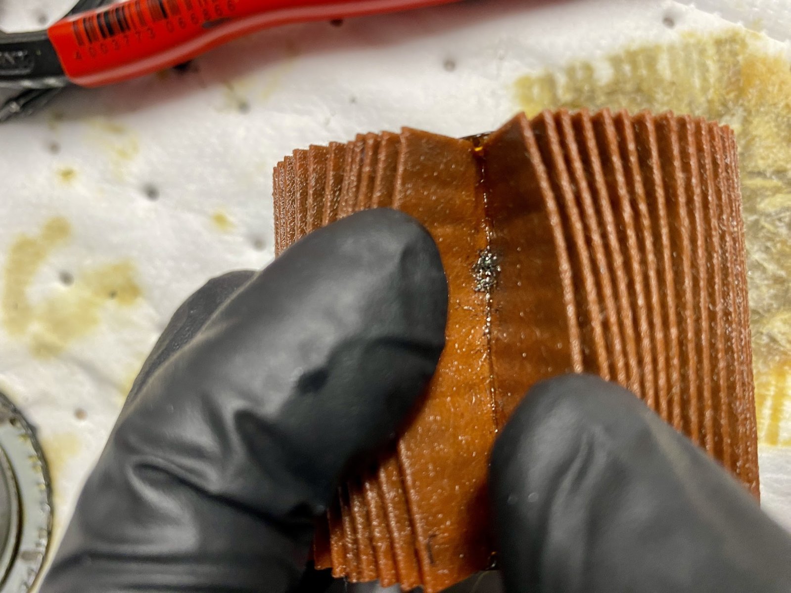

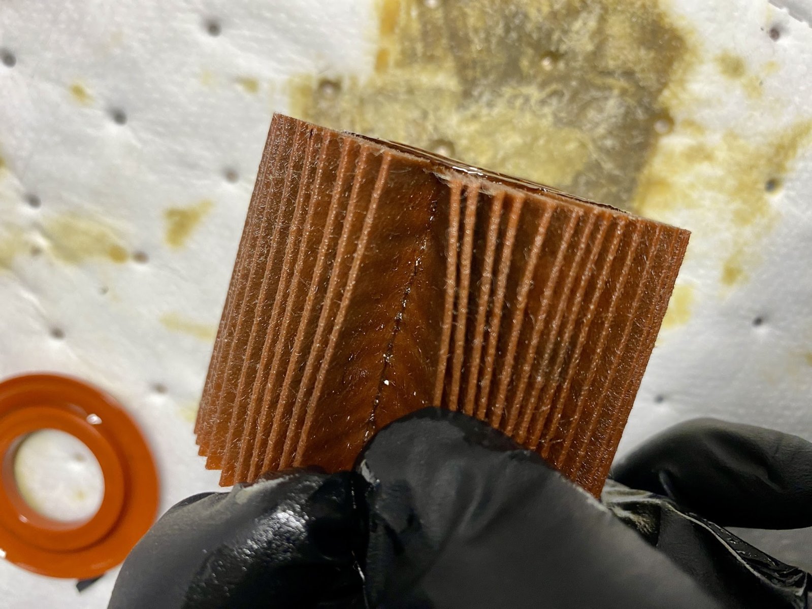

    Just under 1000 miles on the truck. Pulled apart the factory filter, which is a beautifully crafted, made in Japan Denso. Part number 90915-10009. I would recommend this filter. It was truly precision beauty inside and out. Replaced it with the made in Thailand one 90915-YZZN1. I will by buying the -10009 in the future if I can find it.
    Look at the gunk in the pleats. Toyota says I can run this oil 10,000 miles on a first fill? I don't think so.
    Lots of RTV looking bits, and some shiny specs of metal. Yes the filter did its job. But I don't want this crap in the engine. The (clean and new) drain bucket had lot of specs of RTV in it, and one silver metal shaving. There's maybe 50 pleats, and I picked through most of them. One coppery looking fleck, and some tiny metal flecks in them.
    Filter looks like it could have gone for a lot longer. The pleats were in great condition, no signs of being overloaded. I just wanted to cut it open and see. Plus pulling the filter releases some suction which lets another 200-300ml drain out of the engine and there's about a 250ml in the oil cooler and filter too. I really don't like the idea of little globs of goo in those cooler passages.

    Looked the same when I did the 5k oil changes on my 3rd gens. Completely normal and the filter did it's job.
    Edit: Normal for first oil change

    I'm curious, what did you use to dismantle the oil filter?
  7. Aug 7, 2024 at 8:41 AM
    Vitamins
    Vitamins [OP] Well-Known Member
    May 7, 2024
    #449358
    731
    2024 TRD OR
    A knipex mini bolt cutter. It was the strongest thing I had that didn't produce a bunch of spurious metal shavings. I cut at the crimp near the silver plate with holes in it and then drained the excess oil and slid the fliter out.

    I am all about doing oil changes early, especially on a vehicle I plan to keep for the long haul. I did my first oil change on my 21 around 1000 miles as well and found similar break-in glitter as your 2nd and 3rd photos, but none during my 5k and 10k mile changes. I'm running the TRD filters on mine (bought in bulk when I first got the truck), but I believe they are discontinued now for the 3g.

    This seems exceptionally common and TBH not particularly surprising. There's a few videos from the 4Runner forums on first-fill OCs with similar bits of engine crud.
    Here's one I found from a 1500 mile oil change. Skip to 4:00.
    First break in oil change on the 2023 TRD Pro 4runner. (youtube.com)
    Of course every 2022+ Tundra owner on the forums is changing oil and looking through it like a miner panning for gold.
