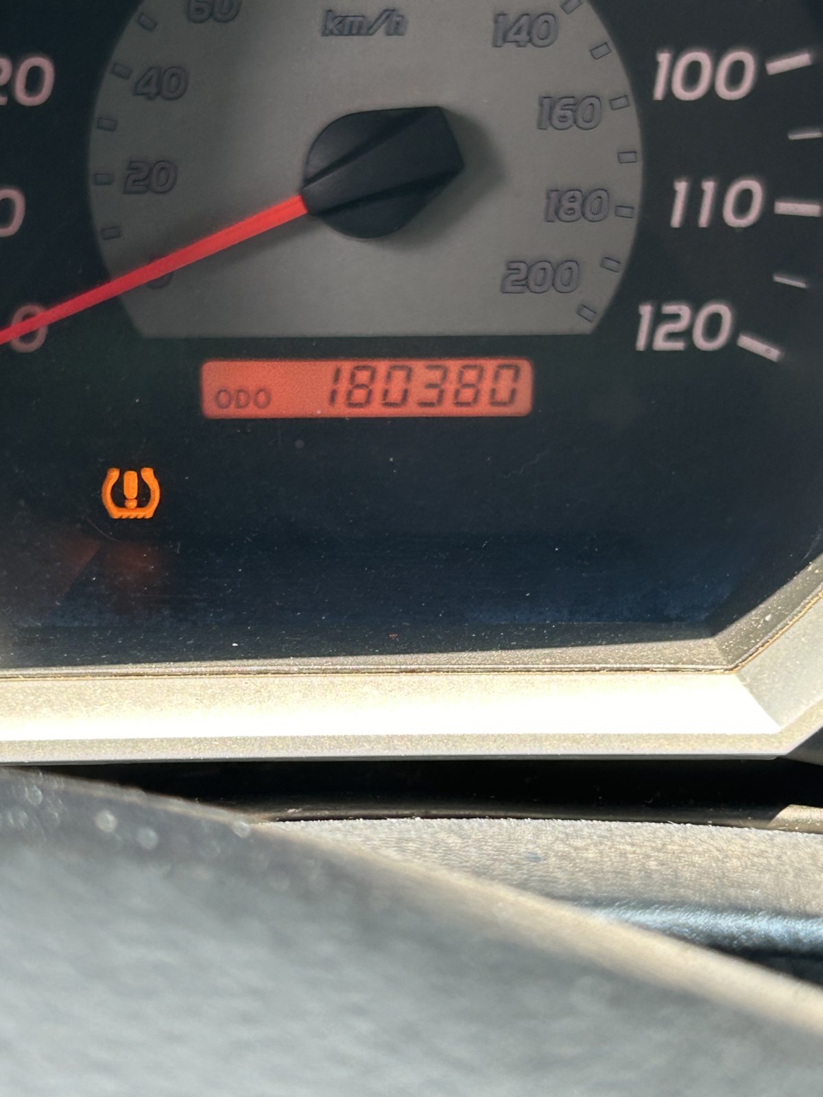

    If only you gave your tires the same love

    I haven’t had the tpms installed for 10 years.

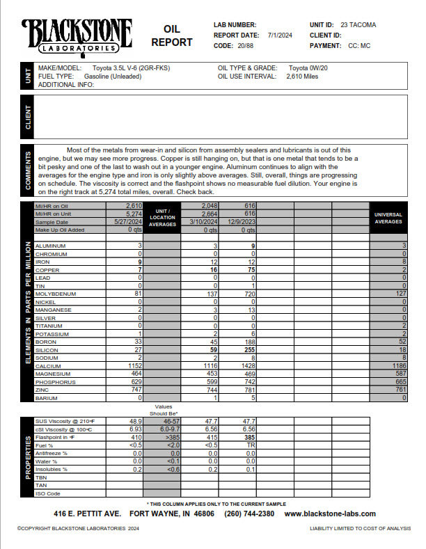

    I have changed my 2023 Taco oil at 616, 2664, and 5274 miles (so far) and sent samples to Blackstone each time. See attached.

    I’d keep an eye on the oil change interval, especially with what you found. And that funnel tip is gold; I wish I’d known about those sooner too.

    Seems stable - so maybe the first one wasn’t needed ?
    edit - oops read it backwards! You did need it !
