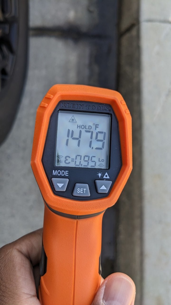

    On my way to pick up my new truck I took a temperature reading on rear diff of the 2020 SR5 and got 147 deg F. This is immediately after 2-1/2 hours of 75-80mph driving. It was 9am so about 75 deg F.

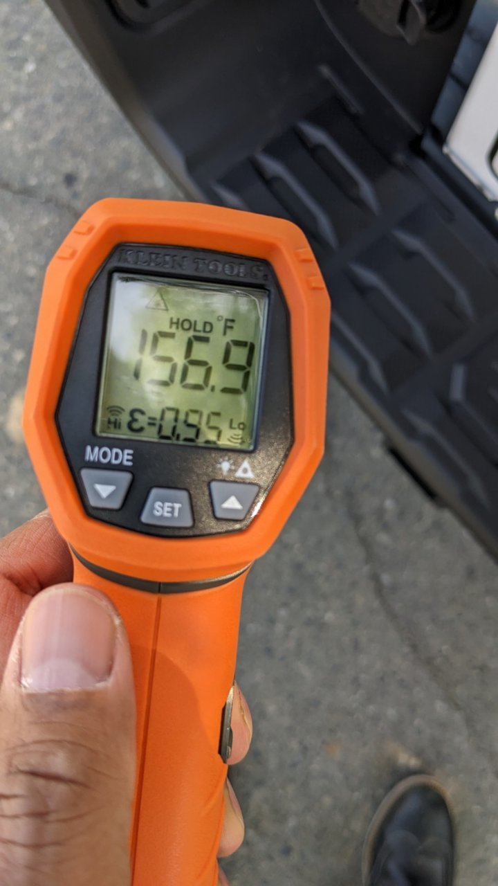

    The new truck had 4 miles on it and with very gentle street driving up to about 13 miles I pulled over and got 156 deg F. Not bad...but definitely warmer than the old truck.

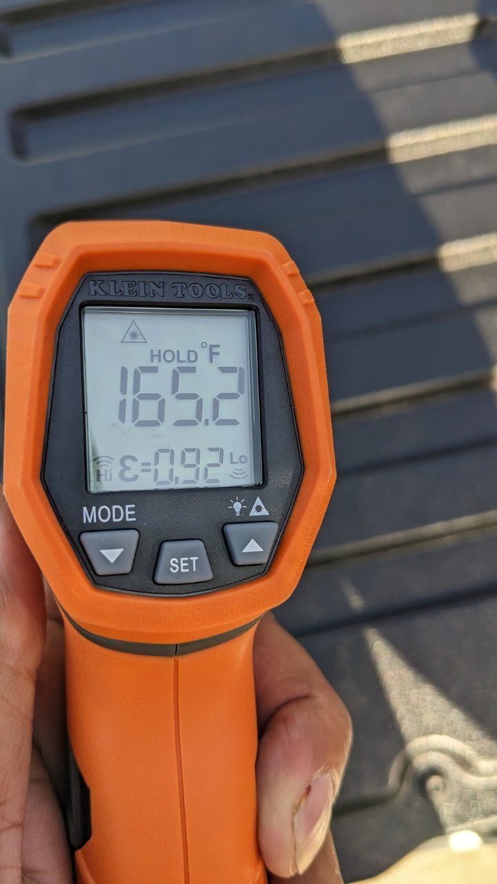

    I grabbed lunch and 30 minutes later the temp went down to 115 deg. F and I drove for another 10 miles of easy street driving and got 165 deg F.

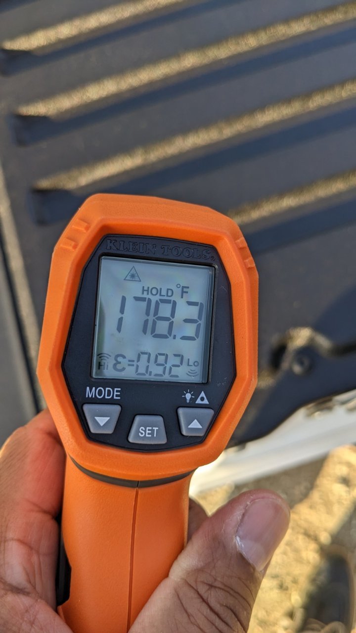

    I hit the Grapevine (hilly section of the 5 fwy before dropping into the LA area) and took a reading at the top of the hill and got 178 deg F at the diff (ambient temp: 72 deg @ 7pm). At this point it was clear that this thing didn't need to be coddled and I just kept the speed below 70mph the rest of the way. It was 90 deg F in Clovis so the in-town reading were elevated but not much to be concerned about. It's likely if I pushed 80mph right off the dealer lot, I could have eclipsed 200 deg F...but I don't want to find out.

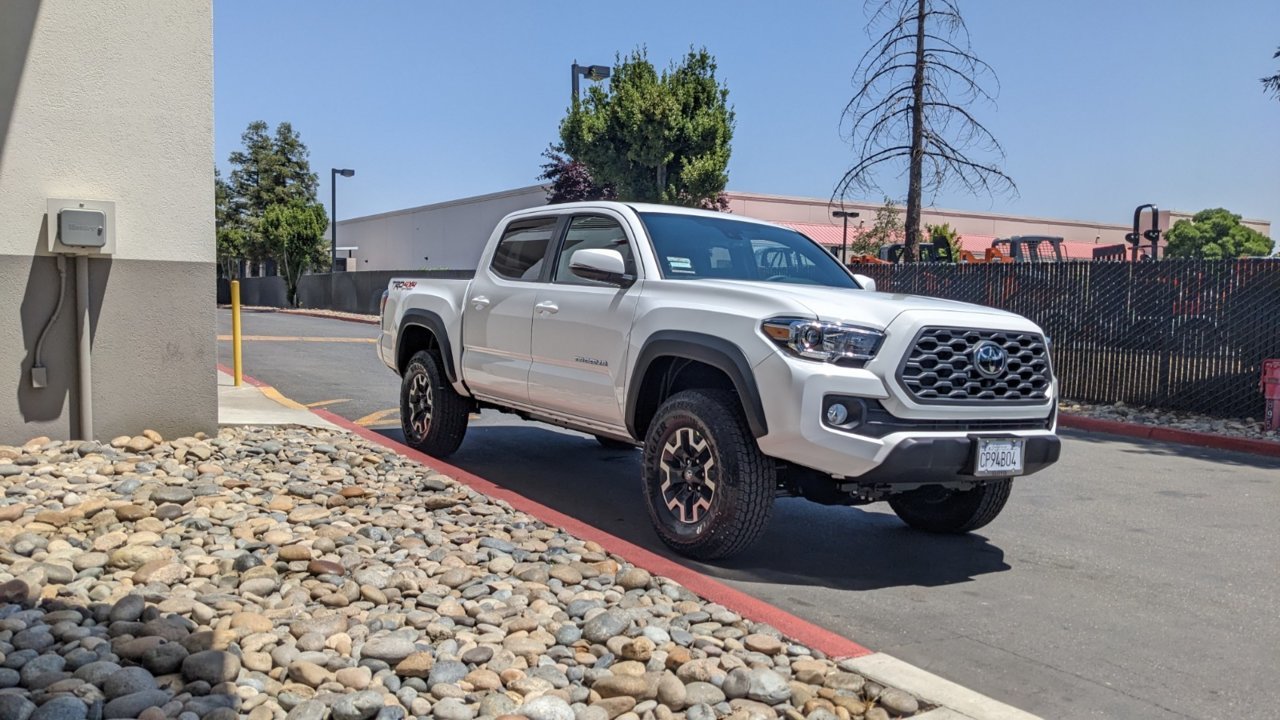

    Here she is...manual trans off road. I was able to get her at $100 off MSRP by going to Toyota of Clovis...a volume dealer (Penske group). I've looked at the 2024 model very seriously and I really like the cleaner, more stately lines of the 3rd gen. I do think it's the best looking truck (big or small) on the current market. I mean, look at it! ;)

    Incidentally, taking a temperature measurement (pyrometer) at the back of the differential cover is about 7 degrees cooler than at the pinion side. So the numbers I was posting were a little low…so diff was getting pretty hot right off the bat.
