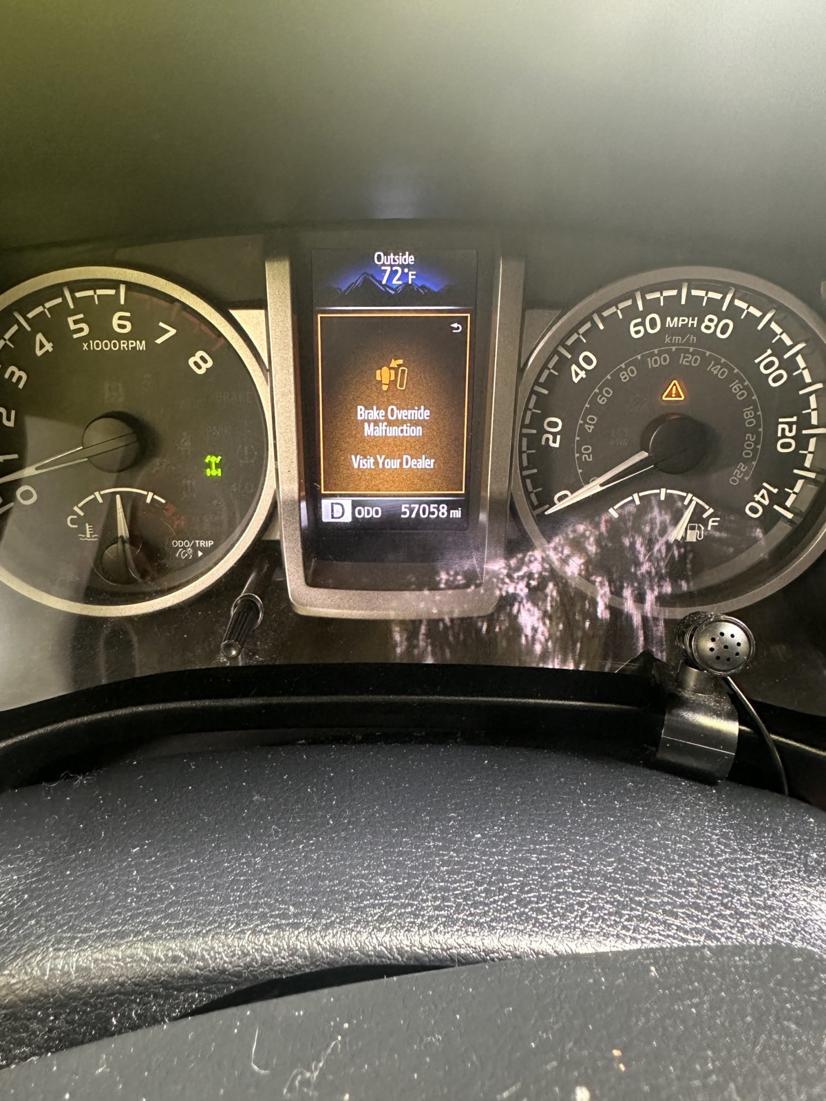

    So I went to put my truck into 4 High today and my truck pulled a code saying “break override malfunction”. Then I threw it in park and noticed I couldn’t shift out of park. I found the fuse was blown. Well I replaced the 10 amp fuse with another 10amp spare (I didn’t check to see if it was blown either (yes I know I should’ve)). I really don’t know if it was blown too before putting it in there. Then I put a 15th fuse in. It definitely wasn’t blown. It blew instantly. Then I put a 30amp fuse in there and that got it to the house. Anyone else have this problem and does anyone else know what I need to do from here?

    Also I threw it in park and turned it off right after this picture was taken

    It's a very bad idea to replace a fuse with a higher amp rating! The fuse is there to protect the circuit from overload, and a higher amp rated fuse will no longer protect the circuit within it's designed amp rating.
    The starting point is to find the short, don't just keep replacing blown fuses.
    Any other electrical repairs or modifications? If so, start there first.
    It is hard to see in your signature pic, but is that aftermarket bumper near or covering the front grill sensor? That should be checked too.
    Have you done any water crossings? You could have dunked the actuator and shorted it.

    I didn’t have anything else on hand to get it up the driveway. I drove maybe two minutes or less up to the house. I haven’t had any electrical problems before so I haven’t had to repair anything, but last week I did have to change my backup lights from my old led’s to new ones. I did that last Thursday. And also I did get a replacement for my Sony 9500es plug and play. I installed that Sunday

    Two minutes or two seconds - if the current is high enough to blow the rated fuse, it may very well fry electronic modules the instant you install the higher rated fuse. You may have got lucky in your particular case, but I would highly recommend NOT trying that again...

    If it had a 10 amp, and it blew a 15amp, you are lucky as hell that you got away with driving it on 30 amp.
    Dont push your luck, tow if you need to.

    No I do not, but I did in fact find the culprit. My driver side tail light was full of water from the car wash I went through before headed home. I just ordered factory tail lights. It is up back and running with a new 10 amp fuse in it. I drove it 20 minutes down the road
