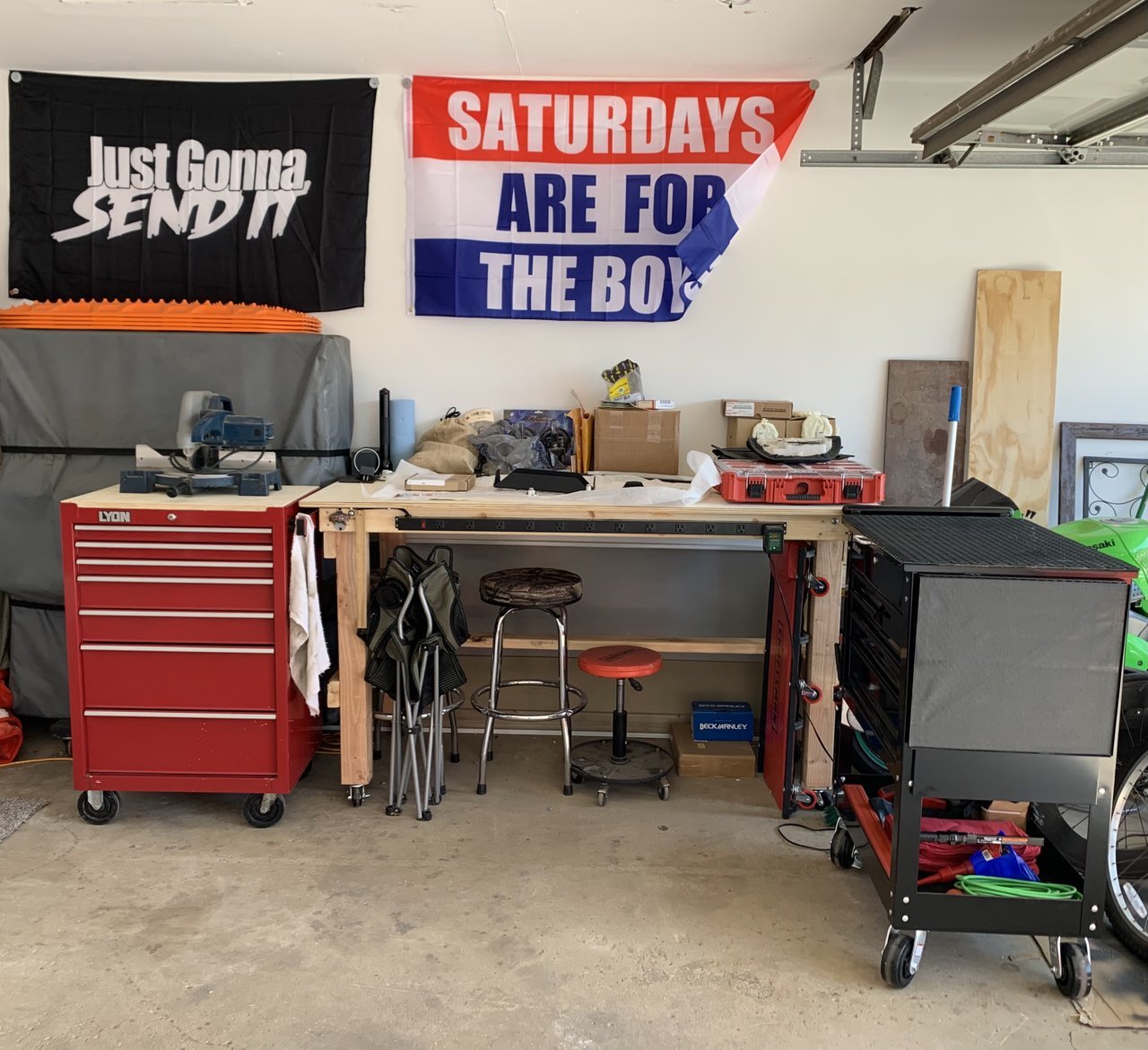

    That and the knowledge is pretty cool too..
    Helped a buddy last night put in a set of coilovers
