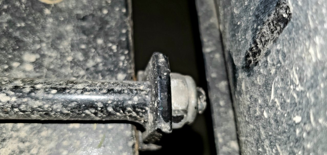

    Thanks to @SearArtist for the heads up on the flip-flop bracket bolt alignment on the Dobinsons L59-111-R due to the excess threads rubbing/scoring the side of the gas tank.
    Mine is barely showing contact...but now to fix it.

    Just checked, and mine is a little close, but I haven't gone full stuff yet... Are you going to remove and flip the nut to the other side?

    Yep flipping it, of course that's where I've relocated the e brake line bracket, so just gotta lift up the rear or get on the 2pt lift (gotta grease UCA ball joints at inlaws this week/wkend since I left the moly Grease there).20200915_193530.jpg

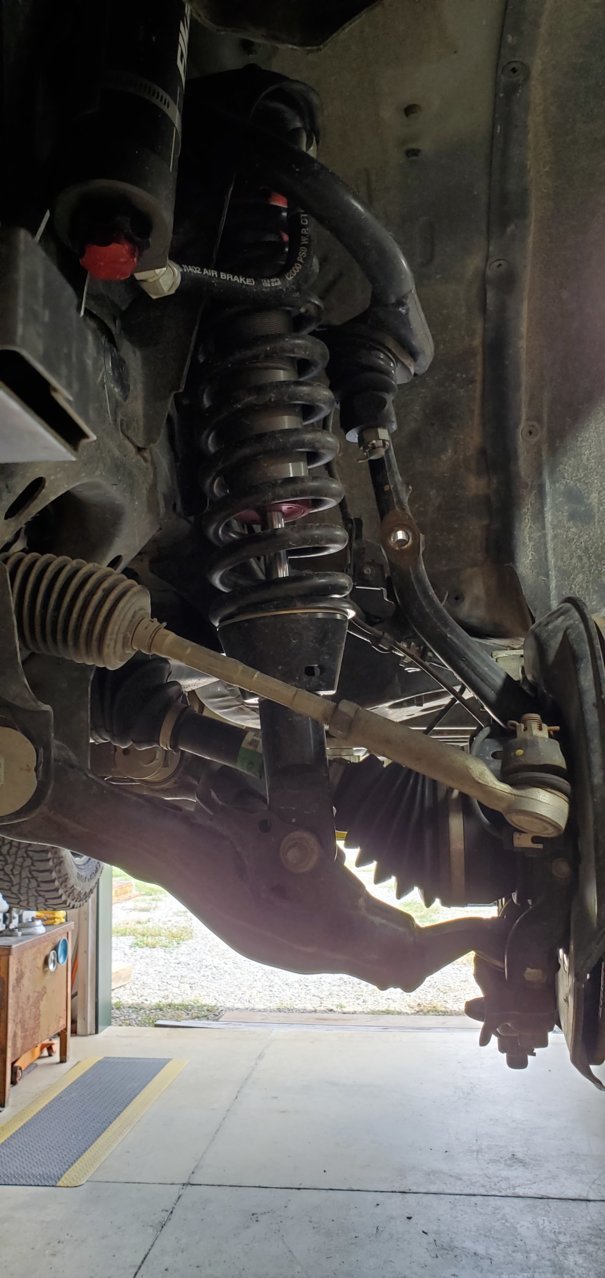

    Went to the in-law's today, collectively (when I needed two hands!) Got the a good amount of work done on the truck with the help of my wife and FiL when two hands were needed.
    Front Diff Drop Delete, Sway Bar Delete, and upgraded engine bay splash guards, greased the SPC ball joints and cheaped out by going with added electrical tape on oem fog wiring post harness into connector.
