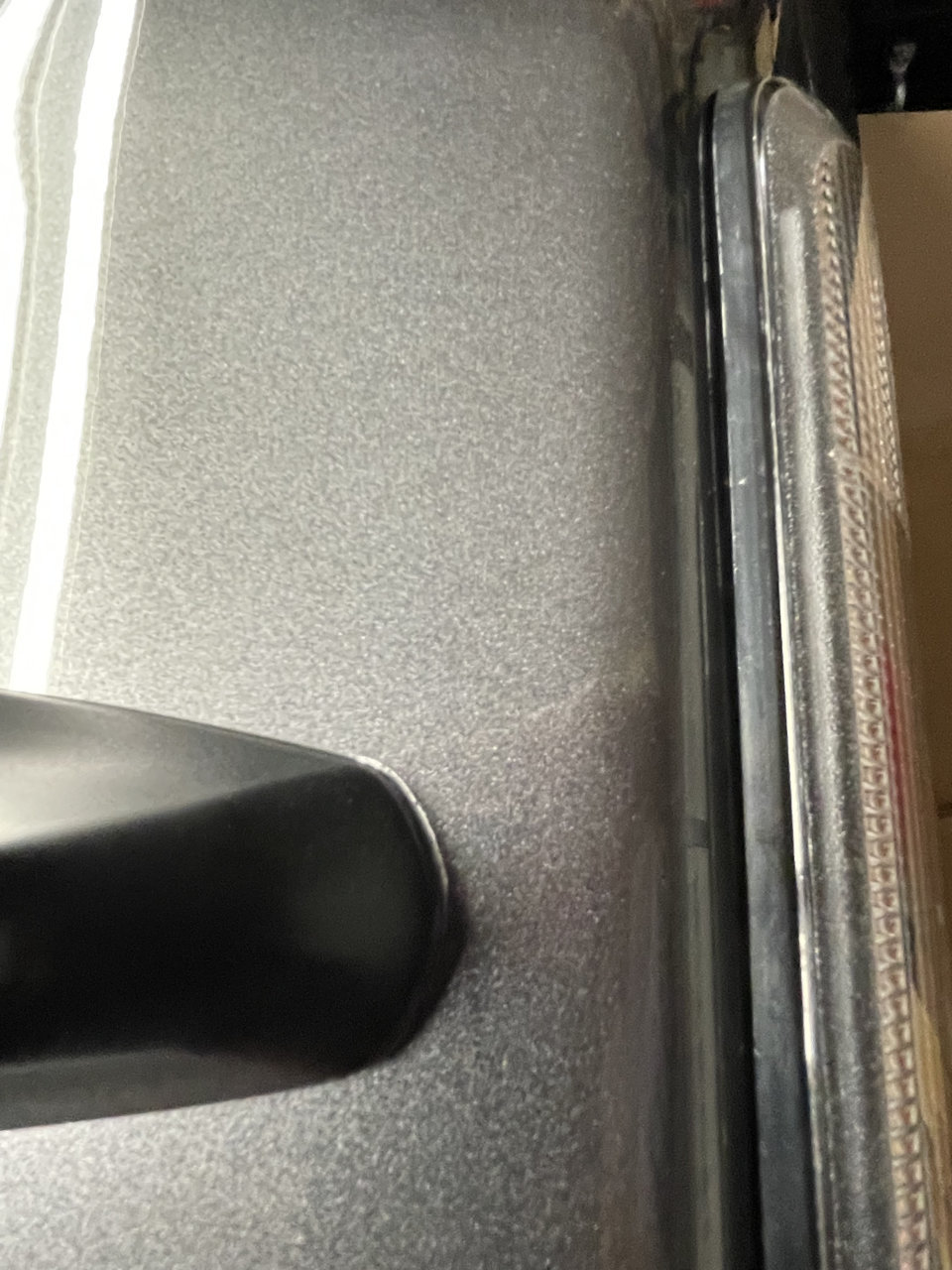

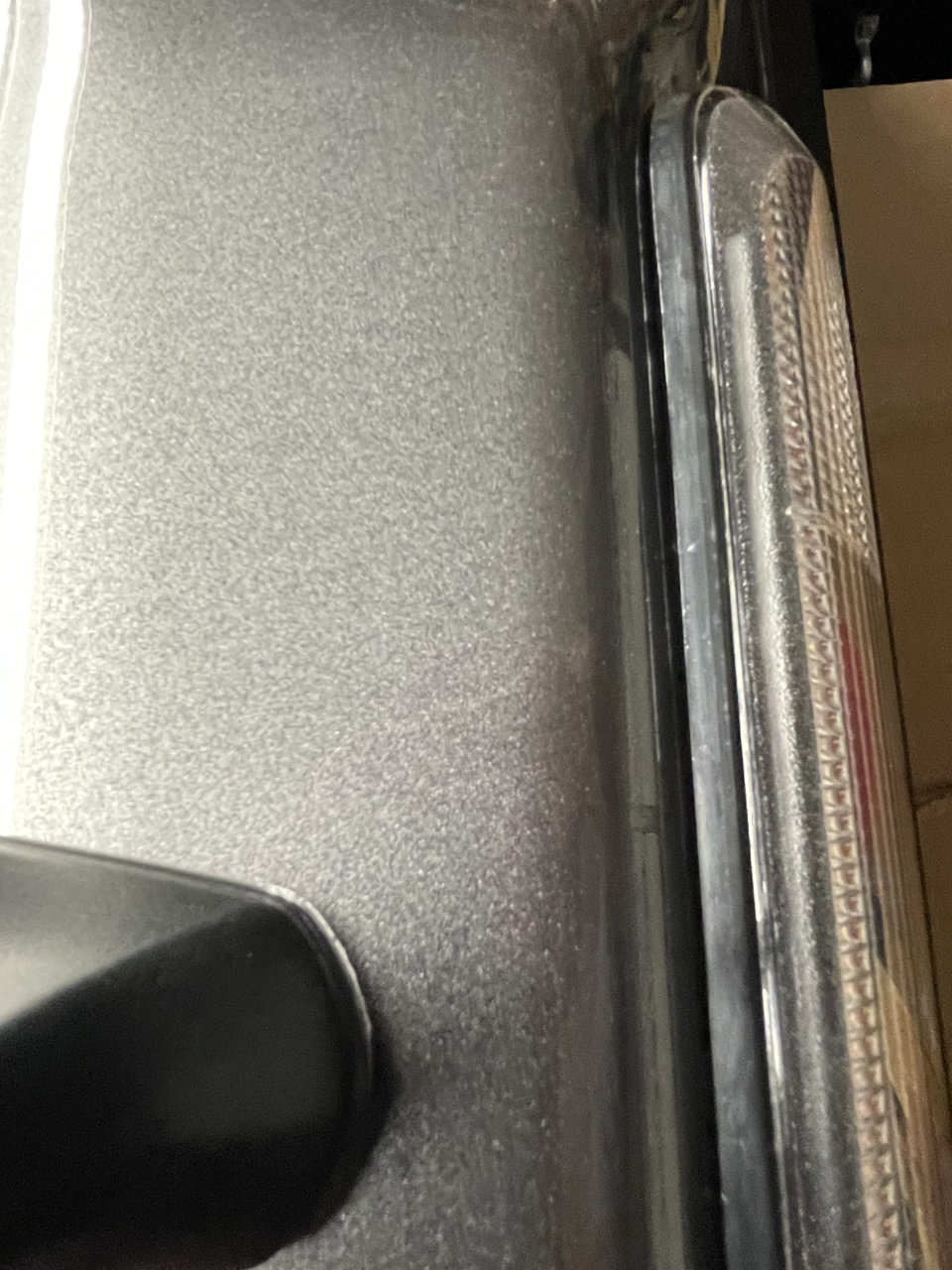

    Looks like the seal on mine has pulled away from the cab. Anyone else have the same issue?

    Mine had no leaks prior to this and I had it done anyway. They advised me not to take it to a car wash for 24 hours after the procedure was completed so they definitely used a sealer in there. They advised that the old seal was going to fail over time even though mine hadn't (yet). So far so good.

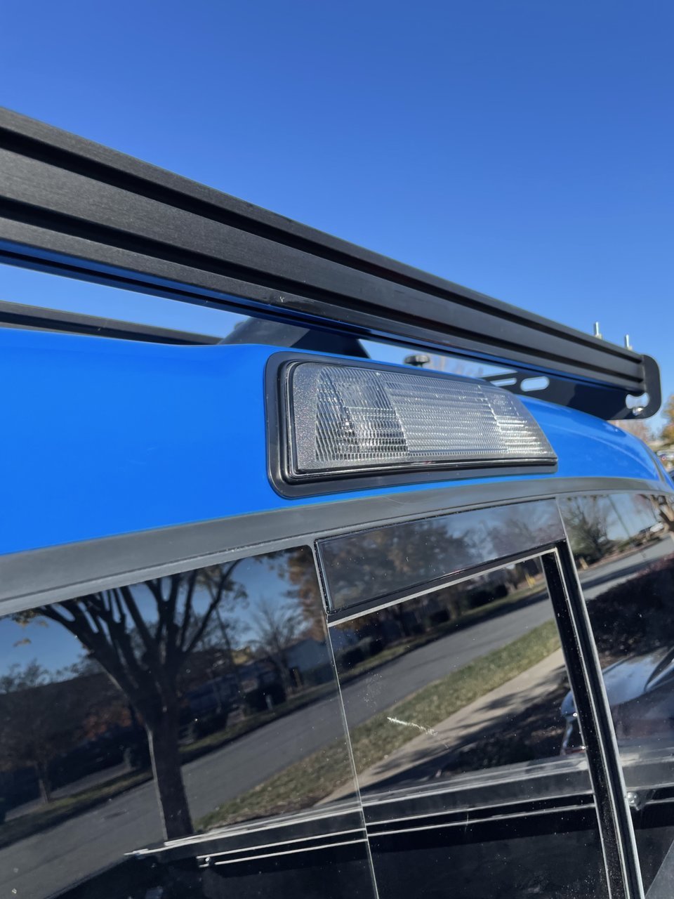

    2019 Tacoma TRD Pro-Voodoo Blue
    Def a different design
