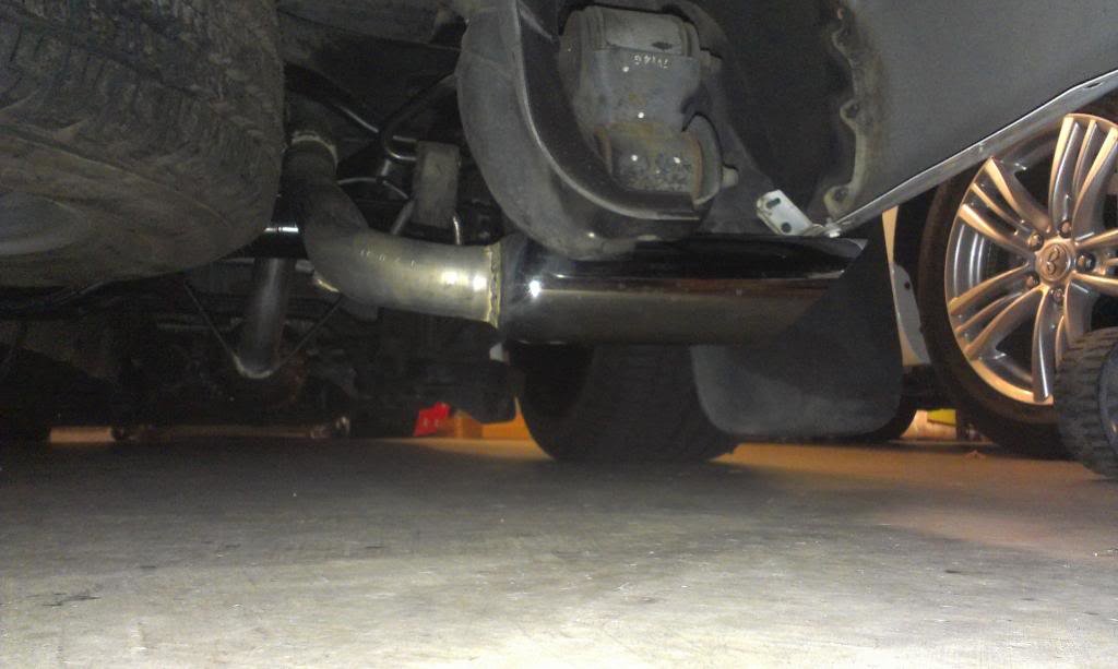

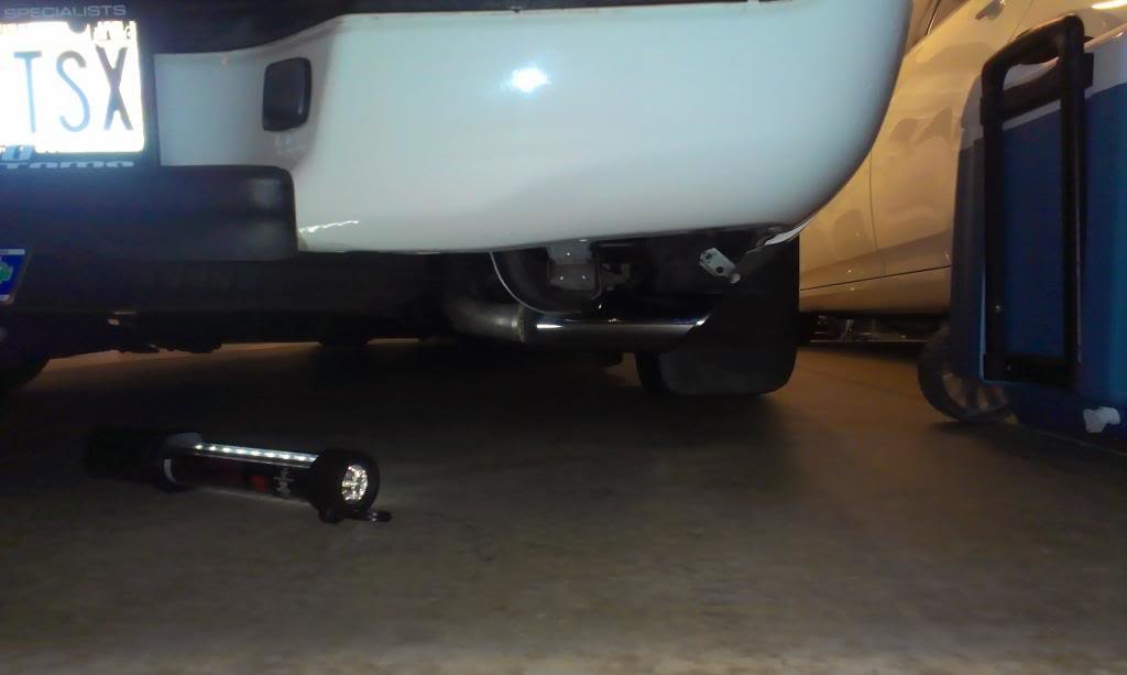

    Newest mod got rid of the turn down pipe and had the exhaust routed to the rear being dumped before the axle and dropped was not a good combo for me way too mucj drone and didn't sound how I liked it too the piping isn't mendral but o well I'm much happier with the interior noise and the sound outside is raunchy louder than dual 44s and deep can't wait for lce headers for a bit.more pep and better sound throughout the rpm band
    It's 2 1/2" piping to a 3 1/2" x 12" angle cut tip
    Will be painting the piping black and the shackles and leafs it is still the aero turbine 2525 non resonated with both cats and stock headers future will be lce headers but idk if I wanna do no cats
