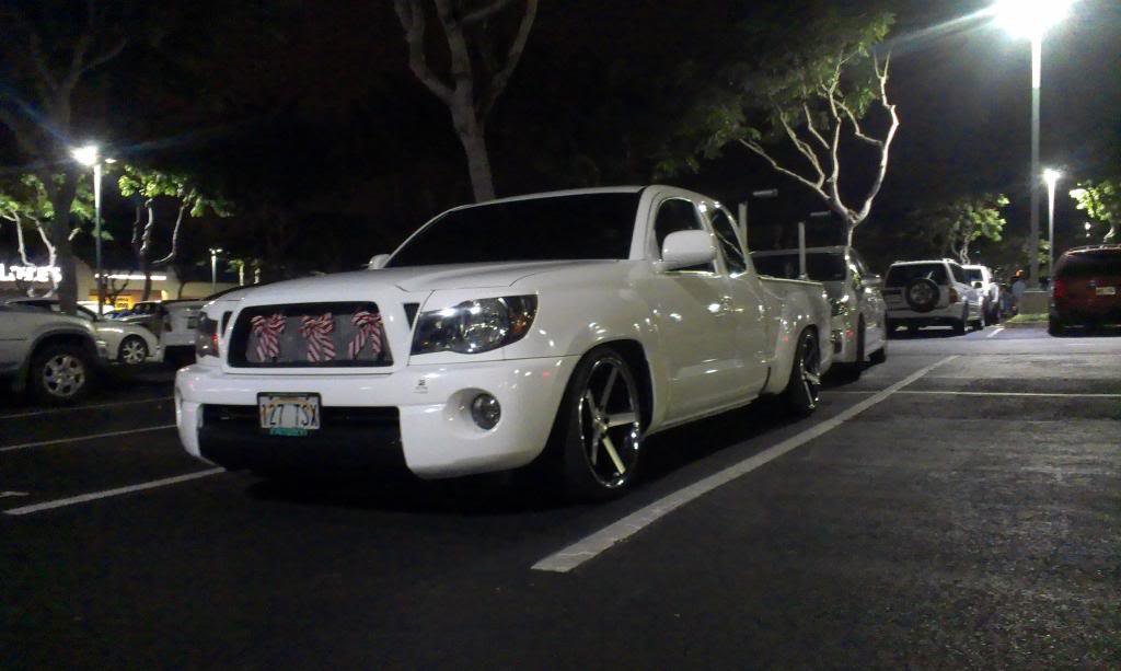

    Hahah my gf lives right by mccully but had no street parking so I wen just take one stall there haha always do that
    That's brah!!

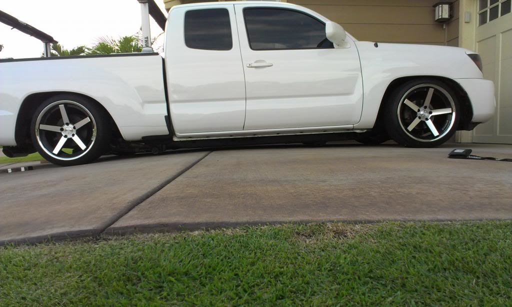

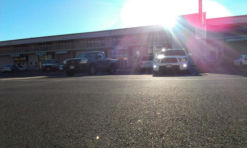

    Takes forever to get out my driveway and it ain't really steep haha got a ramp to get into it and wood blocks to put opunder the rear tires to not scrape the hump I'm sitting over
    Not totally updated since I decorated my racks

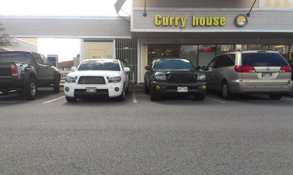

    Random truck at work

    barely clearing that driveway!!!!

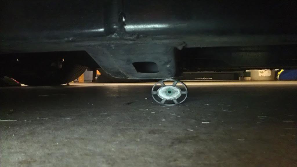

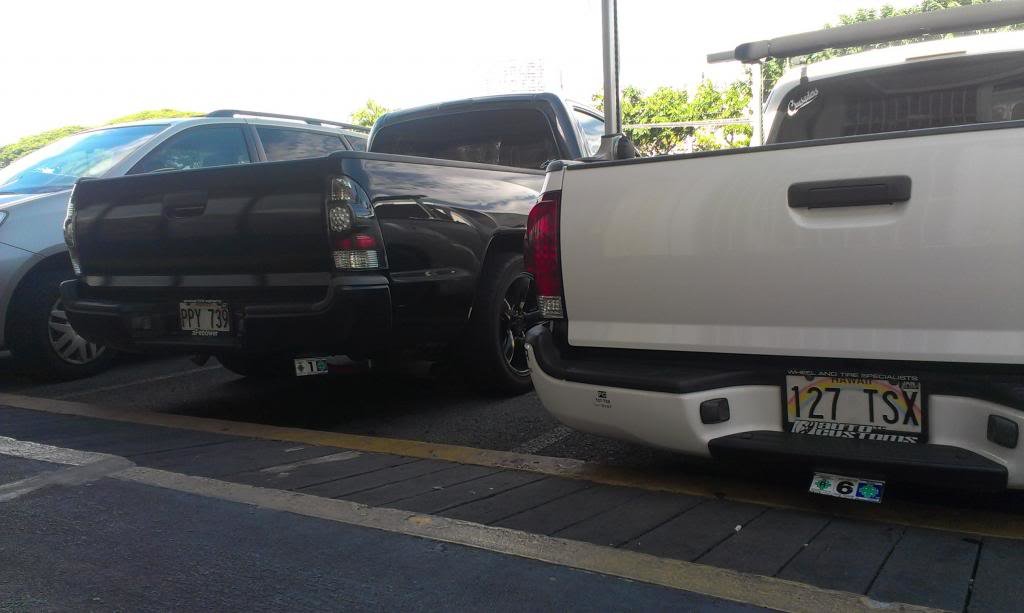

    Still no real updates haha sad my life but o we'll post a pic
    Just for you Jess!!!

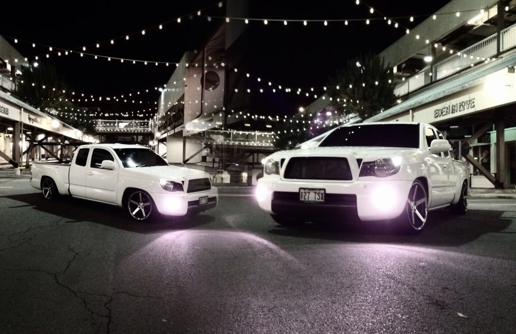

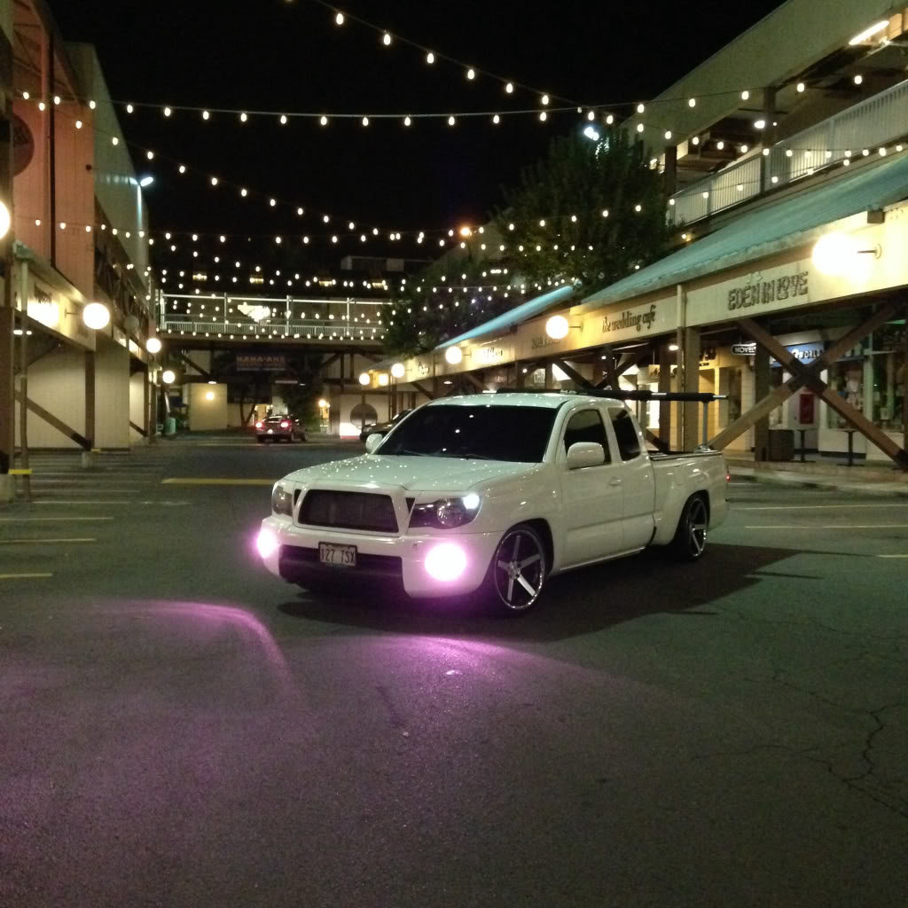

    Got bored haha
    Need moar low!!

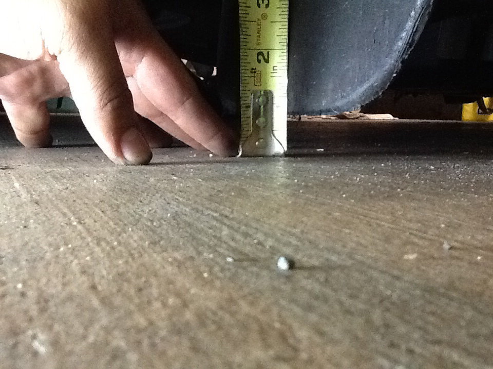

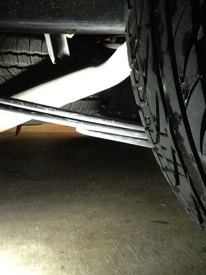

    Alright to add to today's progress I went back and took apart the rear again so I still have the spacer however I flipped the helper spring I noticed that when the leafs are at full droop the helpers bend the other way like a sad face slightly and when the truck is on the ground the helper appears flat but doesn't touch the middle leaf. So I flipped them upside put it all back together and took off the orielly lift support things cuz my truck was riding real soft . On the ground the helper now makes full contact with the leaf springs and maintained the same height and is stiffer than having those stupid add ons that nonstop squeaked. I'm very pleased truck is not leaning anymore and maintained ride quality the only shitty part is not I have 1/2" less play in the passenger notch which is the smaller side so I do bottome on a hard left going fast or a big ass dip but normal driving is perfect so hopefully new notch and doing the UCA are next on the list.
  17. Mar 8, 2014 at 12:56 AM
    #337
    xmods
    xmods Super Member
    May 15, 2012
    #78862
    2,860
    Nathaniel
    Kaneohe
    10' PRO-4X CC, modded..
    Too long to list :D
    Lookin' good!
  18. Mar 8, 2014 at 12:56 AM
    #338
    Brendo Ballz808
    Brendo Ballz808 [OP] Slammed or lifted.. ANYTHING IS BETTER THAN STOCK
    Feb 19, 2013
    #97896
    1,303
    BRENDEN
    Oahu
    SNOFLAKE
    Check out my build:)
    9366594641d9dc1c8a6ce6726da27ee2_zpsc1a6_450f7630ea502361753e9f58d4068f3a27484647.jpg
    Got some other pics on my phone but this is what I have for now yo can see how the helper is touching now
    8d5120f6ff32f4dcd465fb3988028447_zpscf22_2aa373e2088dd4babc8dc3b434ddabbd4ec2ce74.jpg
    Mudflaps back on! 3/4" from the ground
