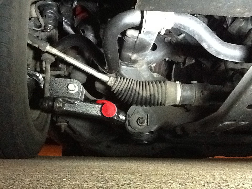

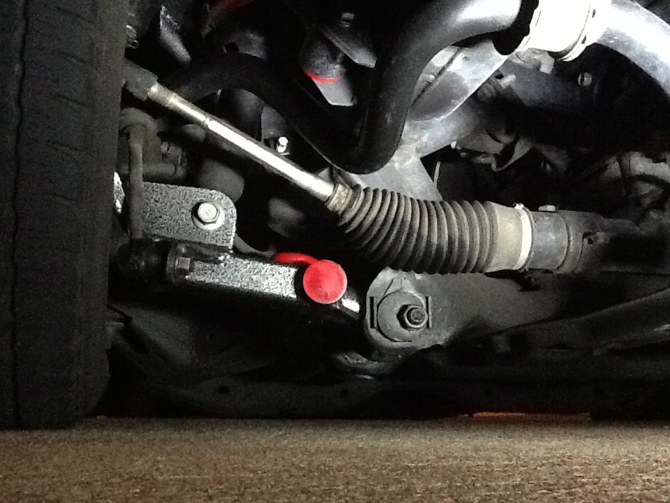

    So i just took out the 3 inch blocks and put the 2 inch blocks to help add clearance for a smoother ride and for recon but ima need some stiffer shocks cuz these stocks suck ass
    Heres some pics of my front end after alignment no rubbing issues besides the tires skimming the inner plastic on hard turns or huge dips truck rides way better now that the back has clearance for how low the dayum truck is I'm pretty impressed with how it rides and steers

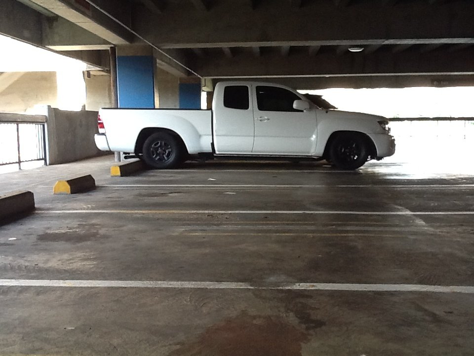

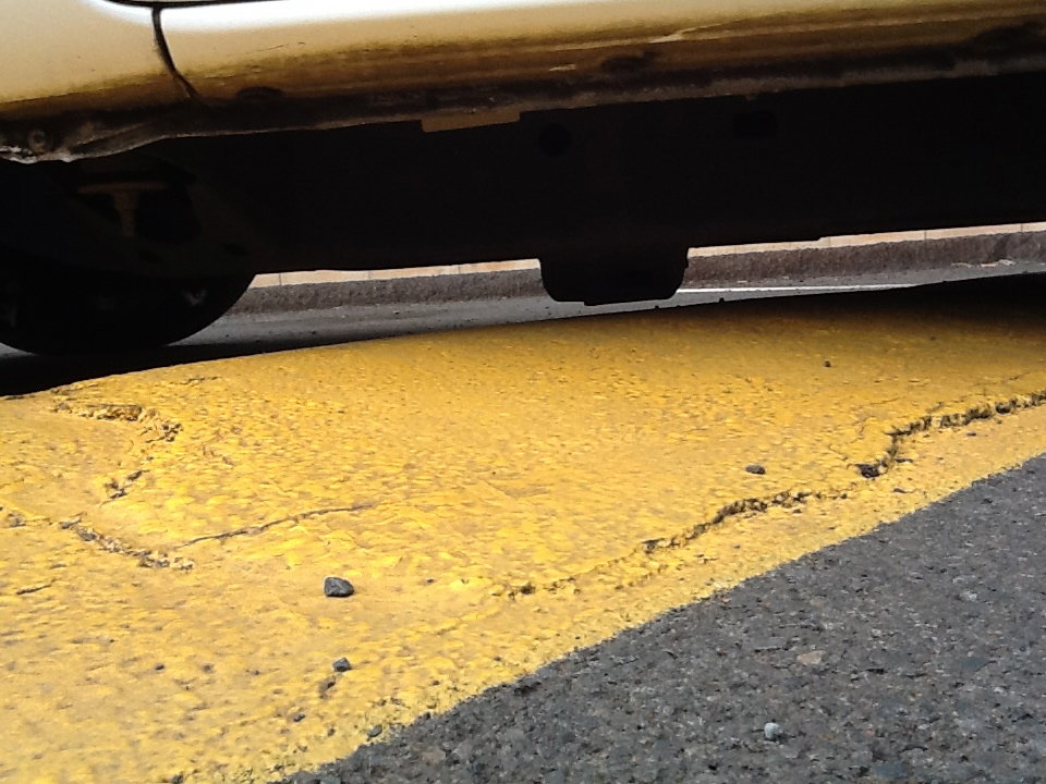

    So i was having some fun on my lunch break today picture whoring again:p
    Small speed bump not a normal size

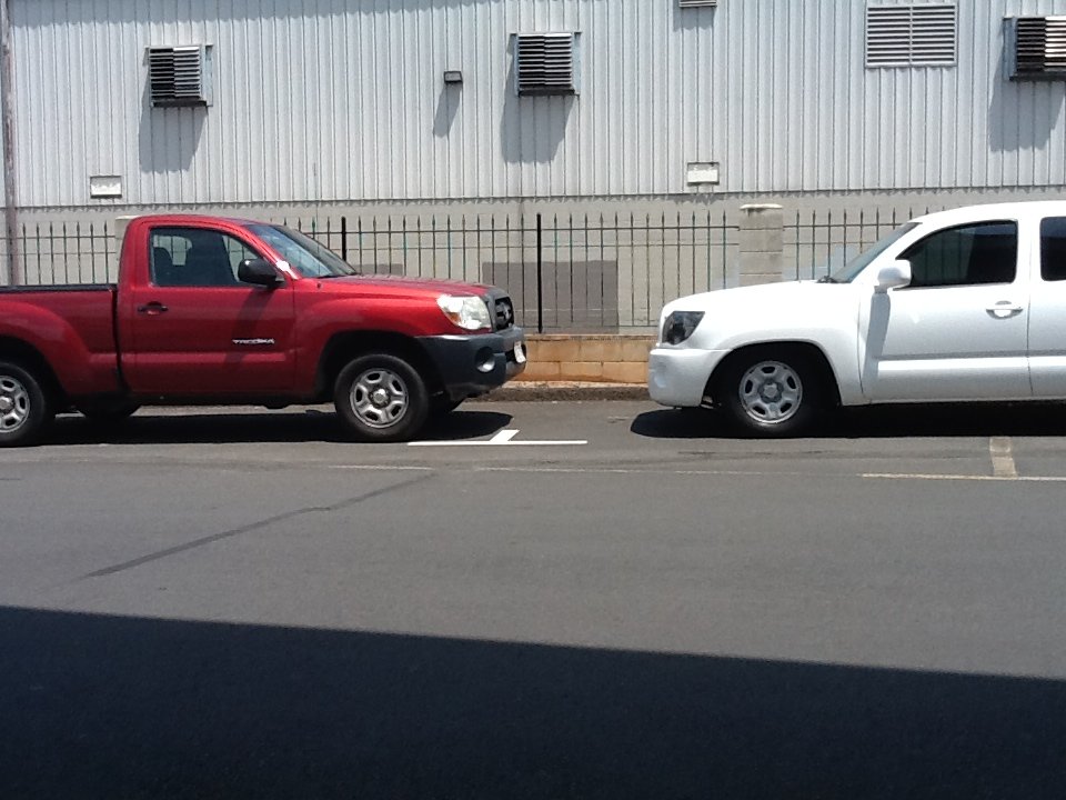

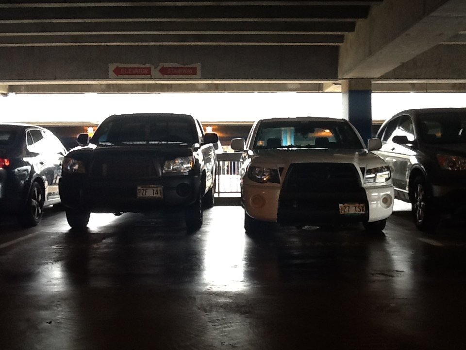

    My work truck I use compared to SNOFLAKE!
    I say barely noticeable muhahahaha:rolleyes:

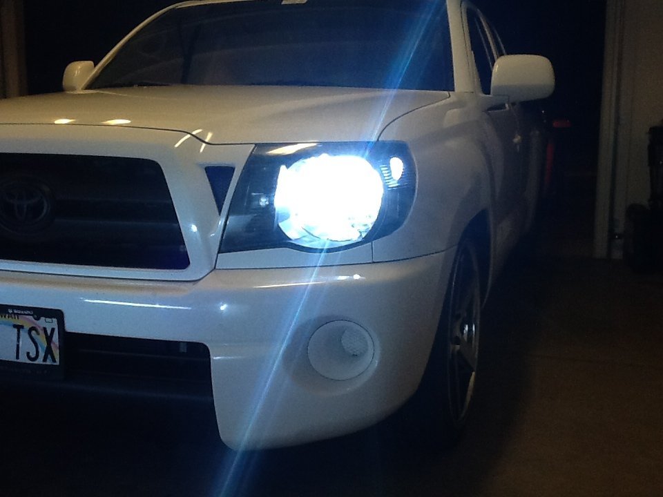

    8K HIDS

    what offset/backspace are those wheels may I ask?
    basically your running 4" lower on the front with the arms and lowered coil yes?
    How low is the lowest point of your vehicle underneath?

    the wheels are 20x9 +20mm offset up front which are perfect on 245/35/20
    the rears are 20X10 +35 mm which don't poke out on 275/30/20
    Im running the 3" UCA and LCA
    combined with 1.7 XII performance coil which giving in all actual gave me 5 inch drop out front

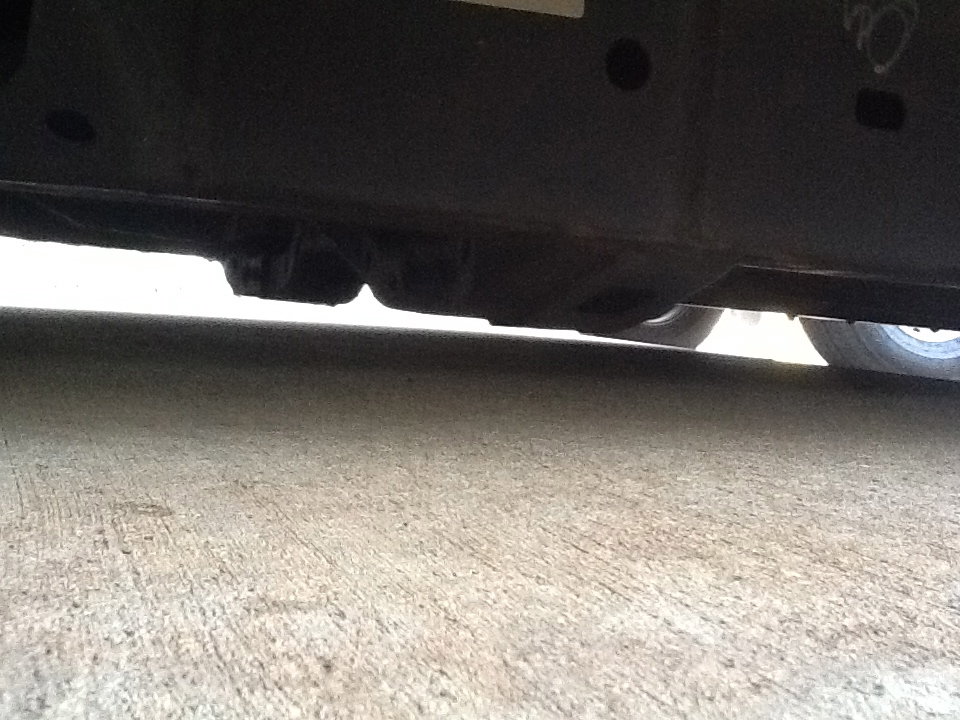

    if I'm on level ground the transmission crossmember is about 2.5-2.75 inches fro mthe ground pretty dayum low I scrape everywhere now:p thats the lowest part of the truck the ride isn't bad but i do rub my stock tires on huge bumps or hard turns

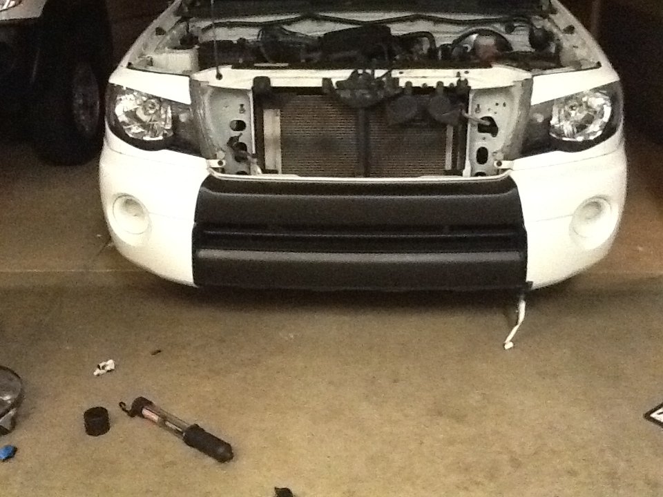

    So just for fun i bought a can of plasti dip and went AO haha
    Did my stock wheels
    Grill and Bumper and i also had some white tape laying around and decided to make eyelids since I didn't buy any yet yes its ghetto but o well looks good from far:p
    New look whats your thoughts?
    EVO STYLE!

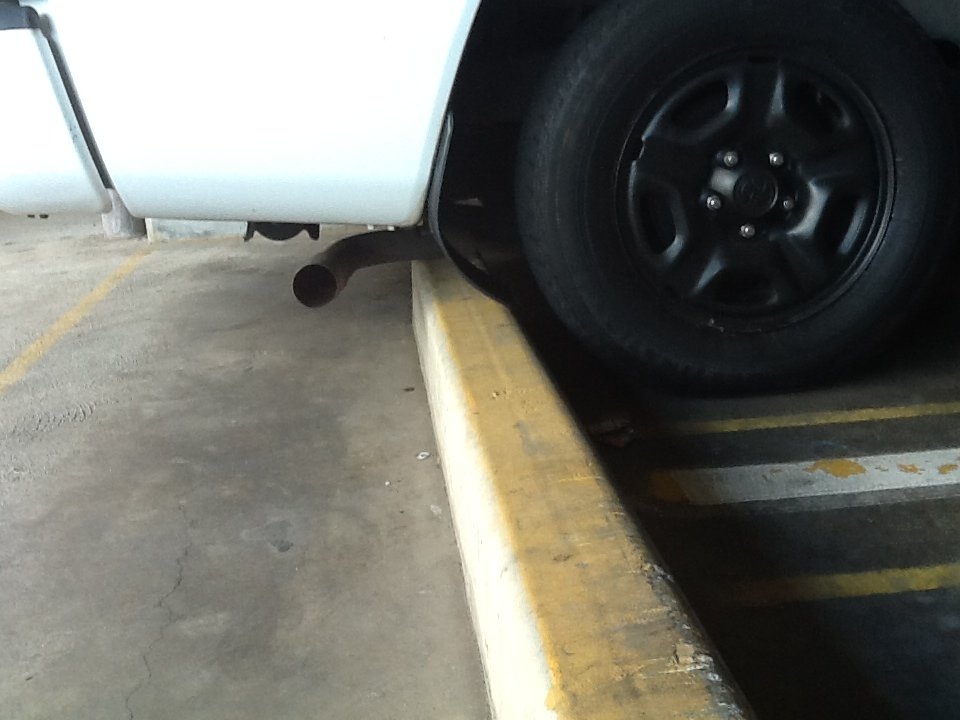

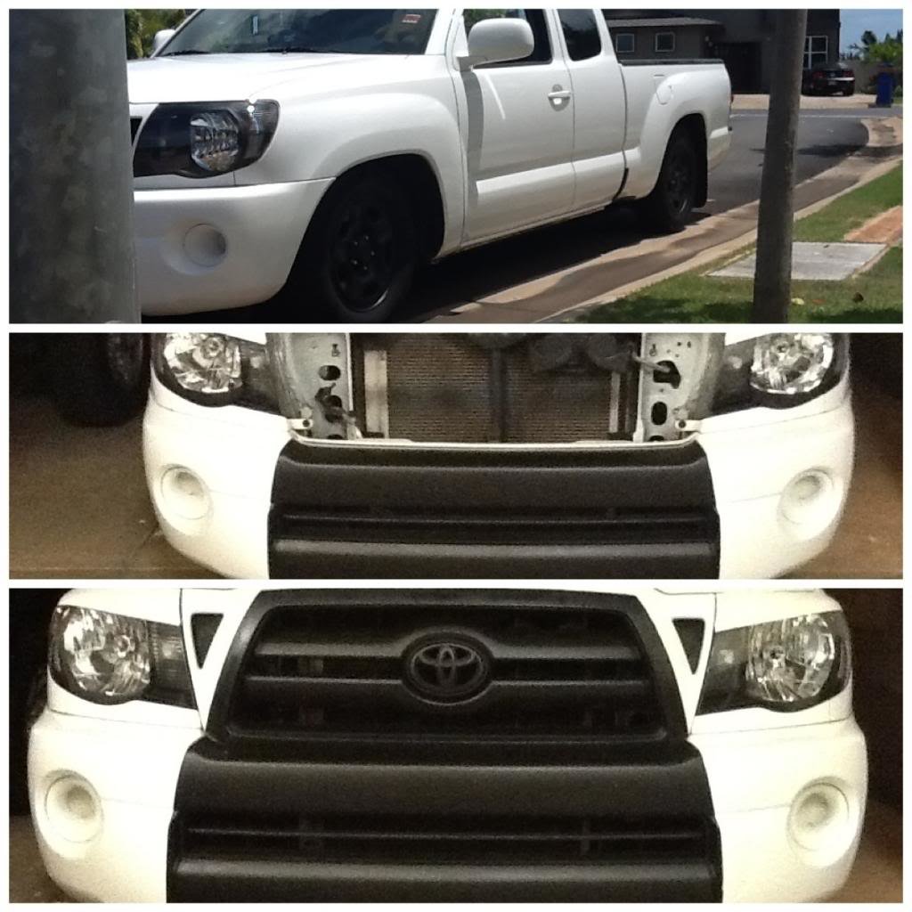

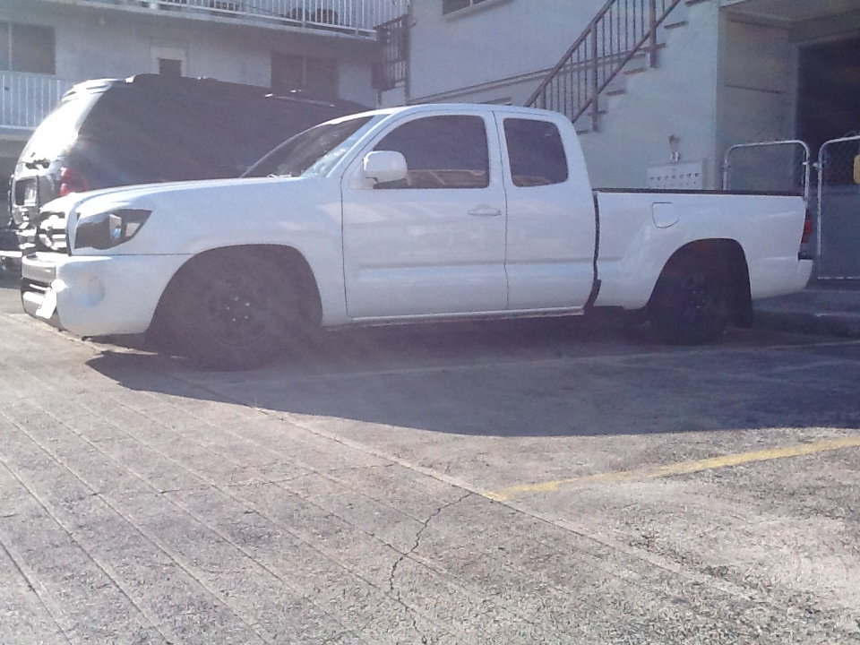

    Nothing really new just was bored took some pics at UH today and my GF house
    Stock vs. ME
    I really need to get the back notched
    MUD fFLAP KILLER!!
    I can almost guarantee if I had an runner with this drop or had the dayum body kit the truck would look absolutely lo up front id imagine it be like 3 inch from the ground thats the only draw back on these base models even when dropped so much they still look high maybe one day ill raise the tranny crossmember and go another inch lower
