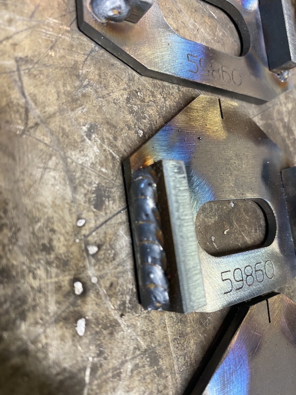

    LT kit showed up. Everything seems to be well made. All grade 8 hardware. All uniballs are fk. Bushings were changed out to dirtking ones. Even came with the ground down steering stop adapter for the spindle. Guy included that. LCA are heavy and internally welded.

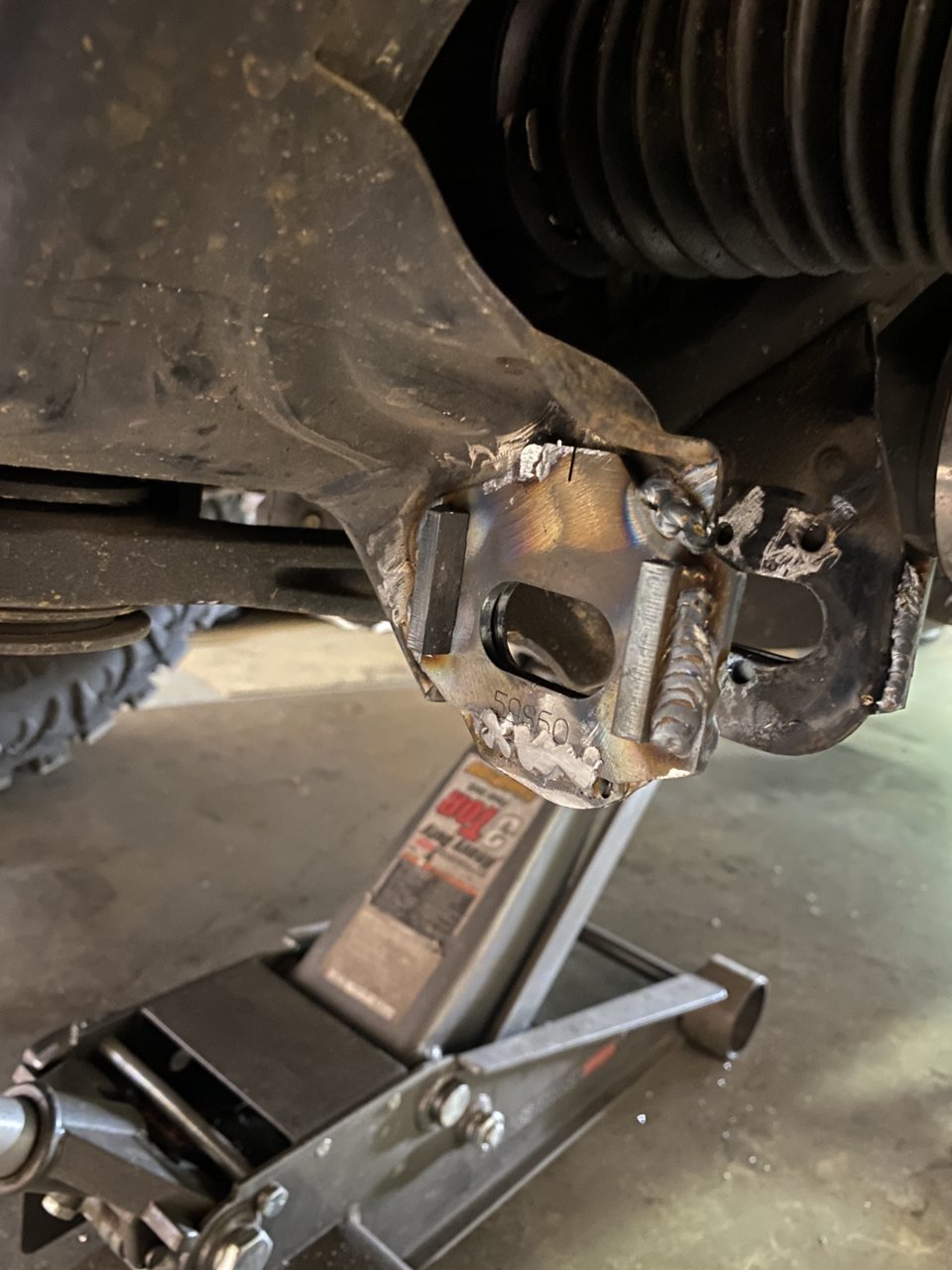

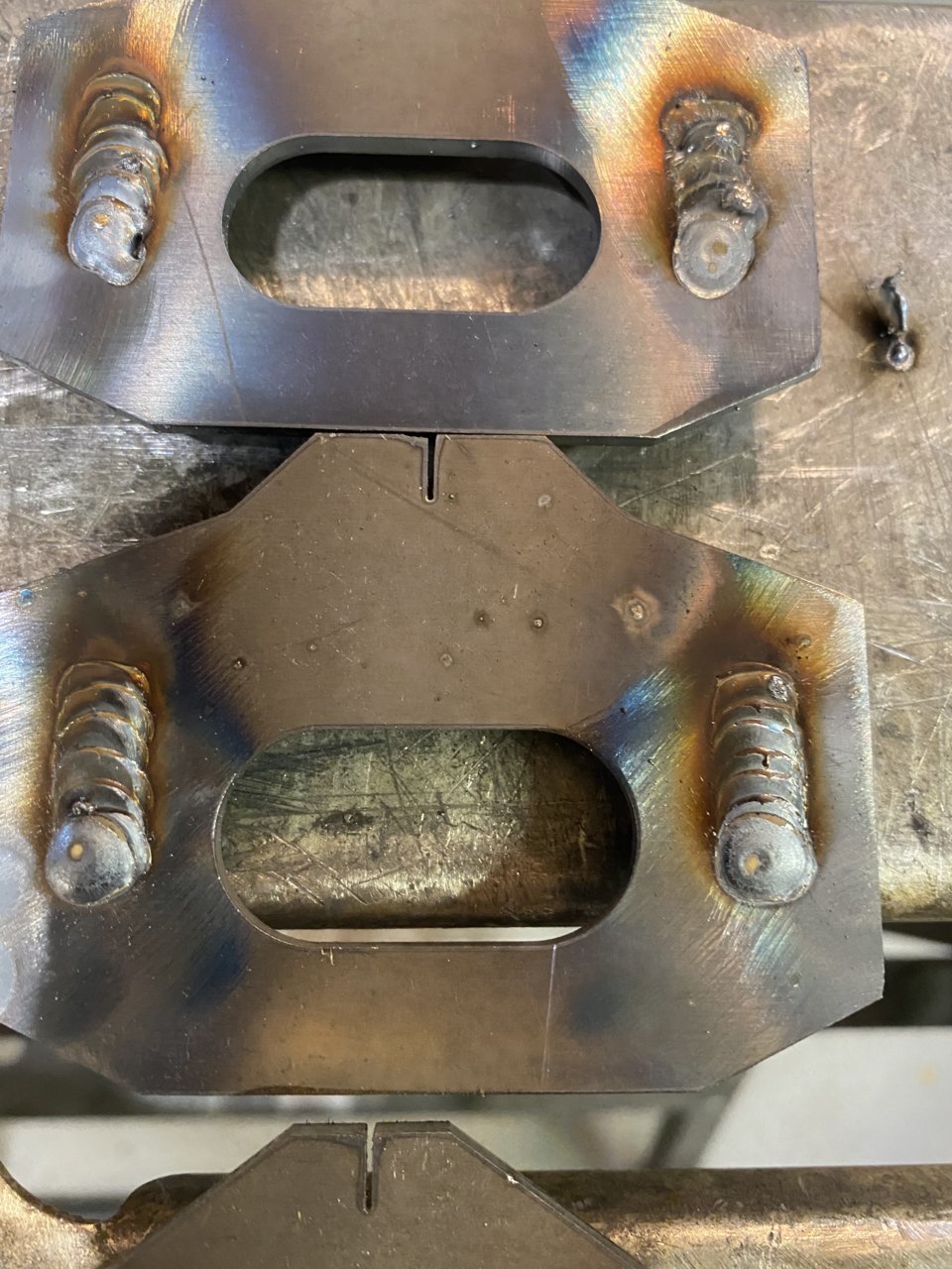

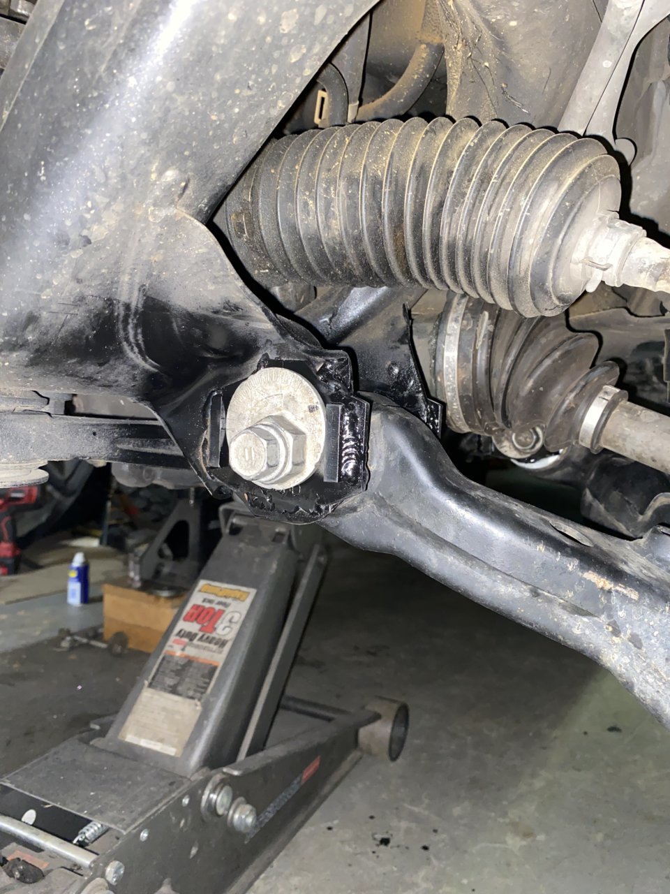

    Got a lot done this weekend to the driver side still got to do the passenger but should go quicker than the driver since I have a handle o how to install everything now.
    Anyways got the spindles painted and cleaned up. New wheel bearings and axle seals. Extended the tie rods. Welded a 3/16 plate to the frame and then welded the strap mount to it, so it won’t tear. Also painted the frame back and I stalled upper control arm. Having an issue with my lower control arm because of the MC gussets. About a 16th of an issue bent in. On the inboard side and can’t get a grinder in there to grind down. Already tried to pry back with a long prybar those gussets make it extremely difficult. My stock arms were super hard to remove because the were welded around the arms.
