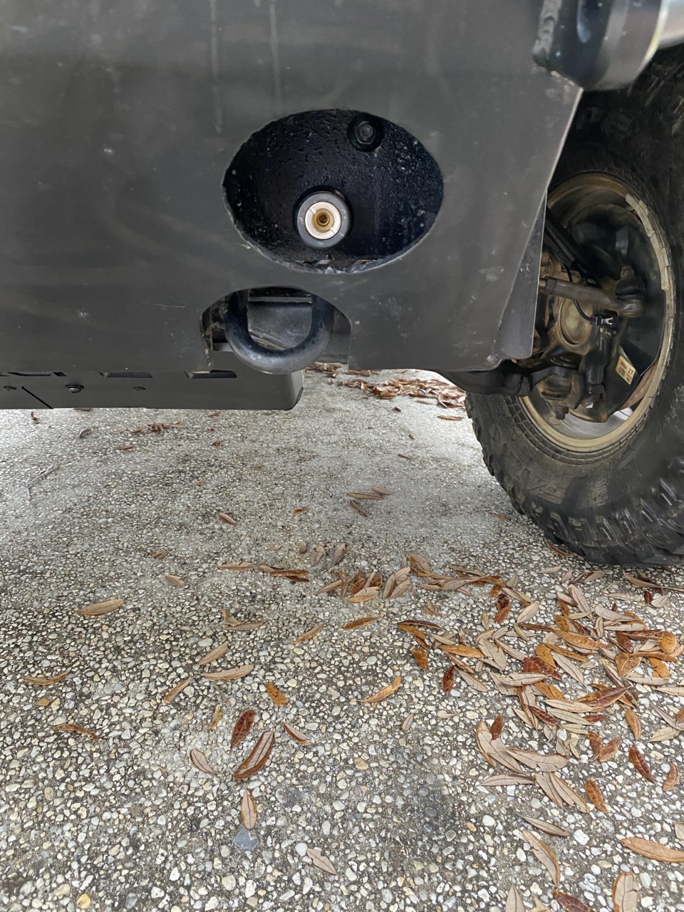

  17. Mar 23, 2020 at 7:39 AM
    #217
    Brian422
    Brian422 [OP] I fell into the pit that is TW
    Jun 8, 2011
    #57958
    15,712
    Brian
    Birmingham, AL
    2012 DBCSB F/R Locked, 35's ,Long travel, 23 Tundra 4x4 limited
    Not Stock

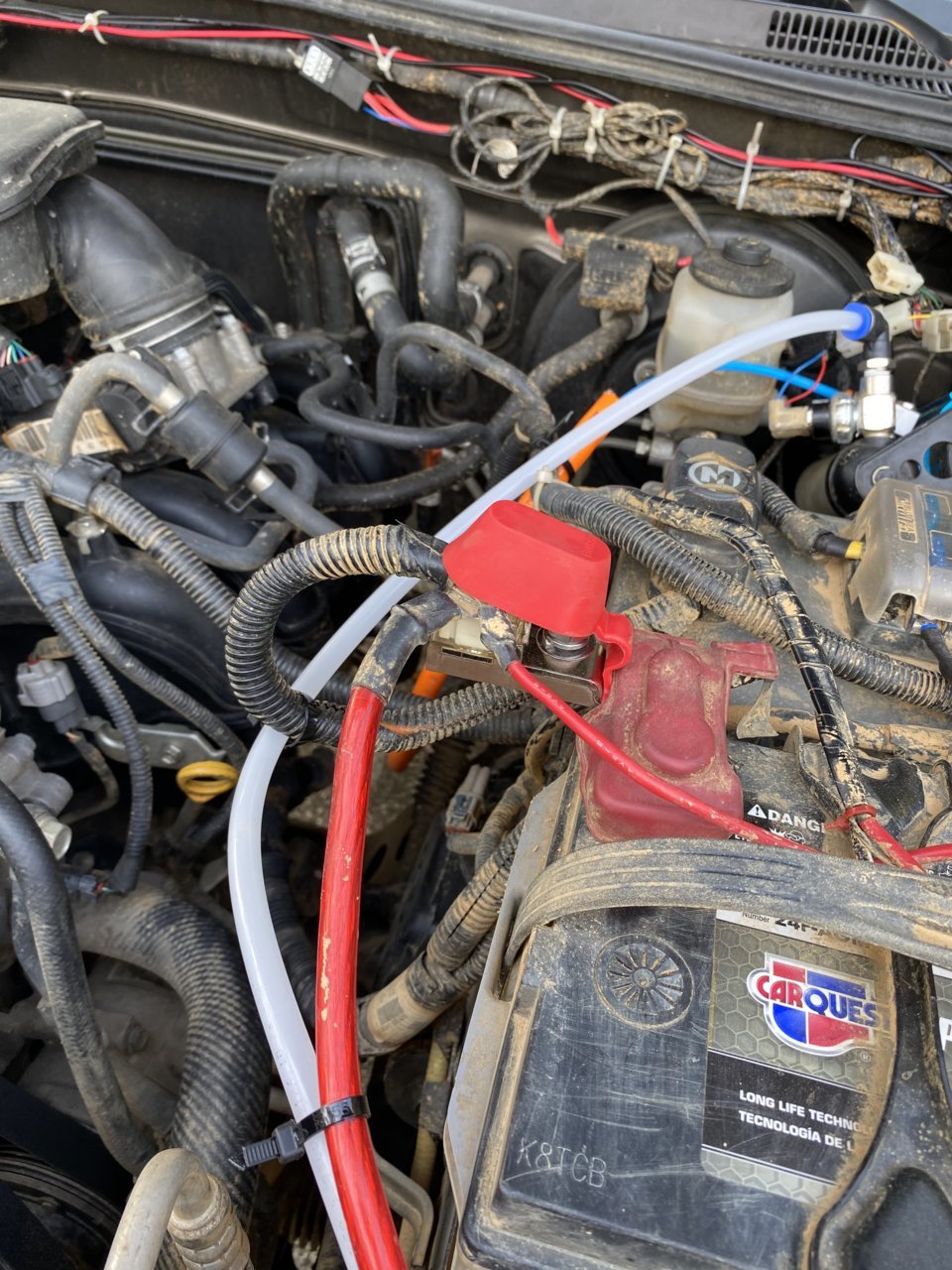

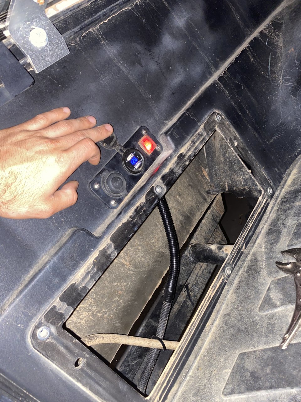

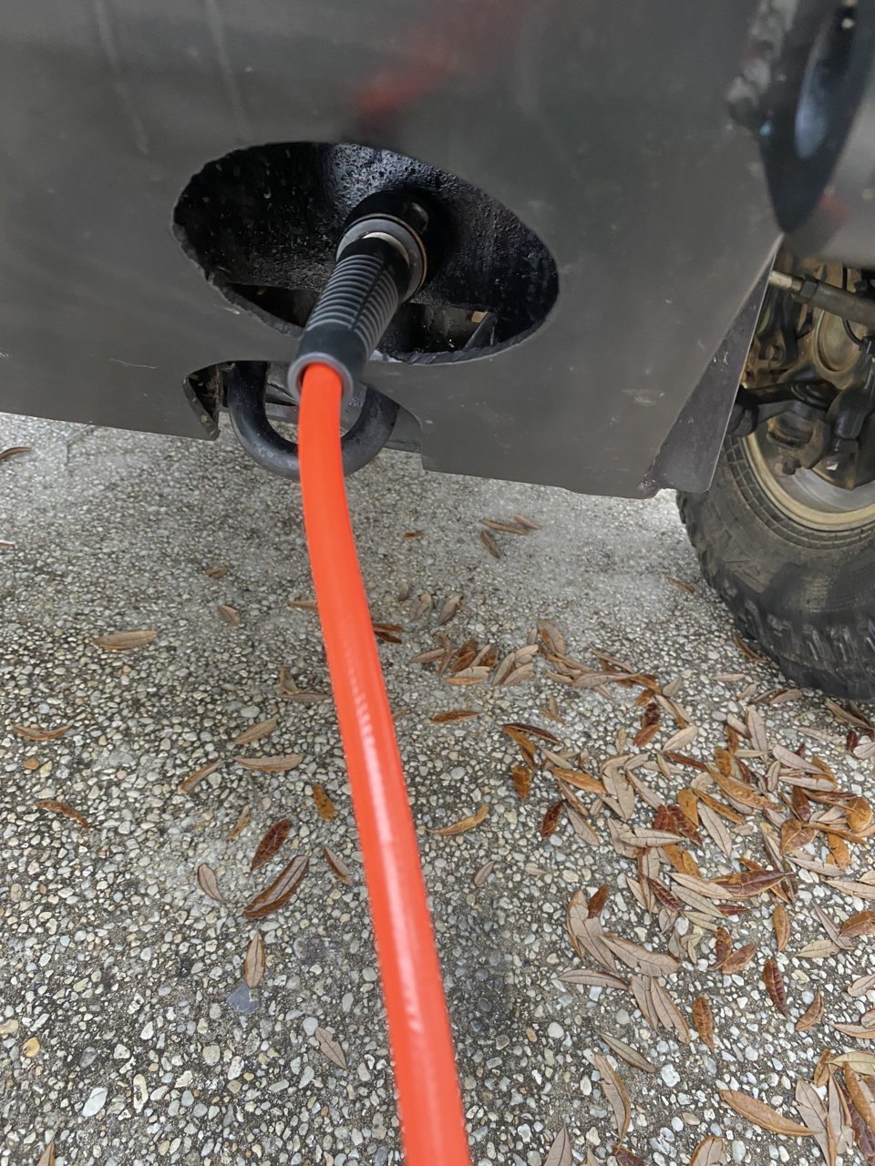

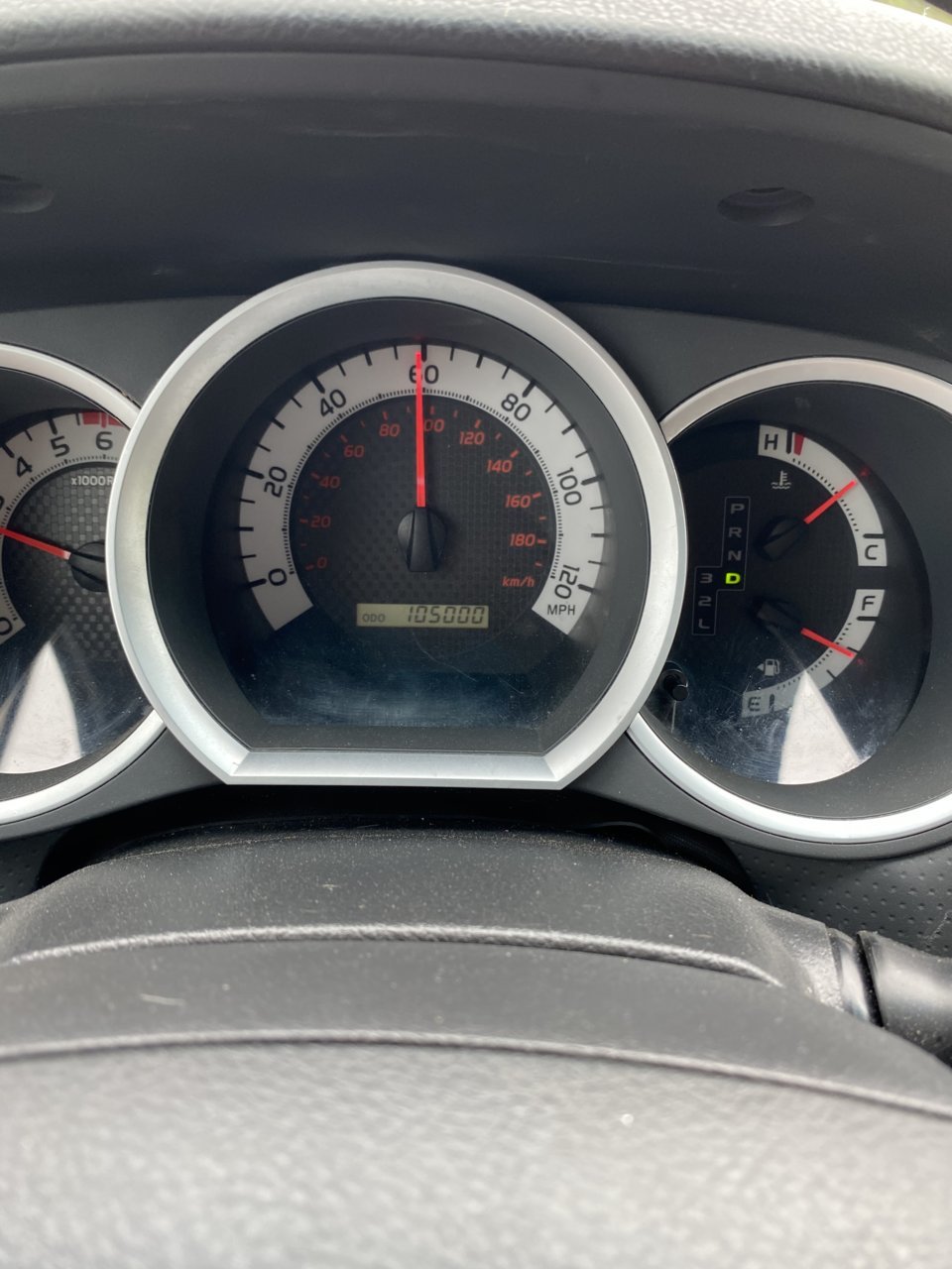

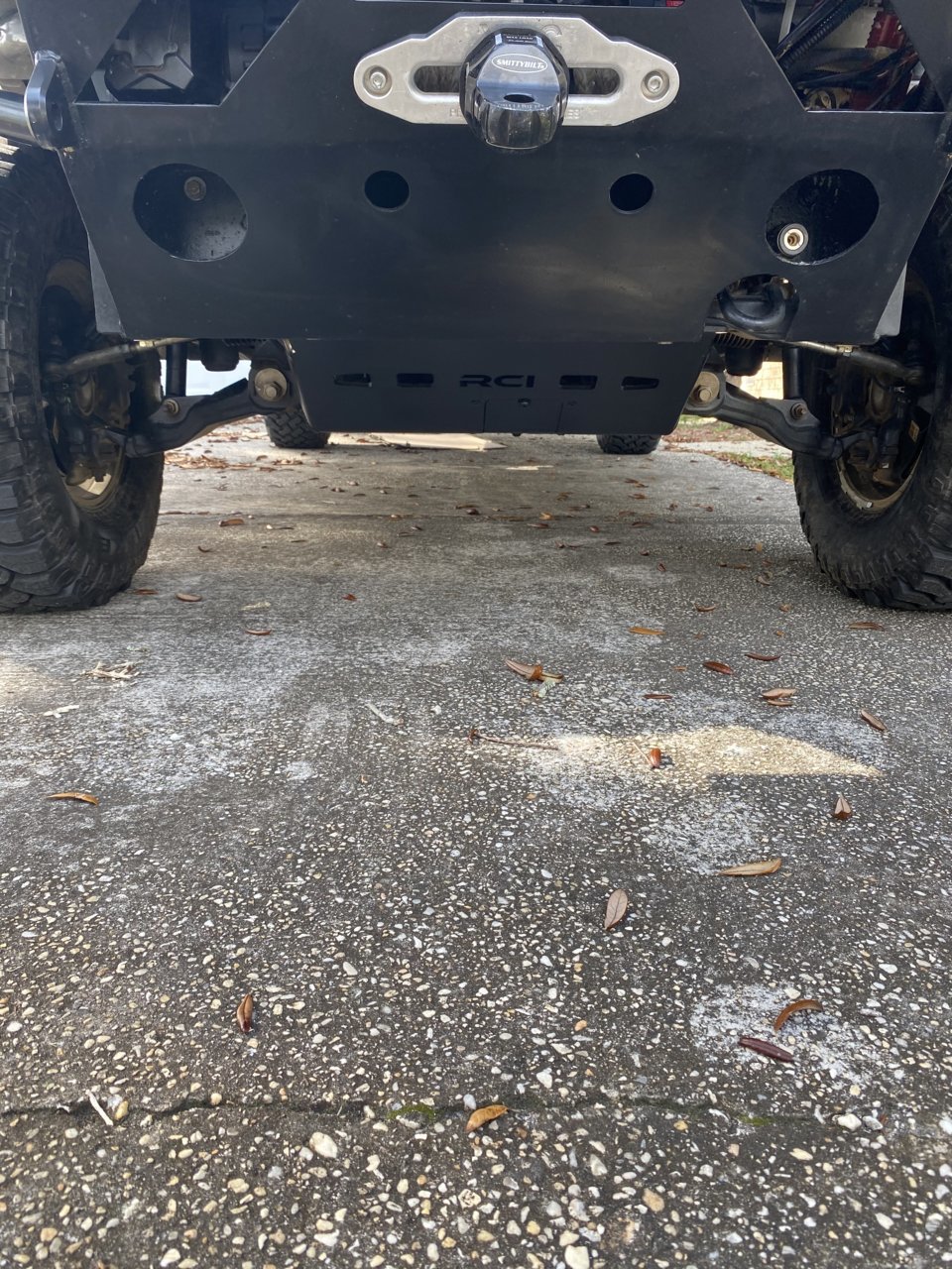

    Got a ton done on the truck this weekend while visiting my mom on the coast. Also got to tune up the boat for the summer if the virus doesn’t kill everyone by then!
    relocated my air chuck to the bumper. Painted my rci skid and cleaned it up. Cleaned up the wiring in the engine bay. Got my bed outlet operational again. Cleaned up my bot changed the oil and filter with spark plugs.
    passed the break in period
    MattCowsmasher likes this.
