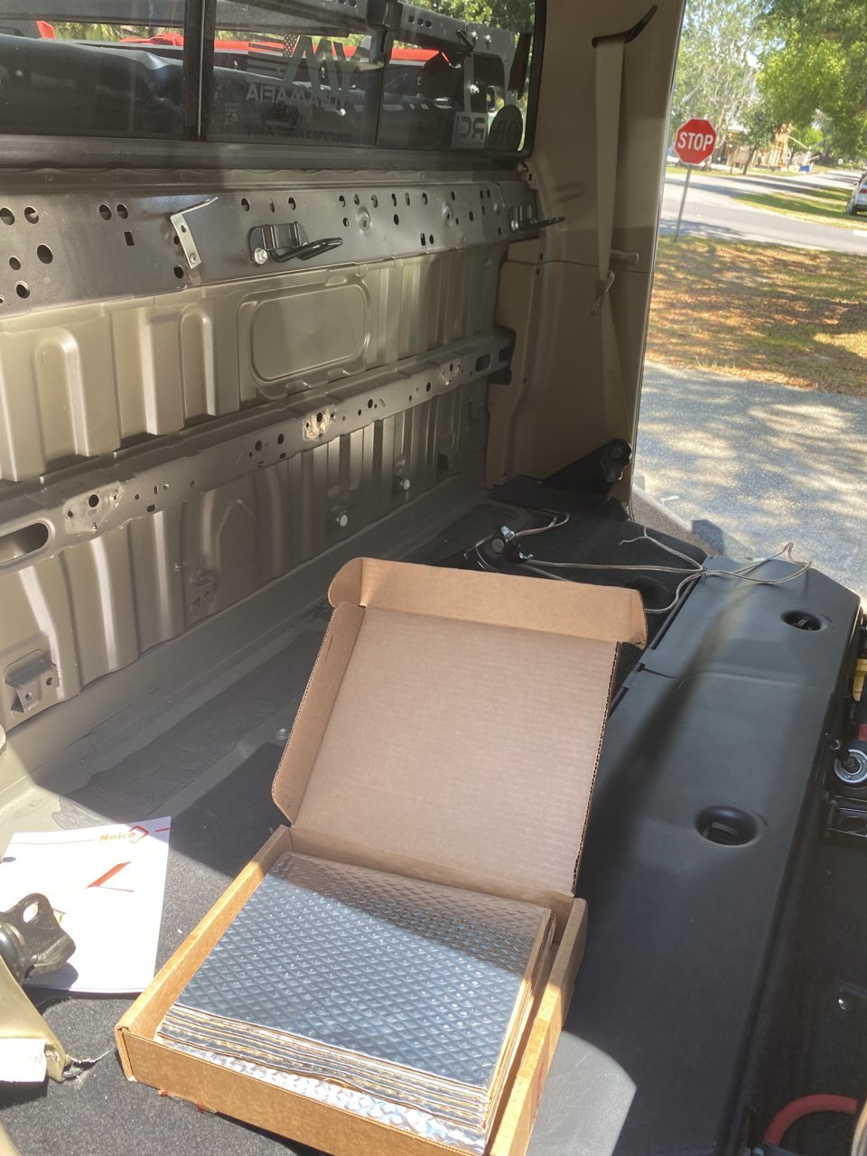

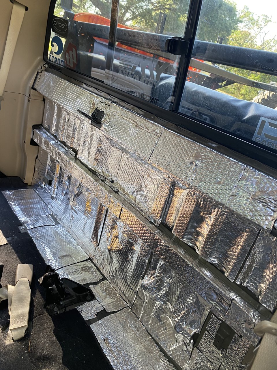

    Forgot to post the other day but added some noico sound reading to the back wall

    Nice job. I have some sound deadening mat left over from when I deadened my doors three years ago. Does the back of the Ex-cab made a nice difference?

    Yes I notice a difference. I’ve got some more coming tomorrow and I’m doing all the doors and roof.

    Cool. Thanks. Pulling the headliner sounds pretty involved. Just a youtube video away I suppose. ;)

    Yea I probably won’t get to the roof for a while

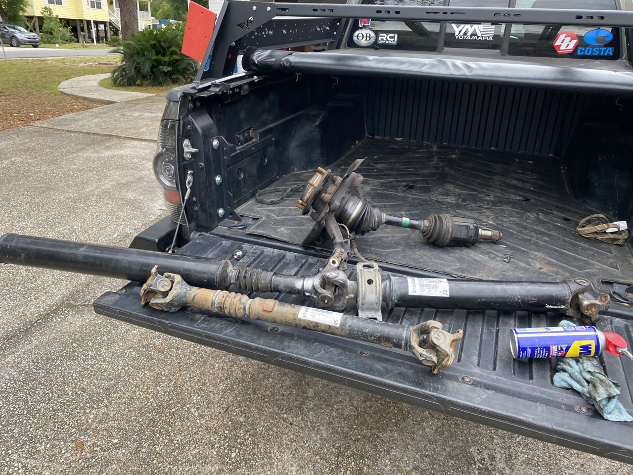

    How's the 4wd part hunting coming along?

    Its going well. Ive got all the large parts now! Just need a couple of odds and ends. Trans mount, Hubs, seals and ADD switch. Also need to modify my crossmember. Lastly send diff off to get regaered and we ready to rock and roll!

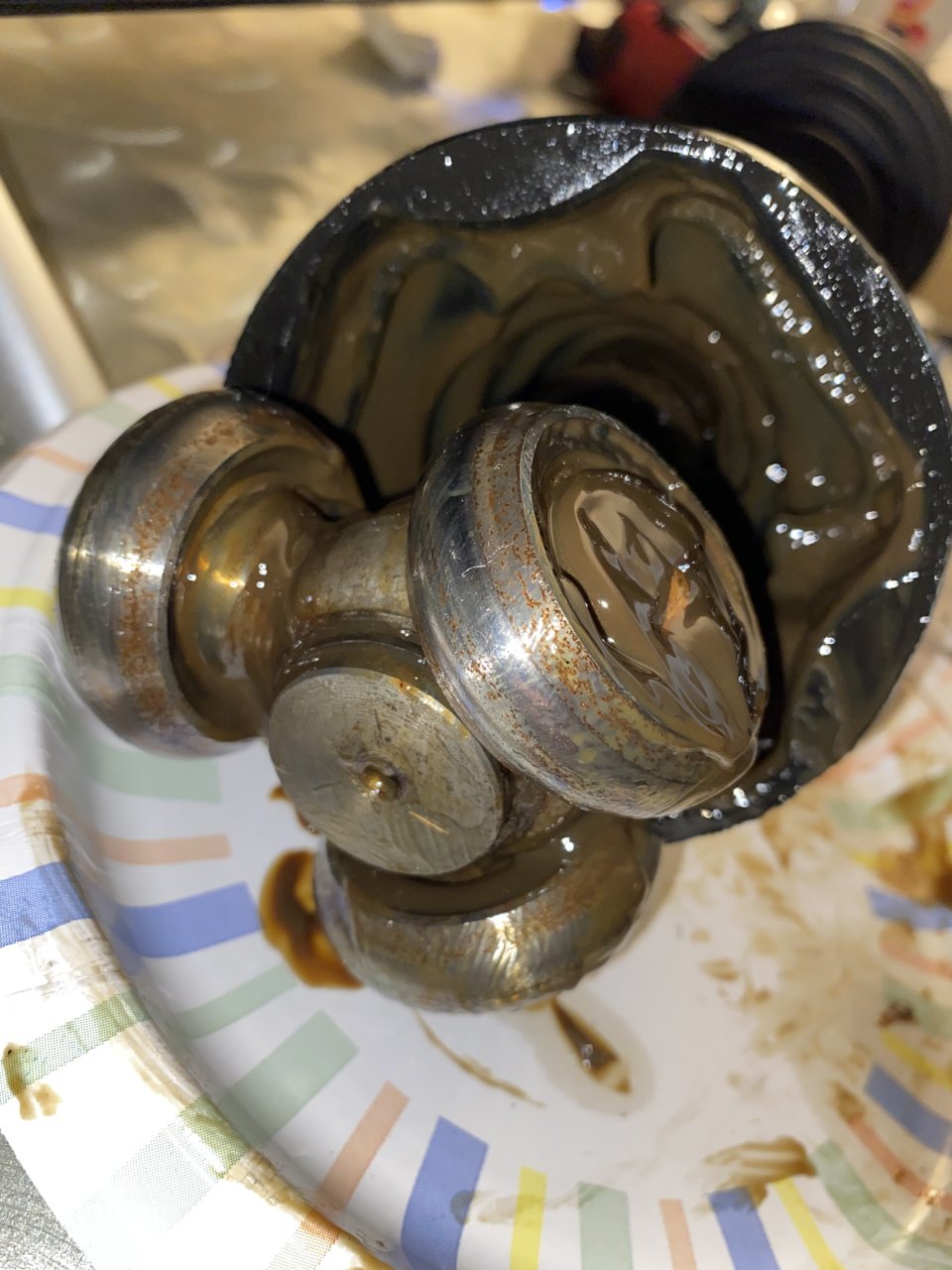

    @JBTacoma got around to pulling the boots off. Goodness it’s messy. Anyway looks like the inner joint needs to be replaced on this axle? Not sure if it’s supposed to look like that. Axle was at 115k.

    Lol I told you to have plenty of towels.
    What is wrong with it? The bearings are suppose to wobble side to side. As long as they spin free and the needle bearings are not falling out they are good. Get a Scotch-Brite pad and clean the rust off the outer race.

    That's good to hear. I think Brian's referring to the rust spots on the outer races. I suspect the spots are surface rust from not having grease on that surface.

    https://www.youtube.com/watch?v=vcCT4UgFUTw

    Scotch-Brite pad should clean them up good enough, find me a deal like you got on those CVs

    He shows you how to do the boot slide mod too if you want to do it. It stretches the boot out so the fins don't rub, some people do it and some don't.
