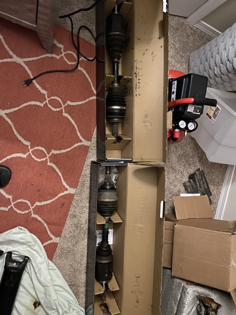

    Here they are 3 for $100:D

    lol i was saying these are the ones i bought lol.

    Welp got 4 OEM cv now 3 seem to be usable and one needs some new parts it looks like. Buying reboot kits soon.

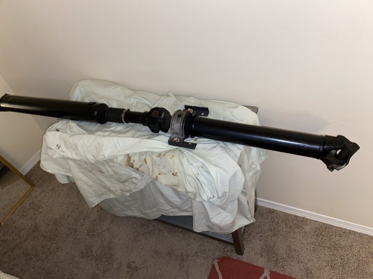

    Painting the driveshafts

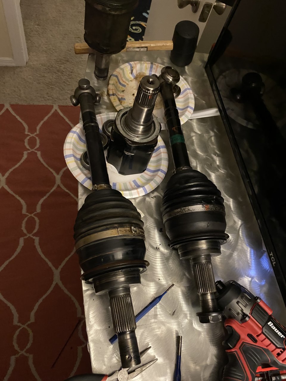

    @JBTacoma one of my cv need a new tripod. All the inner joints fell off. Do you happen to know the part numbers. I can’t find it online?

    No Sir I don't but I will see if I can find it.

    Thanks, I ordered my boot kits today. I want to try to get the axles done this weekend. If I can’t find it I’ll go to the dealership and show them the pic and see what they say.

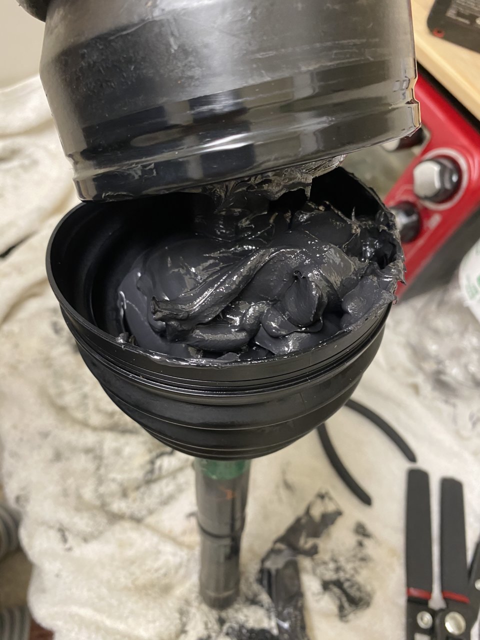

    Welp got my cv’s rebuilt and finished!

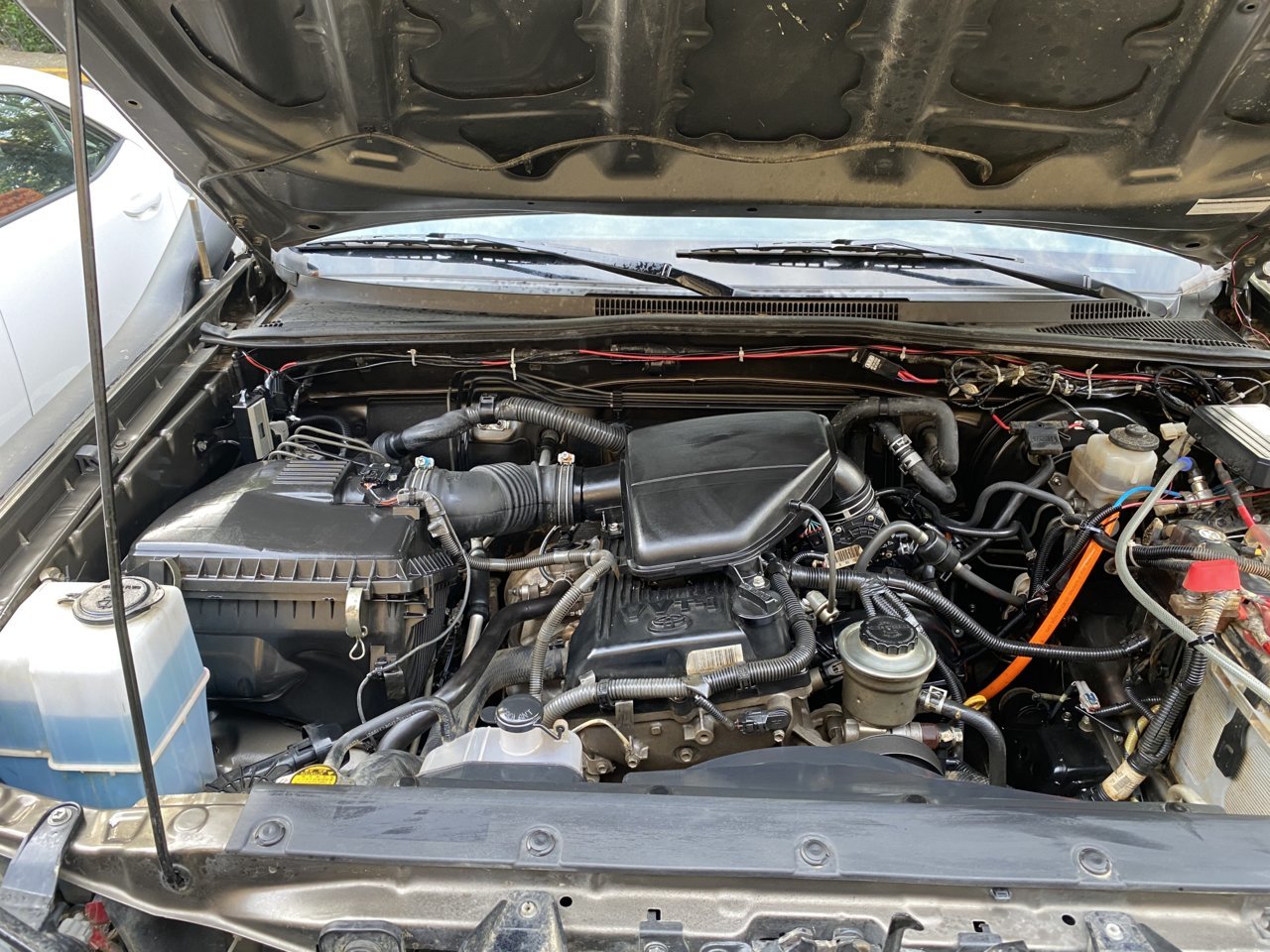

    Finally cleaned up the engine bay pretty good!

    Nice. Any before pic? Not surprised but your2012 2.7 is different than my 2000. You have VVT and after a quick search, you have 9 more HP and 3 more ft/lbs of torque.

    Sorry I don’t but I can say it was dirty lol. Not like crazy but not how I wanted it.

    I figured it was a little dirty, lol. I've seen a vid of you plopping down in a mud hole. :mudding:

    BTW, what did you use to clean it up?

    Sload and water and a sponge. Air dried. Then I took gunk degreaser and wiped excess away. Dried
