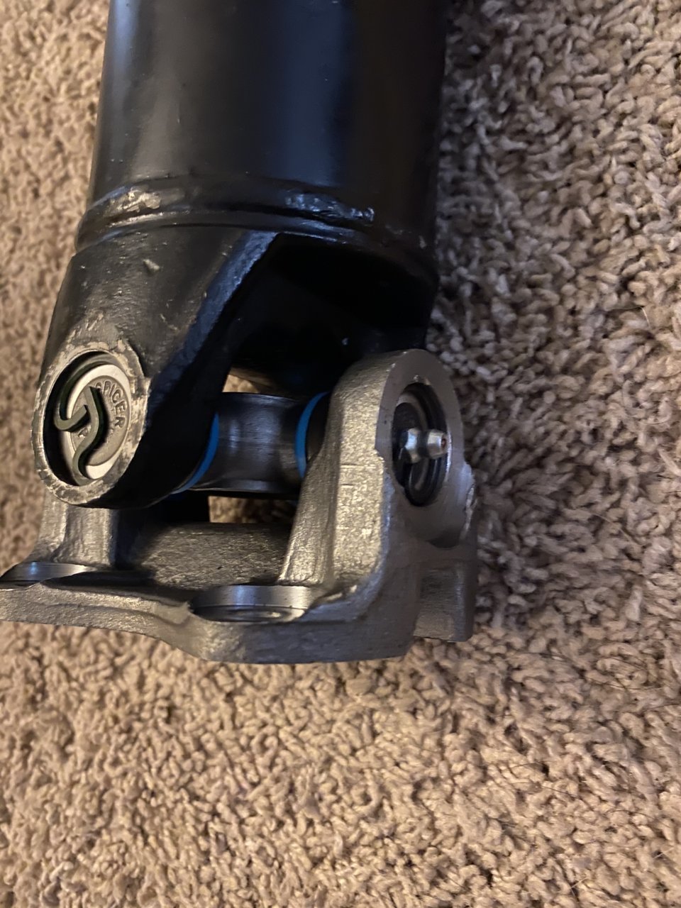

    Welp here she is! All in. The up and down movement is pretty stiff. Haven’t greased yet because my grease gun decided to break but I tapped the flange and it still seems stiff. Any ideas @BassAckwards

  5. Jul 24, 2020 at 4:17 PM
    #305
    BassAckwards
    BassAckwards Well-Known Member
    May 3, 2016
    #186002
    27,954
    2009 Tacoma AWD Turbo 2TR-FE
    Full-time AWD & BorgWarner EFR 6258
    Stiff is normal for a new ujoint. Are you able to move it at all by hand or does it feel like it's binding? If it's just tight but you can move it by hand, then that is normal from my experience

  6. Jul 24, 2020 at 4:22 PM
    #306
    BassAckwards
    May 3, 2016
    #186002
    27,954
    You could take a pen and poke the end of the zerk to see if there is grease under pressure, that might help a little, but I've found that all of mine have felt very tight after changing them. I almost thought it was suspect too bc they felt pretty tight, but after installing the driveshaft i never had issues with them

  7. Jul 24, 2020 at 4:25 PM
    #307
    Brian422
    Brian422 [OP] I fell into the pit that is TW
    Jun 8, 2011
    #57958
    15,657
    Brian
    Birmingham, AL
    2012 DBCSB F/R Locked, 35's ,Long travel, 23 Tundra 4x4 limited
    Not Stock
    The up and down move ment is almost playful but the sid yo side movement isn’t binding but def takes a little force!

  8. Jul 24, 2020 at 4:27 PM
    #308
    Brian422
    Jun 8, 2011
    #57958
    15,657
    Brian
    Birmingham, AL
    Not Stock
    Just tapped with hammer a little more and it freeed up a little more. Maybe when I grease it it will be smoother

  9. Jul 24, 2020 at 5:25 PM
    #309
    BassAckwards
    May 3, 2016
    #186002
    27,954
    I think you're good to go. Tolerances are pretty tight on those. You went with spicer ones right?

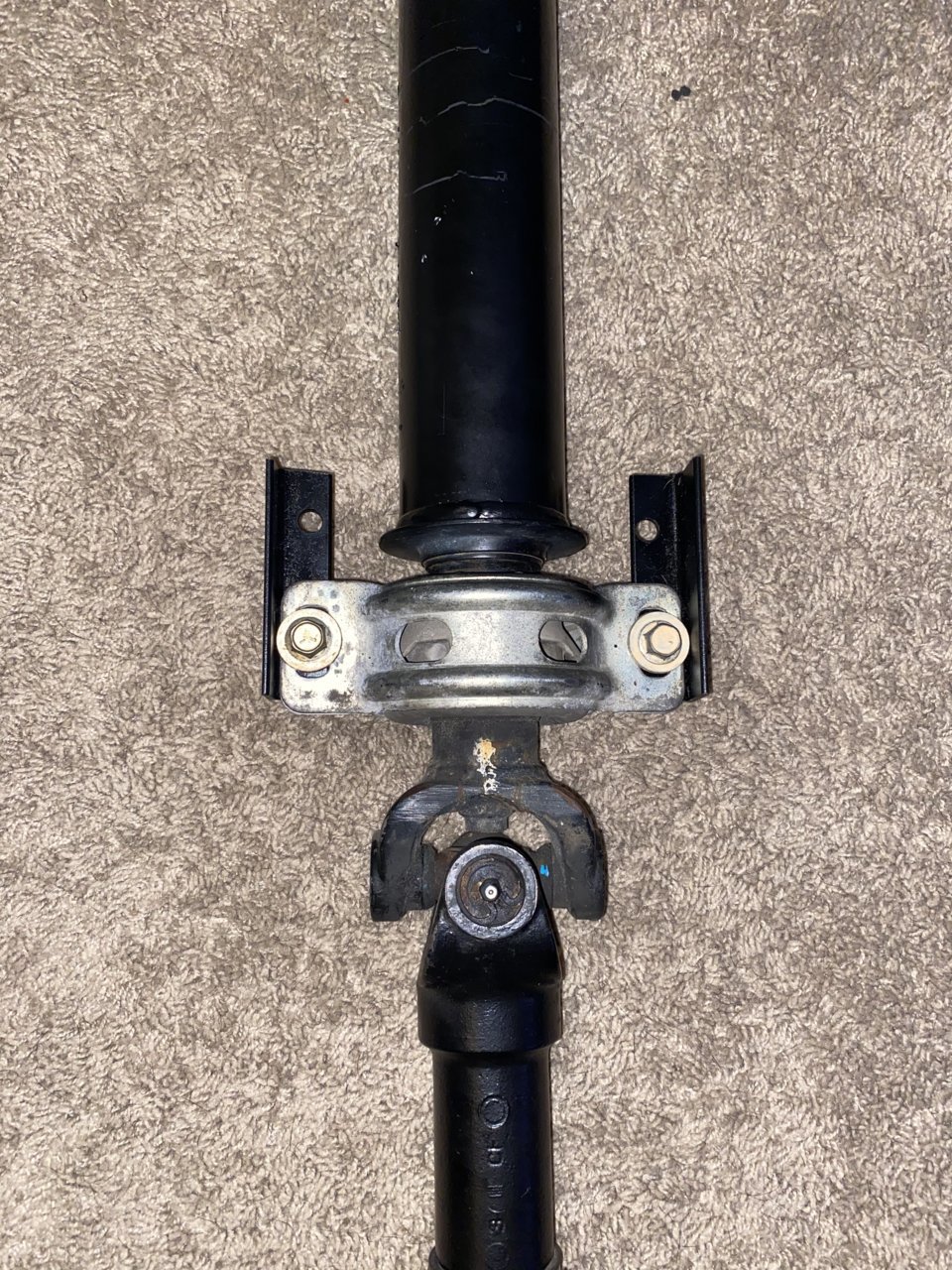

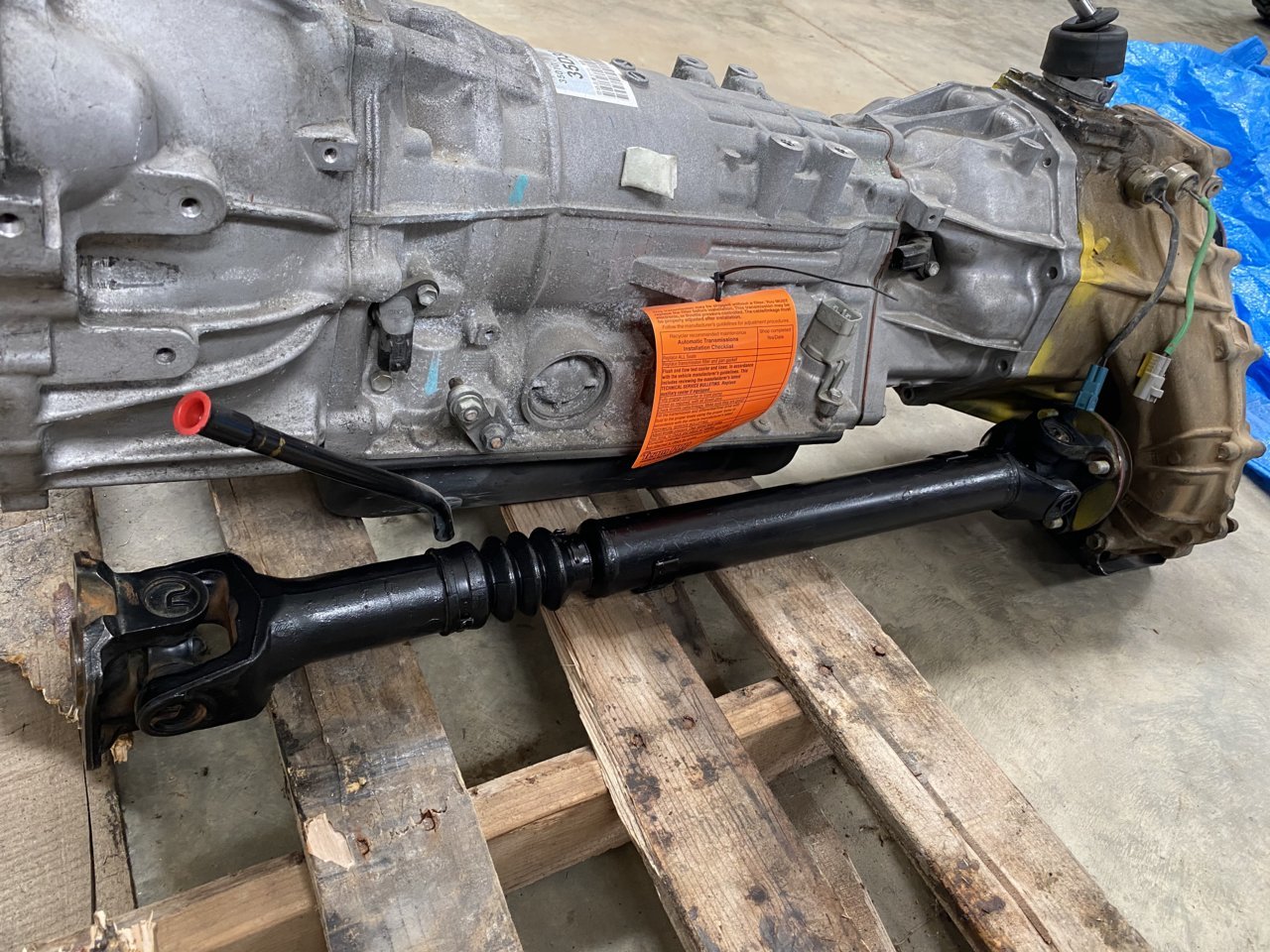

    @jowybyo how much does your front drive shaft clear the dipstick tube by?
    BassAckwards likes this.
  15. Jul 25, 2020 at 4:03 PM
    #315
    jowybyo
    jowybyo Well-Known Member
    Nov 19, 2013
    #116863
    6,092
    Joe
    Baltimore, MD
    '14 MGM DCSB Postrunner 4wd Conversion, Debadged
    Here ya go. You should be good. It’s pretty close but remember that the diff doesn’t move so the driveshaft stays pretty static.
    Brian422[QUOTED][OP] likes this.

    Makes sense! Thanks for the pic! Did you use the stock double cab drive shaft? Mine doesn’t line up to the center support so I made some brackets l.
  17. Jul 25, 2020 at 4:29 PM
    #317
    jowybyo
    Nov 19, 2013
    #116863
    6,092
    Joe
    Baltimore, MD
    You mean the rear driveshaft? I used my stock driveshaft and had the front section shortened (by 13” if I remember correctly).

    Yep, the rear. That would make since because my driveshaft for the 2wd is 77.5 inches flange to flange. The rear adapters are the same length on 2wd and 4wd. Transfer case is the 13 inches. The driveshaft for the 4wd is 64.5 hence the 13 inch difference.
