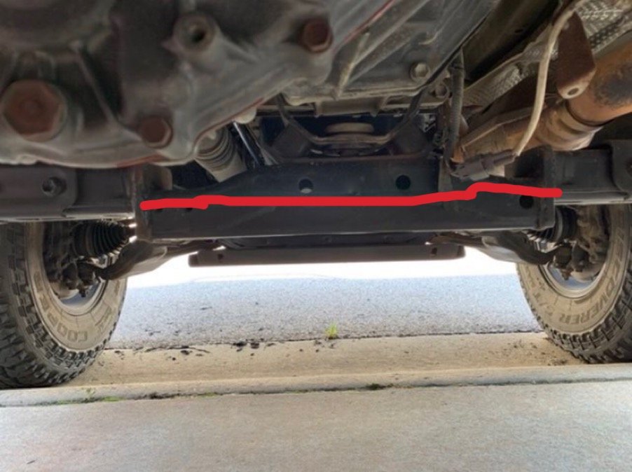

    @jowybyo whats your crossmember look like? 1/2 lower and 1 inch forward?

    I did a shitty job 5 yrs old when I made it so it does look great. But I think I only had to lower it. I think it needed to be 1-1/16" lower. I don't think it had to move forward or back at all.

    Oh really? Interesting, i guess the v6 trans is a good bit different then. so literally just moved it down. Did you just mock it up under the truck to see how everything lined up then make the cut?

    Ive seen 1/2inch down and 1inch forward but i think that was for v6 trucks

    Nope. I measured a 4x4 ACLB truck at work when no one was looking. Determined it was 1-1/16"... cut, weld, done. It fit close enough to work. I'd encourage you to double check that measurement though. It's been a long time and I didn't write it down, so it's purely from memory.

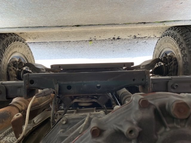

    I just ran outside and measured my truck. Turns out I suck at laying it out. It ended up at about 1-1/8” down. Not forward/backward adjustment needed. Don’t make fun of my crossmember. I know it’s not great.
    Damn it. I hate how some photos from the iPhone are upside down.

    Thanks man! Thats interesting. Ive seen multiple people say it needs to be moved forward.

    i just got dizzy looking at this

    much better. Now I kind of know what Im looking at

    I think I’m going to cut mine here so I don’t lose ground clearance l.
