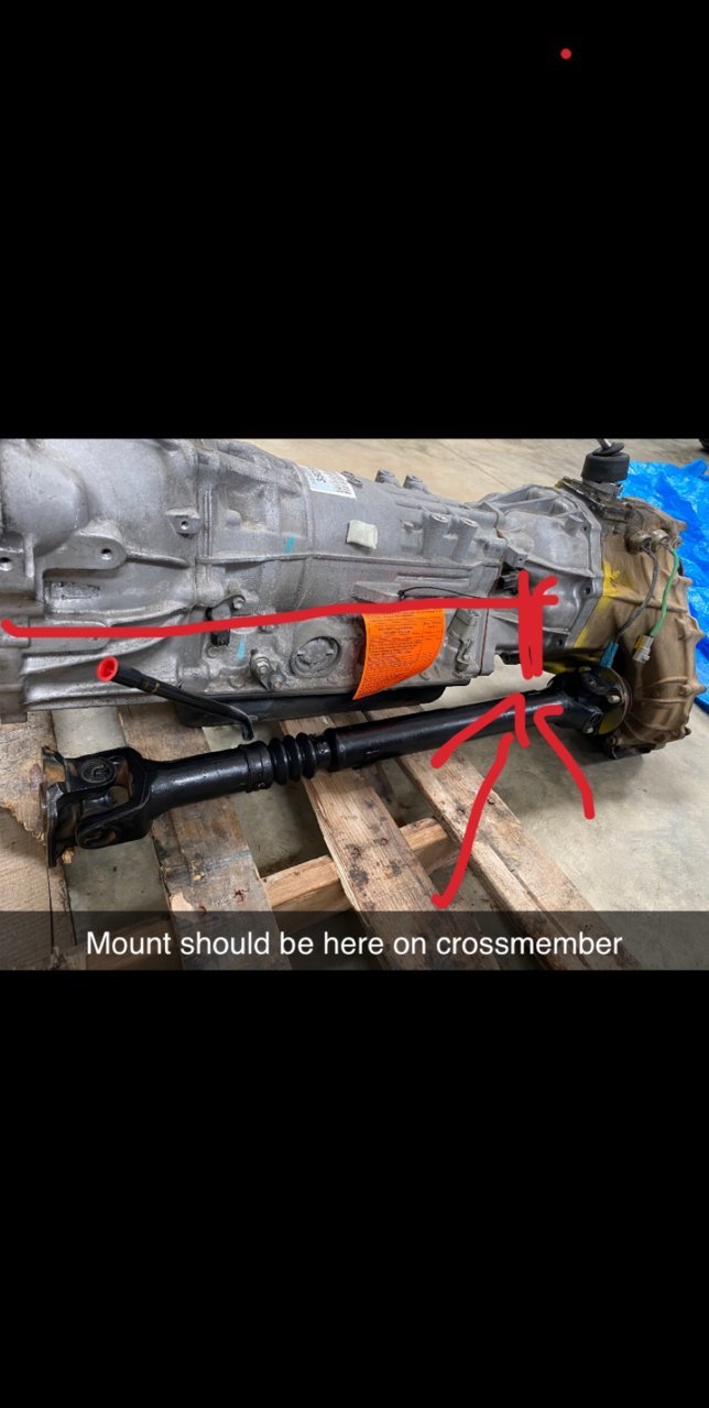

    How confident are you in that 1-1/8inch measurement? Is your trans sitting perfectly level? Do you know the length by chance from where it mounts to engine to center hole of trans mount? Im just going to cut mine and go from there if it needs adjustment.

    100% sure it's supposed to be 1-1/16", but we're just splitting hairs now.
    Hard to say. There's not a great reference point to judge level from. It's pretty level though and I have 125k miles since my conversion so it's not causing any fluid issues yet.
    Not sure what you're asking.

    distance of the red line

    It’s pretty much the same as your stock truck. I can see from the way I modded the cross member that all I did was move the center section down 1-1/6”. It lined up front/back with the rest of the crossmember, just lower.

    awesome im just gonna take it to my uncles machine shop and modify it. My trans mount will be here Friday so i think im going to take the trans out of my truck maybe this weekend and try to get the cross member made.

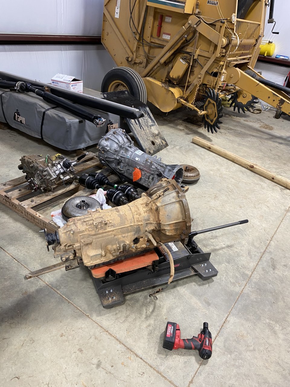

    Here’s that inch difference. @jowybyo
    where is the trans fill plug btw? I was looking but didn’t see it?

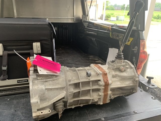

    Just picked up this. From a 3rd gen. Has a lower 1st gear than the 2nd gen. Only 16k miles on it.

    Nice! That's gonna be sweet. Is it 5 or 6 speed?

    5-speed. Basically the same as the 2nd 2.7 manual but with a lower 1st gear (4.33 vs 3.95).

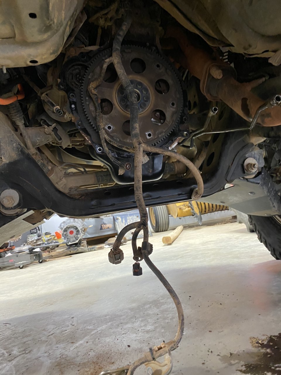

    Pulled trans. Fabbing crossmember tomorrow

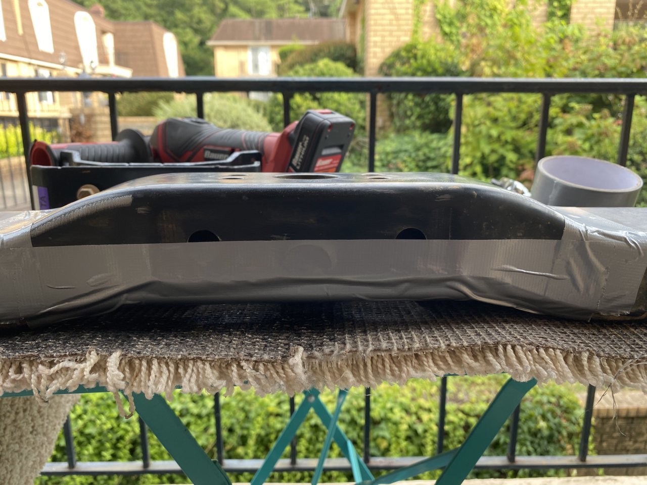

    Made my measurements now just to cut. 1-1/16 of an inch. Rewelding plate with gussets in Center
