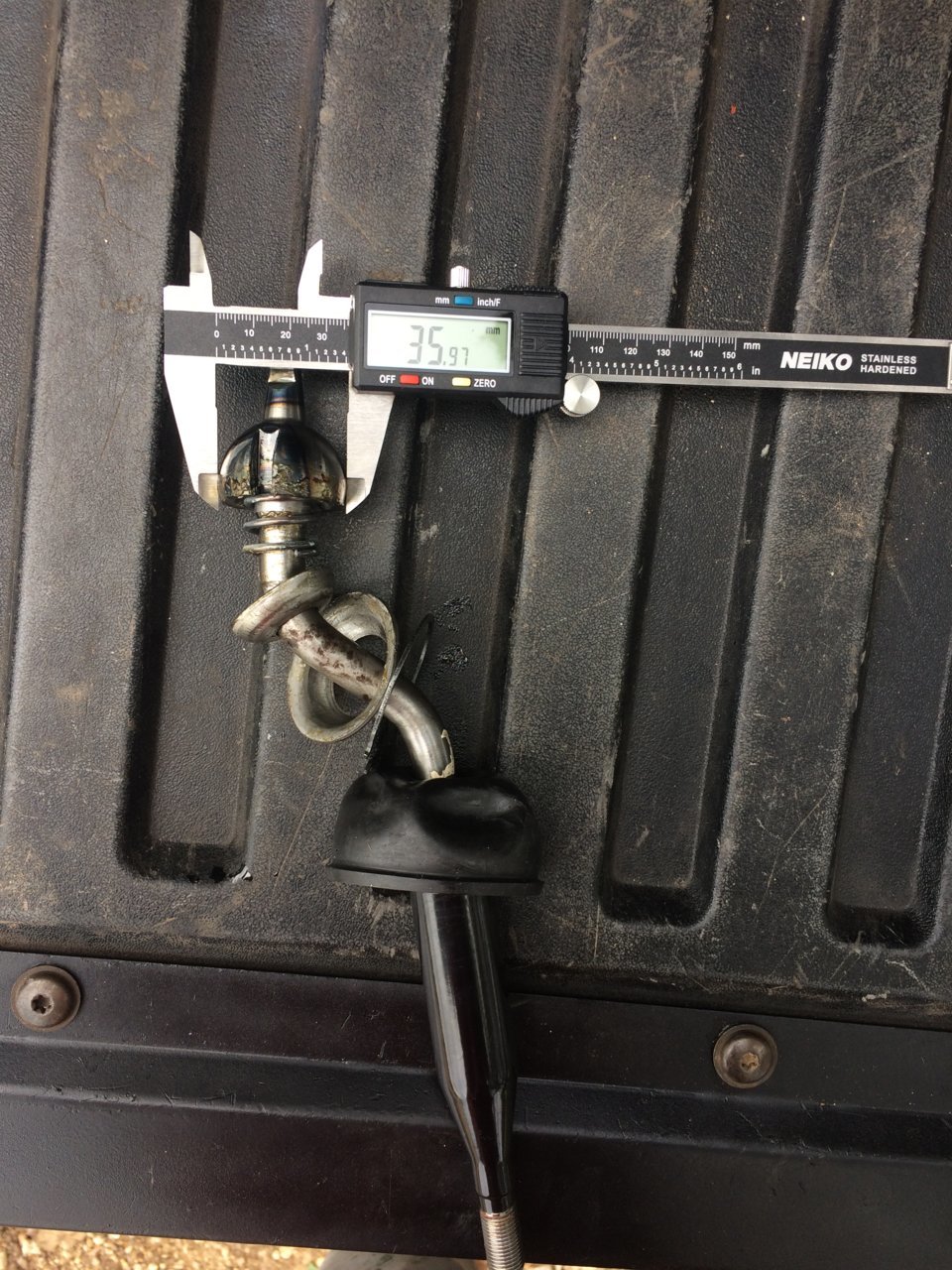

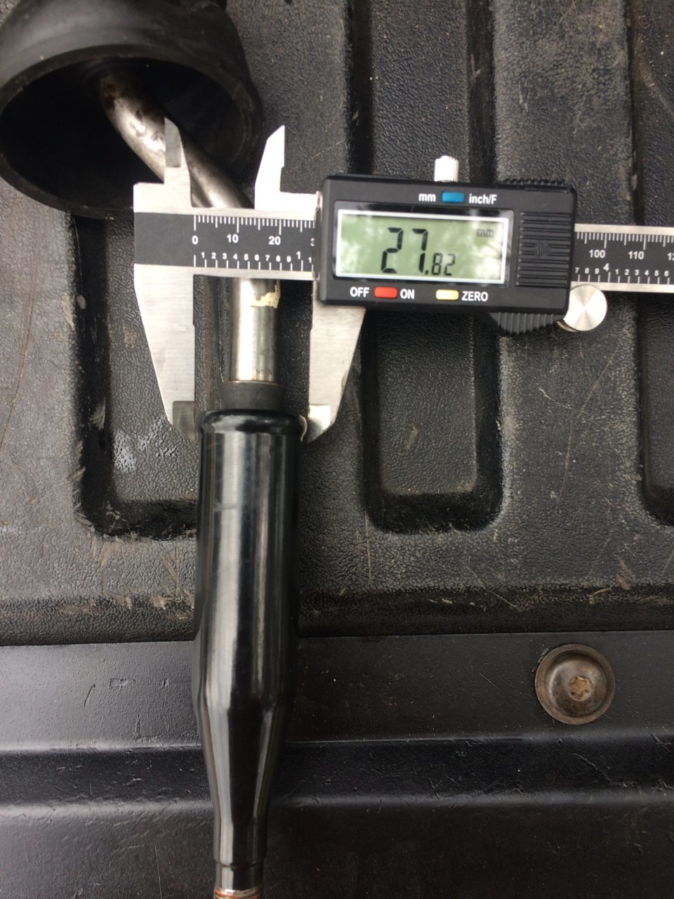

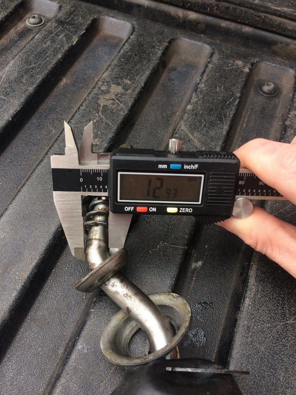

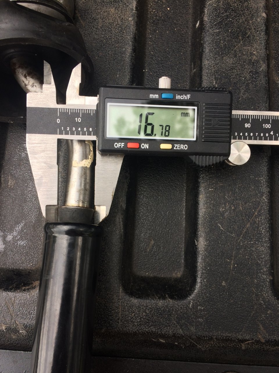

    I hope one of those is helpful, just put the truck back together:D

    Yay! Yes helps a lot! Looks like 1/2inch! Glad the trucks working! What’s up with your supercharger?

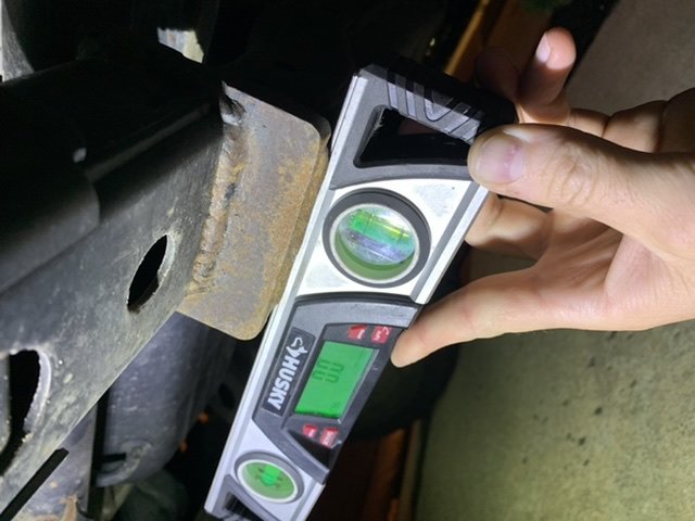

    @BassAckwards so it looks like the top of the trans crossmember is slanted a .25 inch on my trans can you look and see if it’s the same on your 4wd? Or is it flat?

    Yea the front or towards the front of the truck on the prerunner is a .25 inch lower than rear towards transfer case

    Use the bottom of the cross member as the datum so it doesn’t matter what angle the top is at.

    It makes it more tricky for me than just dropping the center section down because it’s slanted it looks like. But on some one the other conversions it looks like it hey didn’t take that into consideration. My uncle stress test metals for a living and he says you want to make sure or you could have issues down the road so I want another opinion.

    Yea. I have no idea what you are really talking about. The bottom of the cross member is flat. I just dropped the center drop 1-1/16". Everything bolted up fine and I've been running it that way for over 100k miles now.

    It’s not flat. It may look flat underneath the truck but it’s actually slanted ever so slightly. We measured with micrometer in my uncles machine shop and confirmed it.
    you dropped yours in a different fashion than I’m dropping mine so makes sense it wouldn’t make much of a difference.
    I was thinking maybe it was flat ontop of a 4wd crossmember but idk.

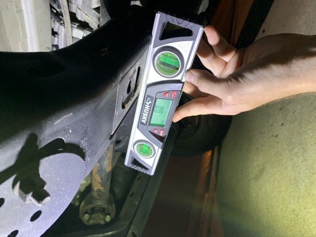

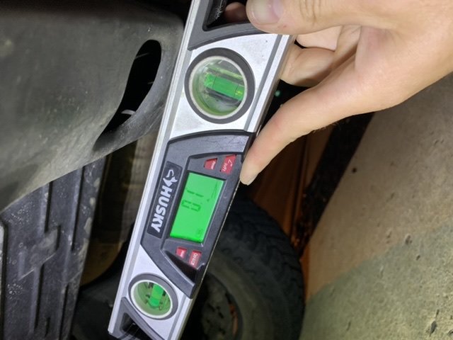

    On mine there is a flat section in the middle.
    Out at the edge of the cross member near the frame bracket
    Just inside of where I cut:
    At the very center of the cross member:
    The 0.1° is only cause I wobbled a little as I took the picture. It’s close enough to flat that you’d need a dial indicator to notice the difference.
    I can’t say for sure what the top surface is like so that might come into account with the way you are modding the CM. But it doesn’t have to be perfect. The trans mount is pretty flexible. Just has to be close enough to bolt up. You could bolt the mount to the trans and to the section of the CM that you cut out. Then get the trans at the angle you think looks good. Tack everything in place then pull it out and finish weld the CM.

    Yea I was taking about the top portion. It is ever so slightly slanted front to back. It’s .25 of an inch difference. Side closest to the grinder in the pic is lower
    the crossmember itself is not slanted just the top plate section!

    Do you have a digital level? You can use that to zero on the top surface. Then you should be able to get it back in at the same angle. Should be able to get that close enough.
