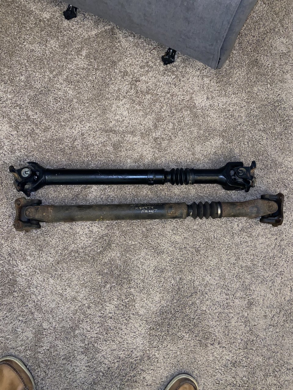

    Well well well. You were right!
    BassAckwards likes this.
  2. Aug 13, 2020 at 11:26 AM
    #402
    jowybyo
    jowybyo Well-Known Member
    Nov 19, 2013
    #116863
    6,092
    Joe
    Baltimore, MD
    '14 MGM DCSB Postrunner 4wd Conversion, Debadged
    HA! I’m always right.
    Are you able to collapse the auto version to be the same length as the manual? This would be good to know for my auto to manual swap.
    Brian422[QUOTED][OP] likes this.
  3. Aug 13, 2020 at 11:38 AM
    #403
    Brian422
    Brian422 [OP] I fell into the pit that is TW
    Jun 8, 2011
    #57958
    15,657
    Brian
    Birmingham, AL
    2012 DBCSB F/R Locked, 35's ,Long travel, 23 Tundra 4x4 limited
    Not Stock
    No, your not going to have enough spline exposed. Good news for you i have one!lol
  4. Aug 13, 2020 at 11:39 AM
    #404
    jowybyo
    Nov 19, 2013
    #116863
    6,092
    Joe
    Baltimore, MD
    Damn it. How much? I’m thinking of just shortening mine.
  5. Aug 13, 2020 at 11:42 AM
    #405
    Brian422
    Jun 8, 2011
    #57958
    15,657
    Brian
    Birmingham, AL
    Not Stock
    $100 shipped most likly depending on what shipping cost but id image it shouldn't be bad. Basically $80 plus shipping.

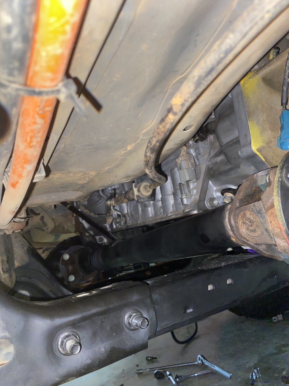

    So, how far did you get with your shifter today?
  7. Aug 16, 2020 at 5:11 PM
    #407
    Brian422
    Jun 8, 2011
    #57958
    15,657
    Brian
    Birmingham, AL
    Not Stock
    It’s not engaging right. Idk why I managed to engage it back into 2wd but it’s not engaging into 4wd hi or low without a lot of attempts. Not sure what’s going on. Maybe @jowybyo knows?
  8. Aug 16, 2020 at 5:20 PM
    #408
    cubie
    cubie Aznrednek
    Jan 9, 2019
    #278739
    14,676
    Jonny
    Sweet home Alabama
    '06 and '18 TRD OR 4x4 Access Cab
    Damn, I figured you would have finished it up today. Is the shifter going in far enough?
  9. Aug 16, 2020 at 5:38 PM
    #409
    jowybyo
    Nov 19, 2013
    #116863
    6,092
    Joe
    Baltimore, MD
    Are you using an FJ transfer case?
  10. Aug 16, 2020 at 5:51 PM
    #410
    Brian422
    Jun 8, 2011
    #57958
    15,657
    Brian
    Birmingham, AL
    Not Stock
    Yes
  11. Aug 16, 2020 at 5:53 PM
    #411
    Brian422
    Jun 8, 2011
    #57958
    15,657
    Brian
    Birmingham, AL
    Not Stock
    Yes idk what’s going on. It’s shifting but after I spend like 3-4 min of trying to get it from4l to 2wd. Somethings not right. It’s was working right before we took it out.

    So you can’t actually move the shifter into 4wd? How do you know it’s not in 4wd?
    cubie likes this.
  15. Aug 16, 2020 at 6:22 PM
    #415
    jowybyo
    Nov 19, 2013
    #116863
    6,092
    Joe
    Baltimore, MD
    If you can move the shifter to 4WD then check to see if the front driveshaft is spinning as you creep forward (might need another person to help). If it’s not spinning then something is up with the t-case. If you can’t move the shifter, I’d got back and look at how you reassembled the shifter (is the end of the shifter in the right place, is the stick getting hung up on anything, etc).
    If the front driveshaft is spinning, but the wheels don’t seem to be, then it’s the front ADD actuator.
  16. Aug 16, 2020 at 6:33 PM
    #416
    Brian422
    Jun 8, 2011
    #57958
    15,657
    Brian
    Birmingham, AL
    Not Stock
    It does go into 4wd. Gets stuck in 4wd actually. Hard to shift back into 2wd
  17. Aug 16, 2020 at 6:33 PM
    #417
    Brian422
    Jun 8, 2011
    #57958
    15,657
    Brian
    Birmingham, AL
    Not Stock
    Driveshafts spin!
  18. Aug 16, 2020 at 6:51 PM
    #418
    jowybyo
    Nov 19, 2013
    #116863
    6,092
    Joe
    Baltimore, MD
    I’d double check the assembly of the shifter.

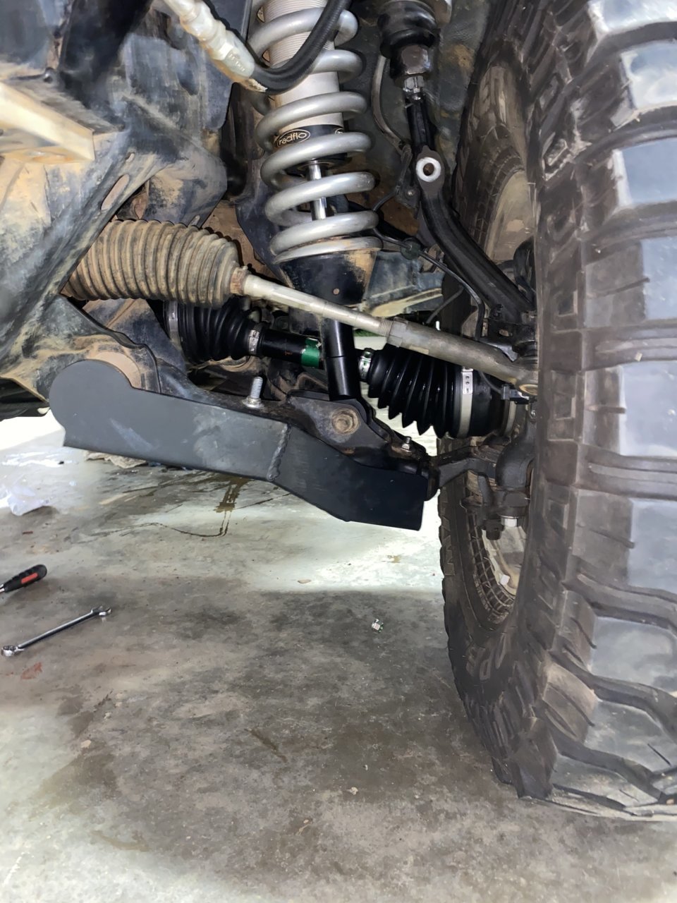

  20. Aug 16, 2020 at 7:09 PM
    #420
    Brian422
    Jun 8, 2011
    #57958
    15,657
    Brian
    Birmingham, AL
    Not Stock
    Got my cv’s and front driveshaft in
