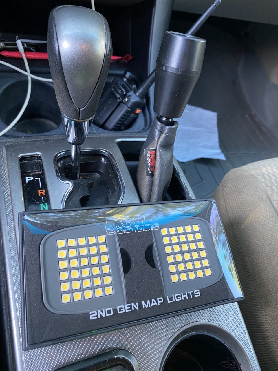

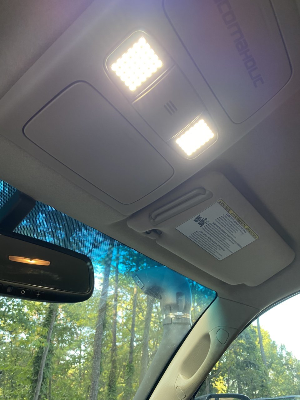

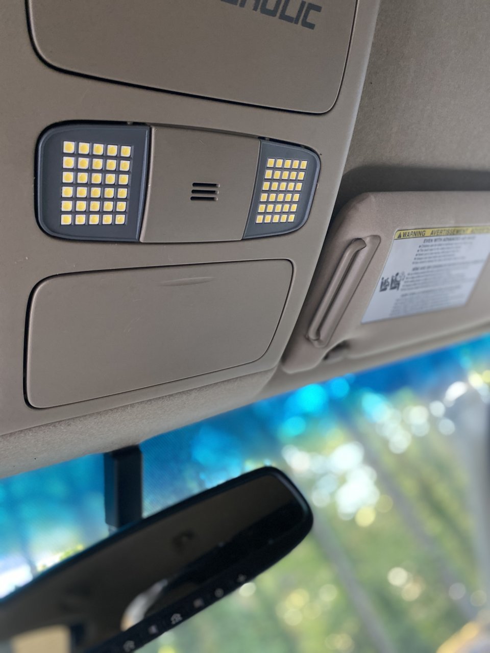

    Installed MESO map lights! Dome lights coming soon.

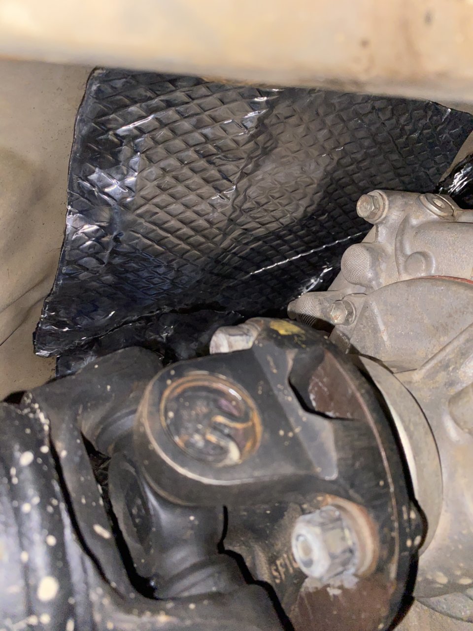

    Sound deadened the trans tunnel to help with the noise.....

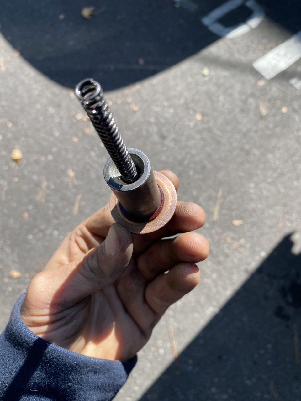

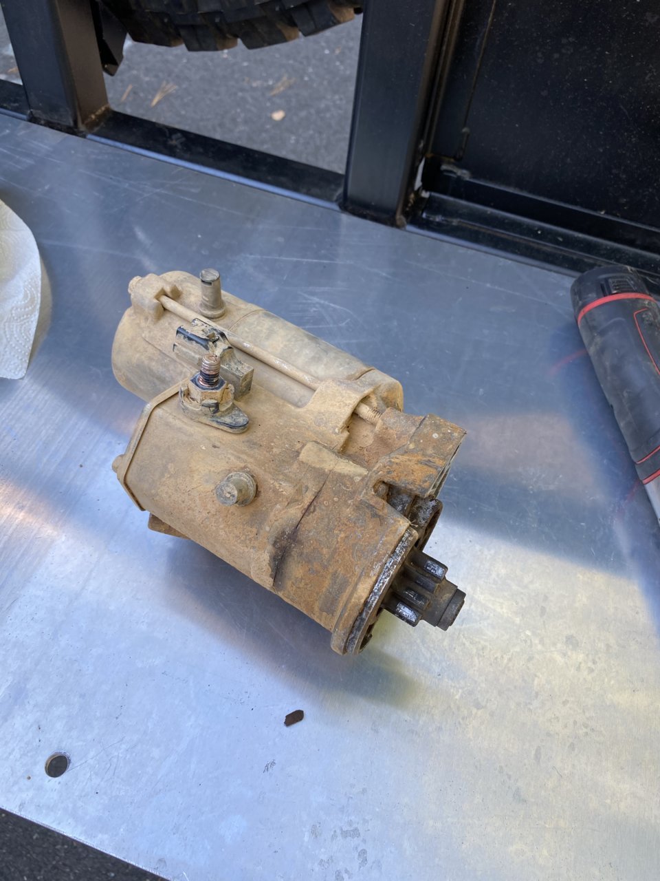

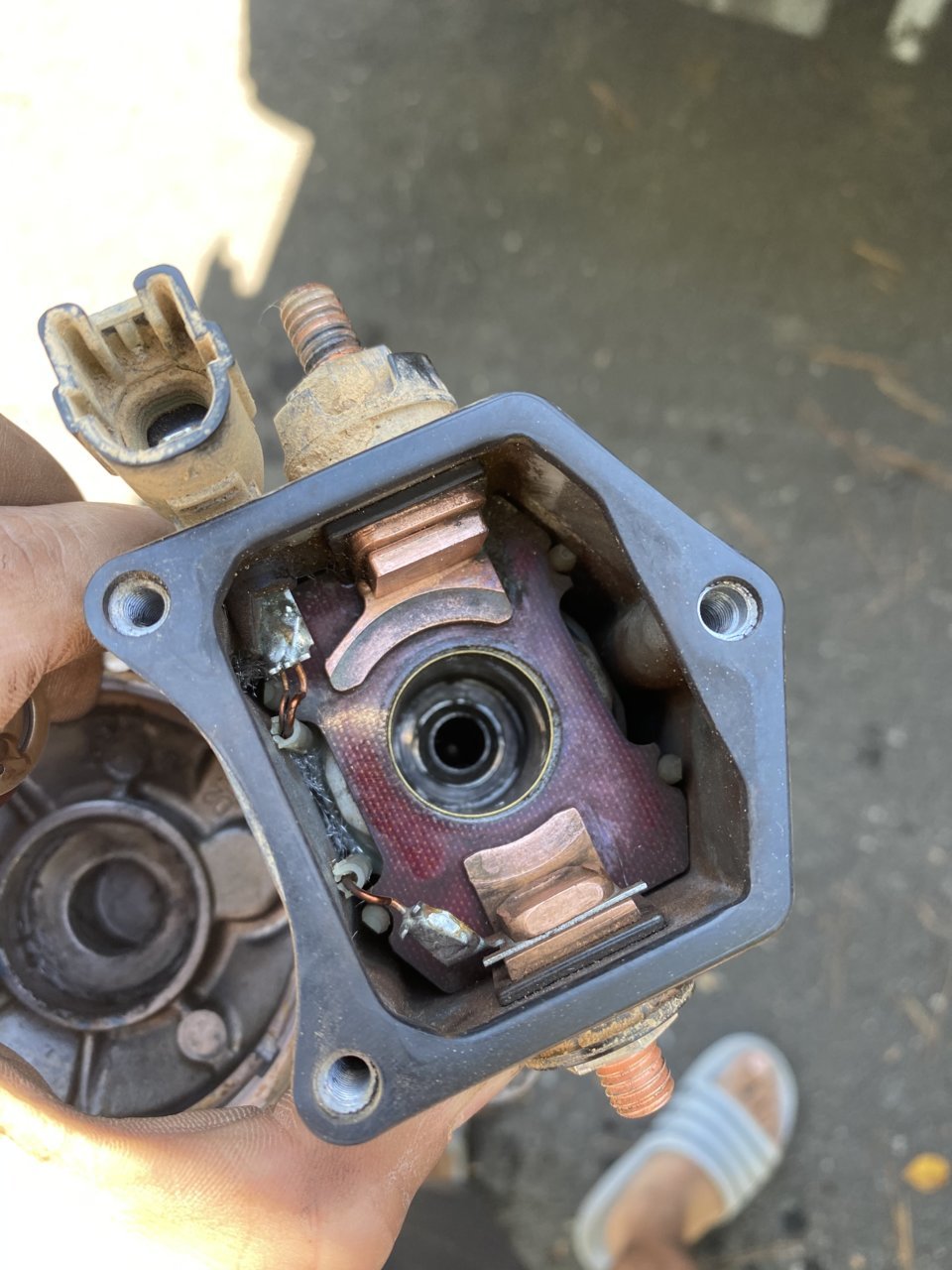

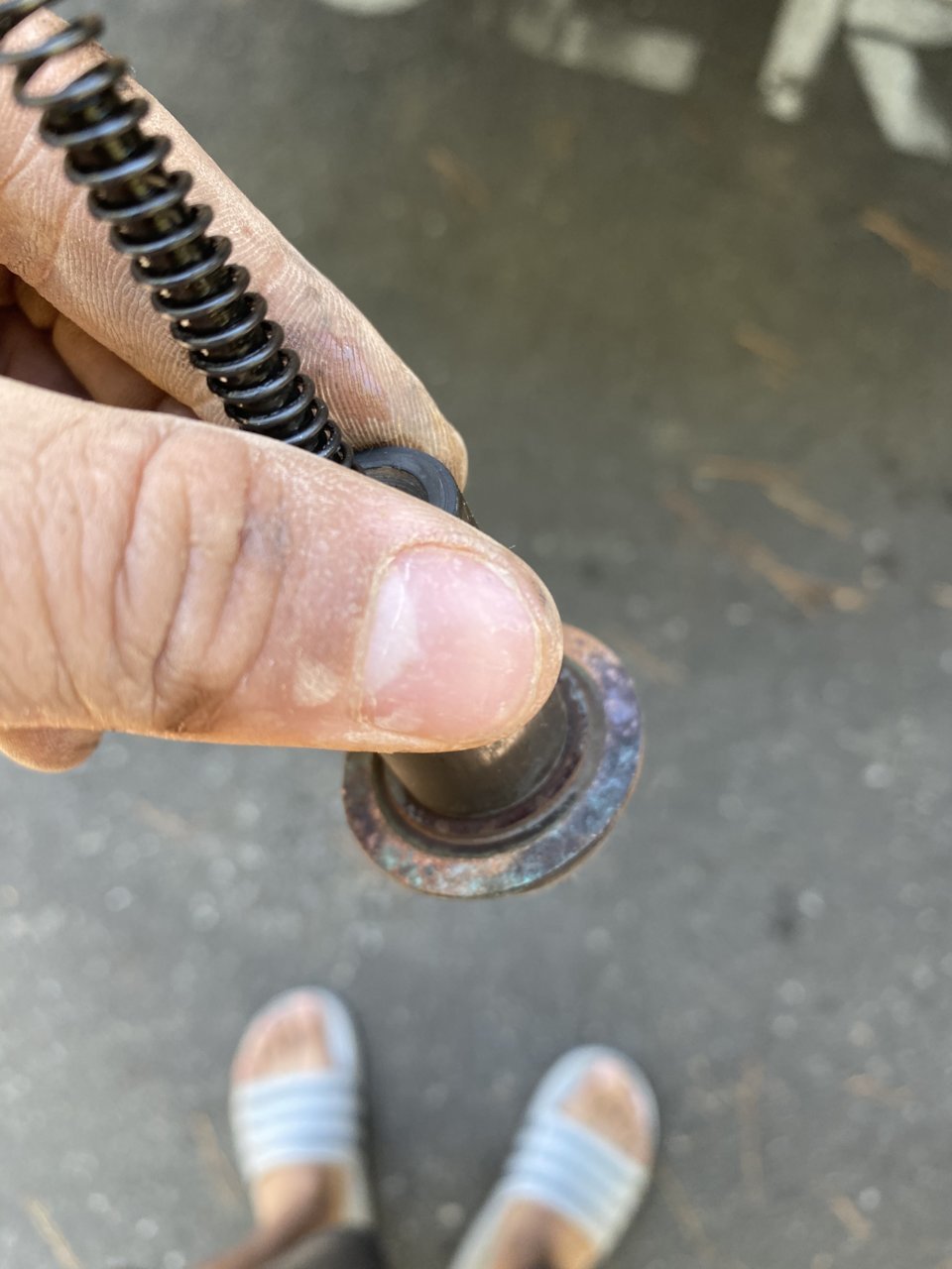

    Starter was acting up on me so I pulled it and cleaned it up. Works good as new now.

    Walk us through what you did here. Did you replace the brushes? I’m not sure what we are looking at in the photos.

    Opened the housing. Cleaned the copper contacts inside the main hosing. Cleaned the plunger copper ring as well. I used madd air flow sensor cleaner on the whole thing. Greased the gears as well.
    nothing was replaced, just cleaned.

    Thanks, after my last trip my starter started acting up. Reallly slow cranks with clicking. We went through a lot of water so I think it corroded the contacts pretty bad. Now it’s all good again.

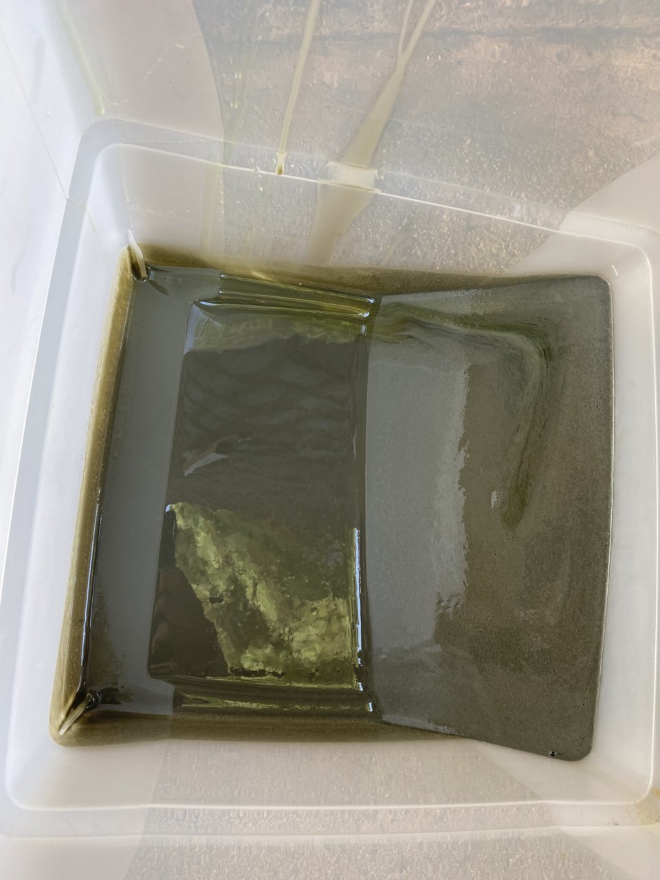

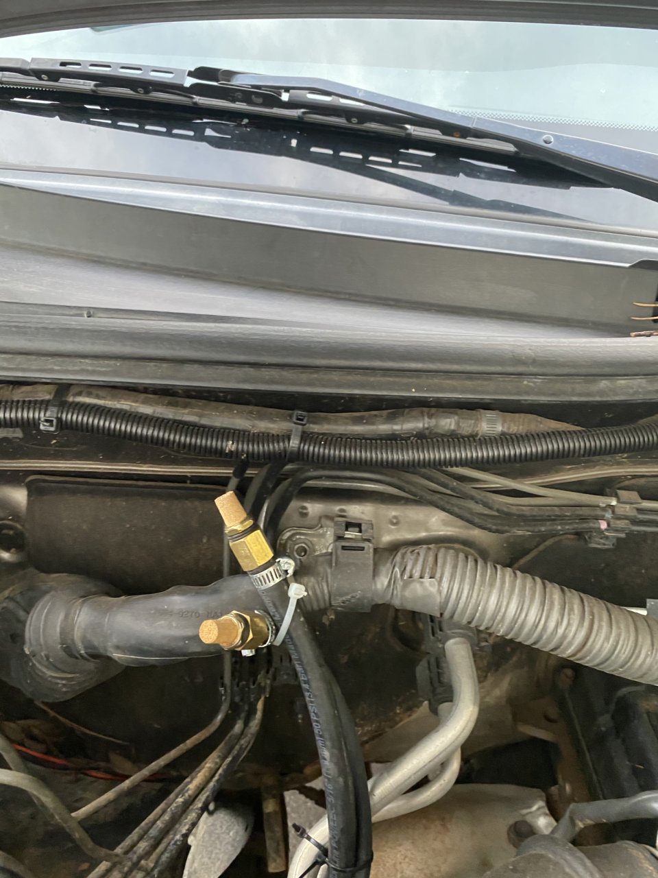

    Did a good bit of work on the truck this weekend. Fixed my starter, changed diff fluid and glad I did cause water had leaked Through breather hose. Relocated breather line. Switched out my LED high beams. Also wired my top light at back up.

    Did you just do the rear diff? What made you want to change it out? It’s almost time for me to do my front/rear/transfer case fluids again too.

    No front diff, i changed it because of break in period. Im going to check my rear diff this week but nothing probably got in there.
