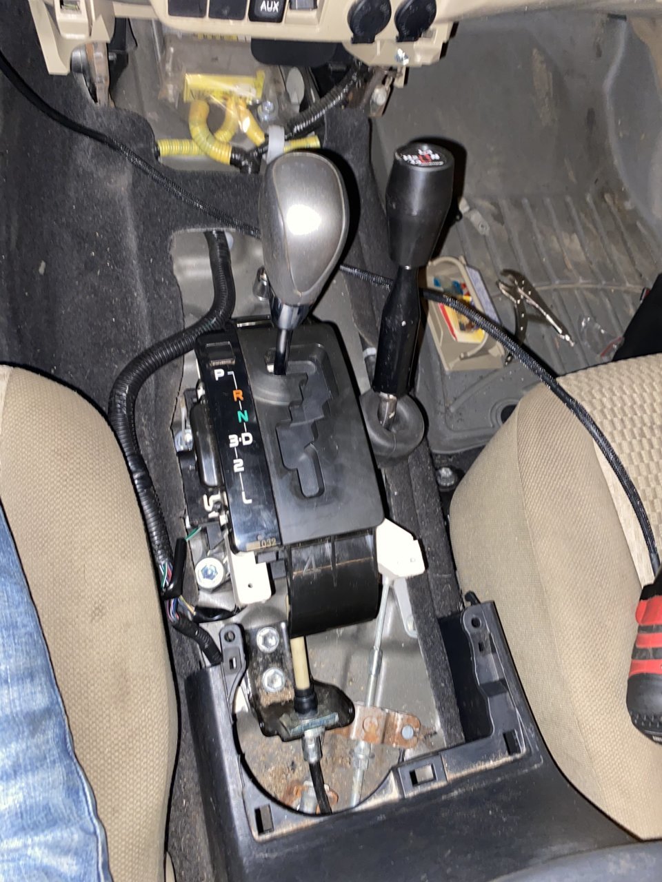

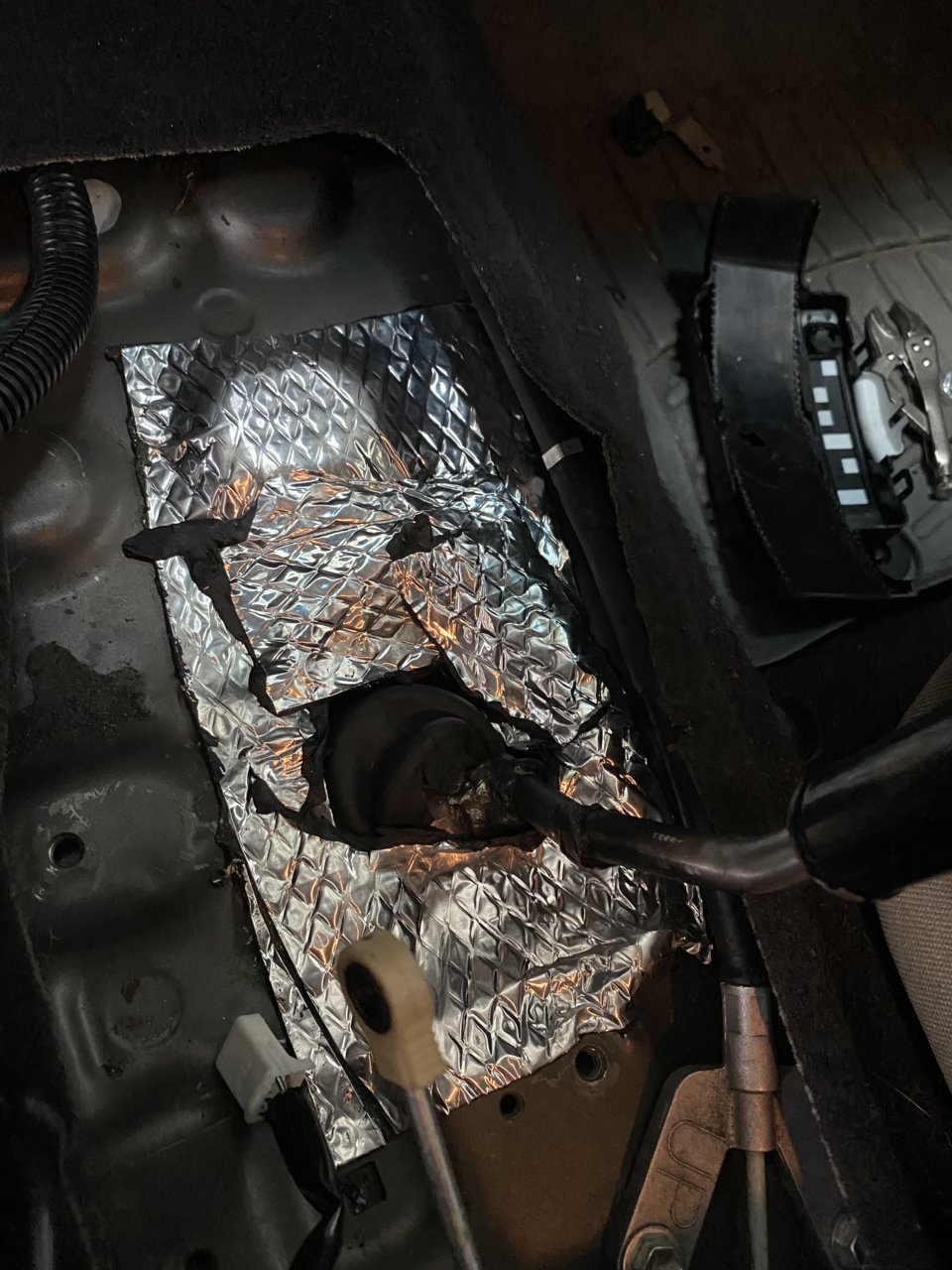

    Thanks! How much clearance is there between the shifter and the auto trans shift assembly?

    My setup the trans shifter actually slightly touches the tcase shifter because I got tired of unwedinging grinding and rewelding. That part by far took the longest to get it lined up right. But everything clears!
