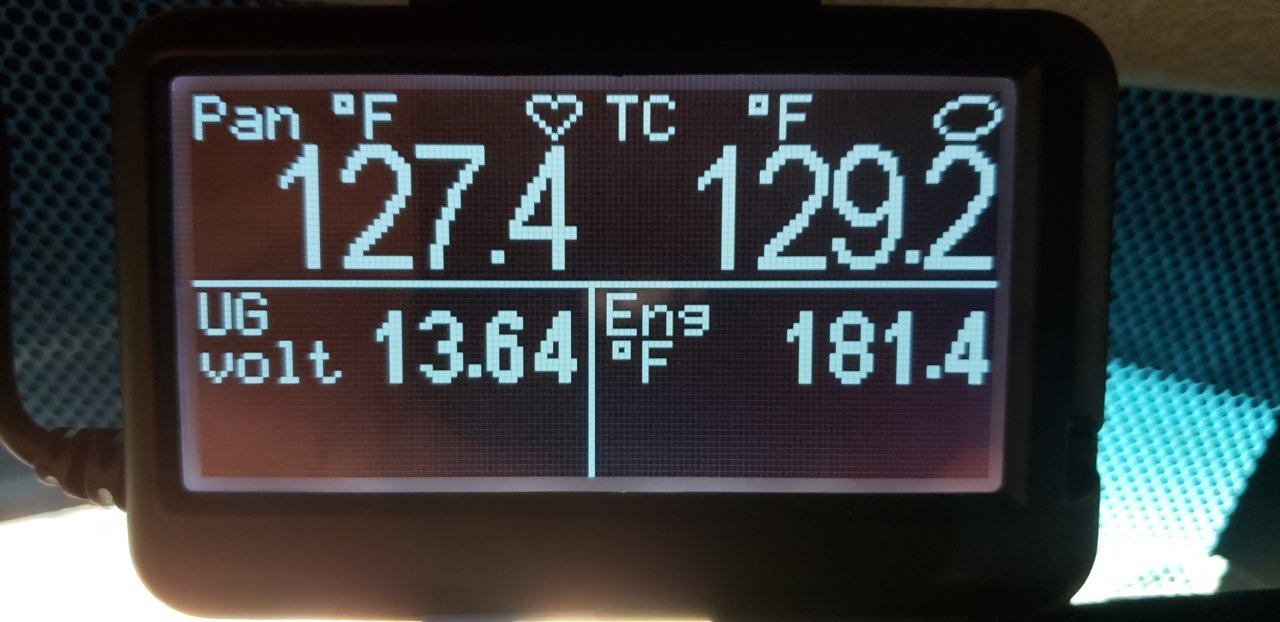

    I will look for the thread I followed. I set mine up for Eng temp, trans temp(at the pan and tq converter), , and voltage.

    If I remember correctly, I had to change one of the numbers. Call me on my next off stretch(at work until next Thurs) and I will look at what numbers I used to set it.

    Did I take this pic? If so, I'm impressed with myself :rofl: I'm bored at work and reading threads :rofl:

    yep you did, I think lol
