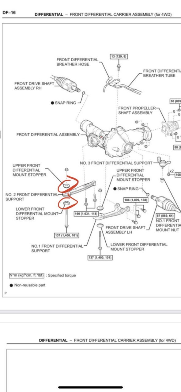

    I circled 2 parts in the diagram, which one of those did you leave off? I want to make sure I don’t do the same:rofl:

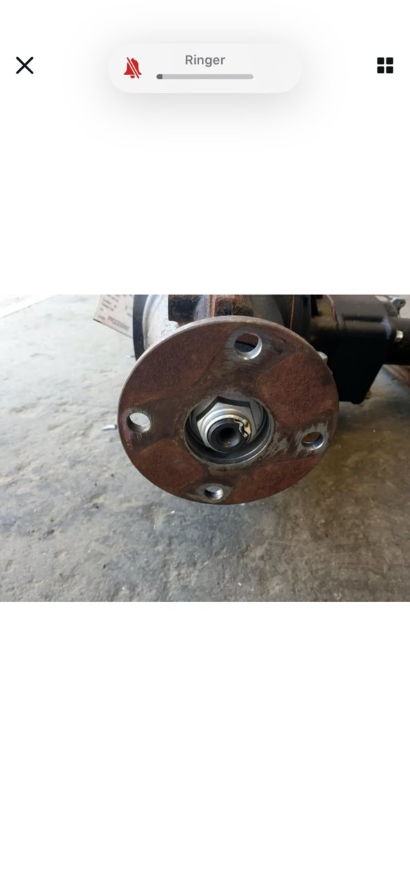

    Also I’m about to buy this front diff, it comes with mounting arms but there’s this gash where the driveshaft mounts up. It doesn’t look serious, just wondering if anyone think it would cause problems?

    LOL I left both of those off! Don’t ask me why I’m an idiot LOL!
    As far as a gash is concerned it’s actually supposed to be there you’re supposed to Peen over the nut right there so the nut can’t back off it’s designed to operate like that

    The stopper on the bottom is the most crucial as that prevents the bushing from ripping and falling down around the bolt.

    Yeah I think it was me and Jeff that went over that with you when you had your failure

    Cost me 2 cv and a new mount. Thank goodness that was all!

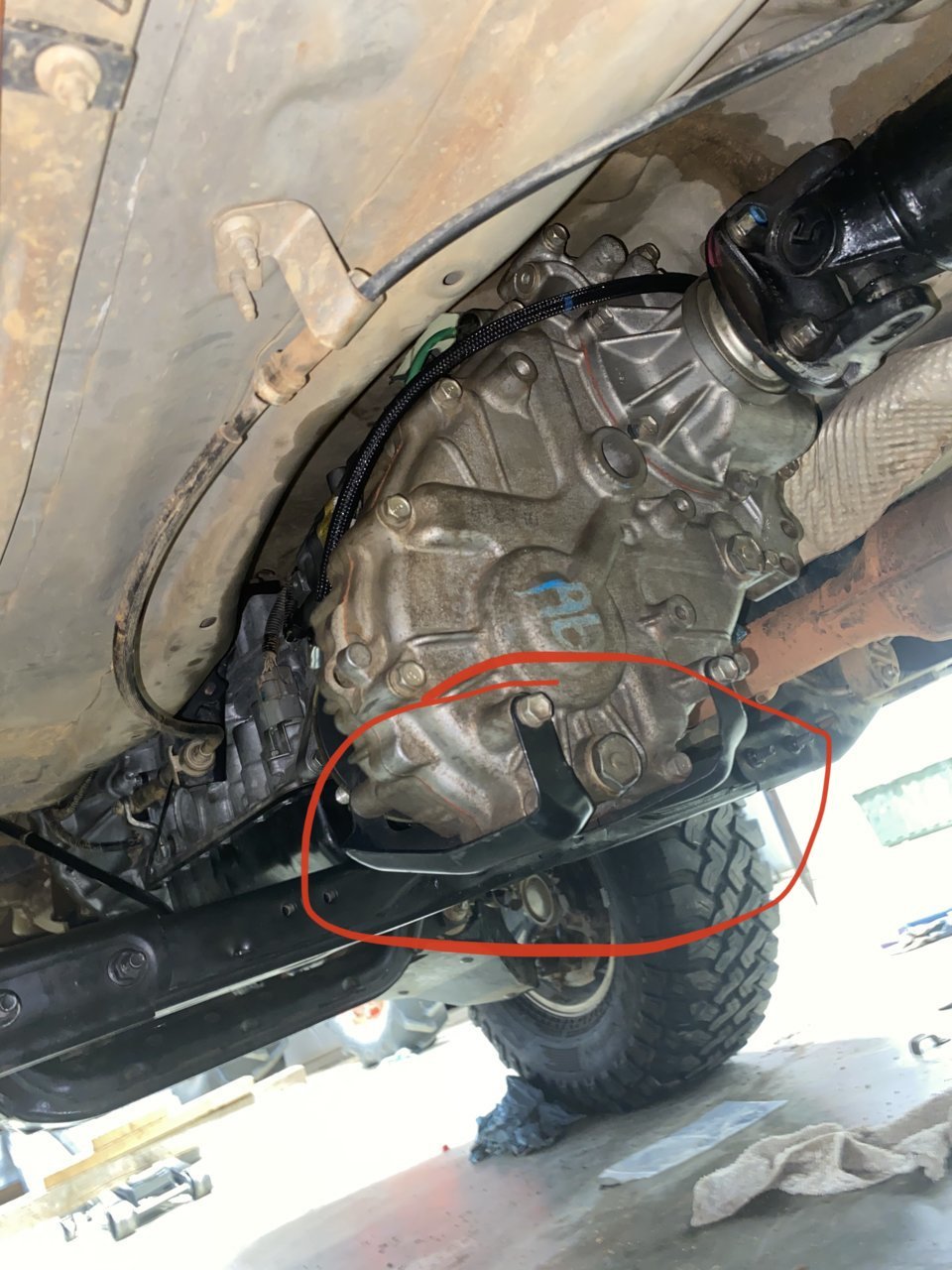

    This is your pic @Brian422, what is this? Skid plate?
  12. Feb 19, 2021 at 11:04 AM
    #812
    t.hornstra
    t.hornstra Well-Known Member
    Oct 14, 2008
    #9957
    5,258
    Ted
    NorCal
    White with 4 wheels
    Little this. Little that 4x4 Swap’d PreRunner
    factory xfer case skid
    pdaddy[QUOTED] likes this.

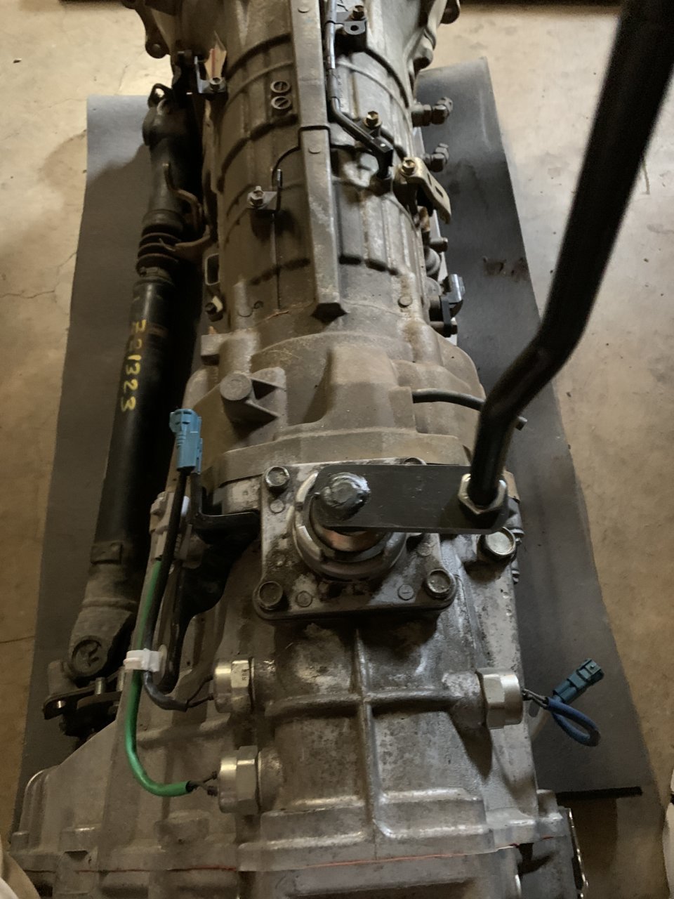

    Nice did the front diff come with mounts? Also tcase come with shift lever? The circled part is factory skid.

    I called Benzeen and they said it comes with everything in the pic so we’ll see, should be 2 arms and even the breather tubes. I couldn’t find a t case with a shifter in the past few weeks I’ve been looking so I’ll just order it separate

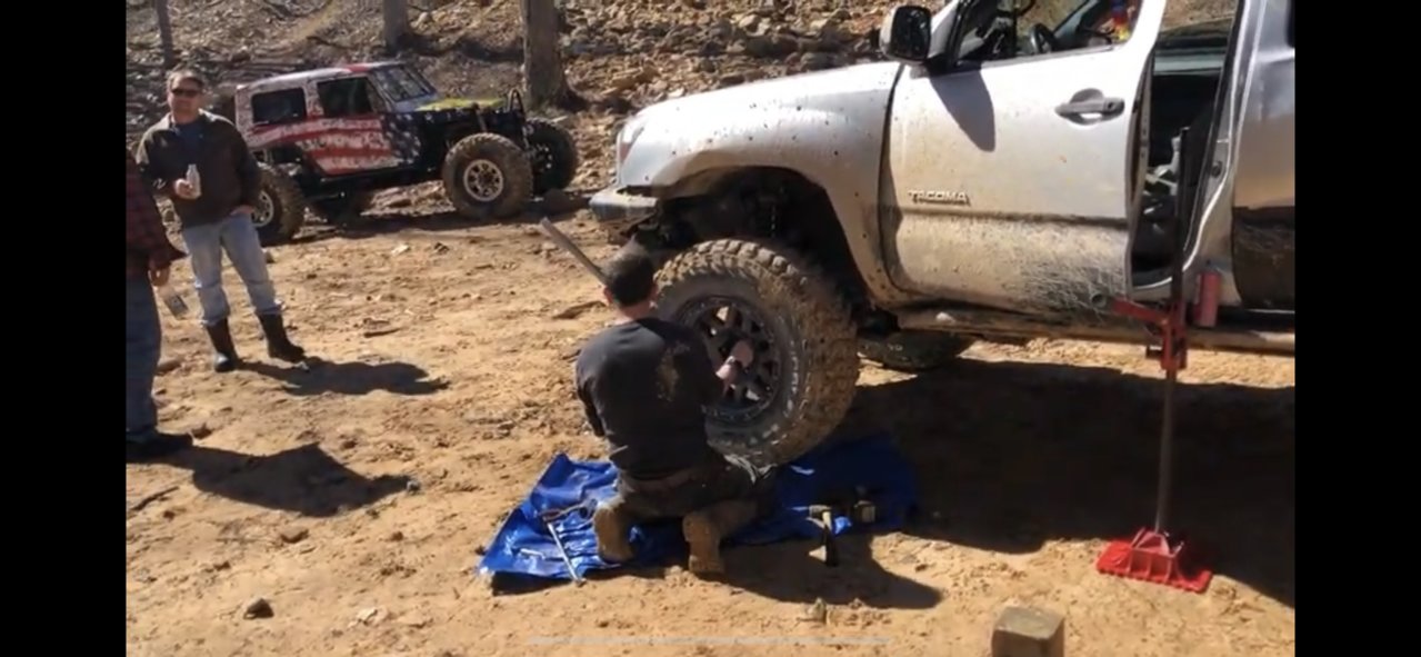

    Here some pics. Also helped @ovrlndkull limp home after he blew out his rear diff and broke a cv:angrygirl:

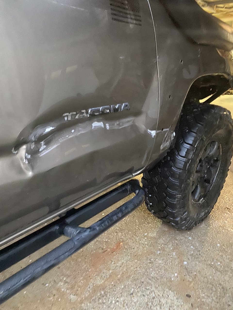

    lol it was a dumb root popping out the side of a ditch. The side wall on the ditch kept giving out and i kept rubbing up against the wall.
