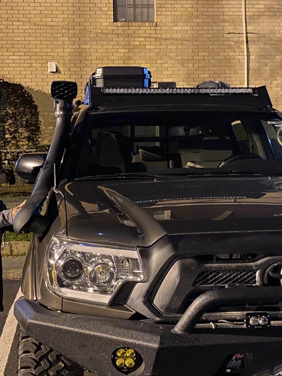

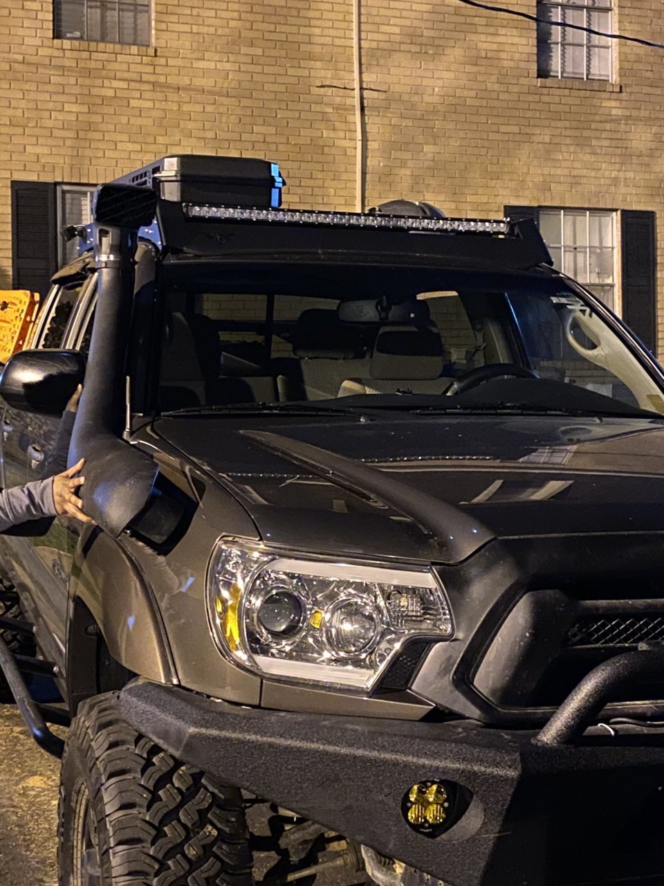

    [​IMG][​IMG]
    Snorkel installed!

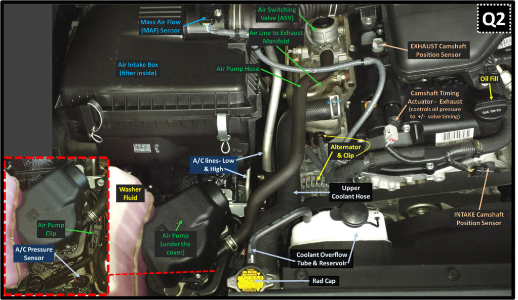

    thats definitely a strange assortment.. i have no idea what the other c1420 is relating to. The others seem kinda random as well though. You might go through your engine bay and check the main wire harness and make sure nothing looks damaged or out of the ordinary. Also would be a good idea to check all the connections for the harness in the engine bay and make sure nothing is loose.
    - P0010 "A" Camshaft Position Actuator Circuit - check out pic below i think its the camshaft timing actuator. id clean the connections with some contact cleaner on that one and the intake camshaft position sensor.
    - P0113 Intake Air Temperature Circuit High Input -
    - P1605 Knock Control CPU- id pull out your glove box for this one and behind it is the ECU. Id make sure that all the connections are tight. Might be a good idea to unplug and clean the connectors on the truck harness as well. They are all plug specific, so you cant hook them up incorrectly, makes it super easy. Electrical contact cleaner works good for this too, ive done this a few times without issues on my truck.
    Heres a pretty cool thread with an engine bay guide for our 2TR
    https://www.tacomaworld.com/threads/engine-bay-guide-for-the-2tre-fe-2-7l.534478/
    Are you running the stock intake box sealed off for the snorkel? And are there any other drivability issues besides the rough idle/stall? Make sure the ground cable near the battery is also clean and tight.. hope you get this sorted out man
