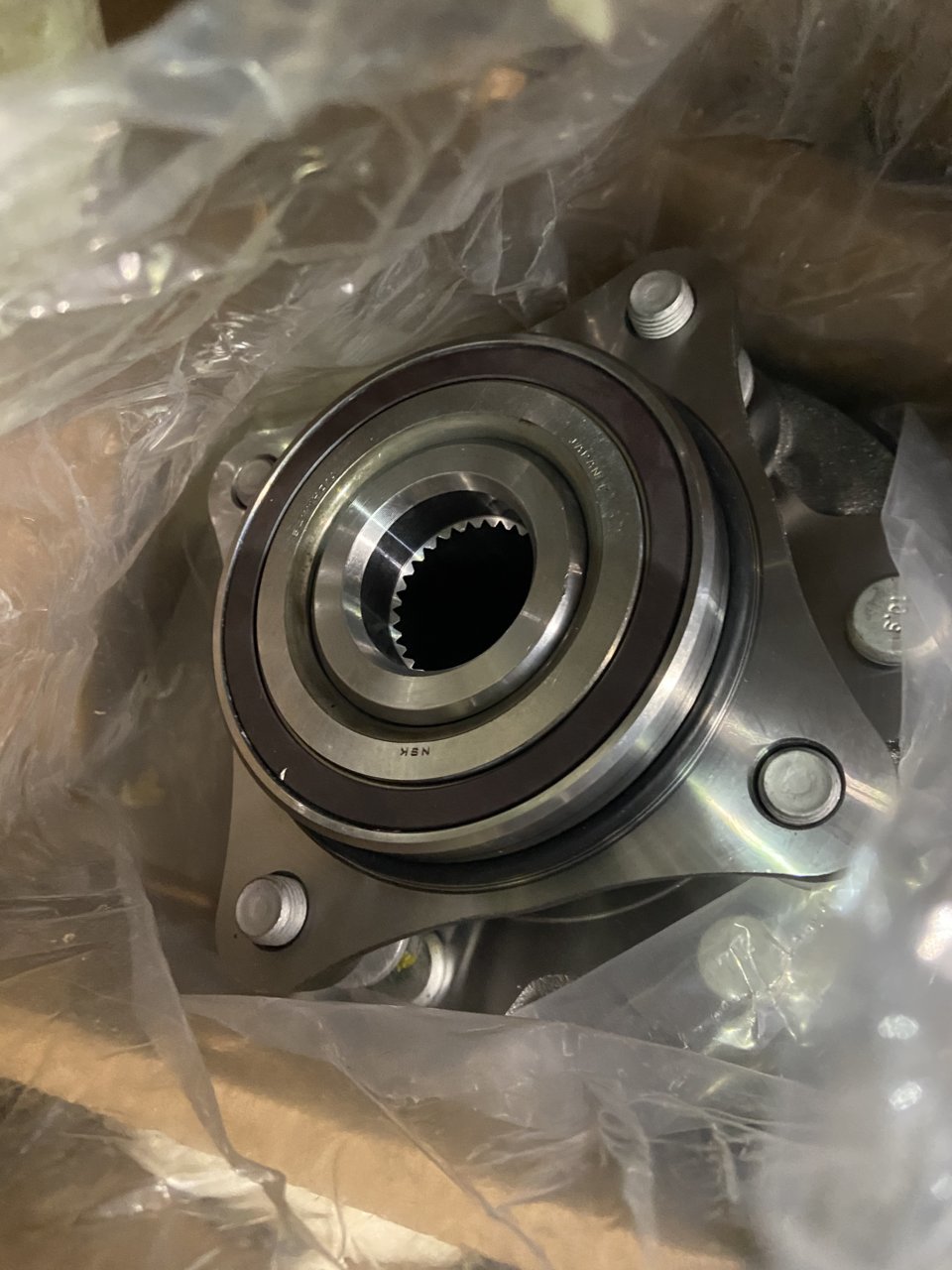

    Want to make sure I’m doing this right. I’m putting wheel bearing grease inside my 4x4 hub, this is right, right?

    No wheel bearing grease is already inside the bearing. So no need to grease again

    Just make sure you have the seal on the back of the spindle and the CV or water will get in there and wear the bearing out very fast.

    Yes I had both seals, locked up good, doubt water will get in. This is too cool to finally see

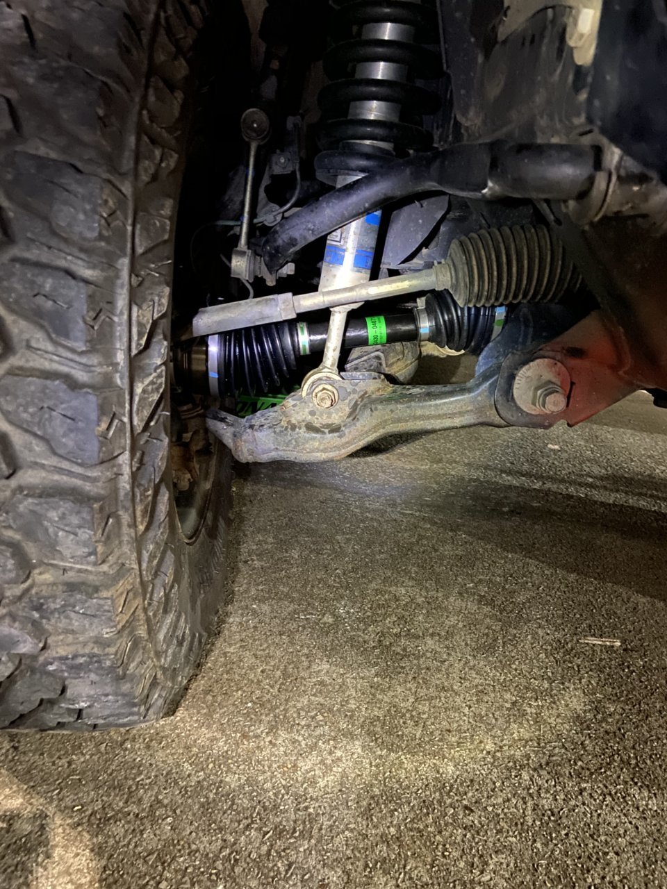

    How did the hub spin when you had cv in with wheel off? Shouldn’t feel any resistance other than weight

    Didn’t really check, probably should

    Also cv should just slide in. It shouldn’t be hard to get it in and out.
