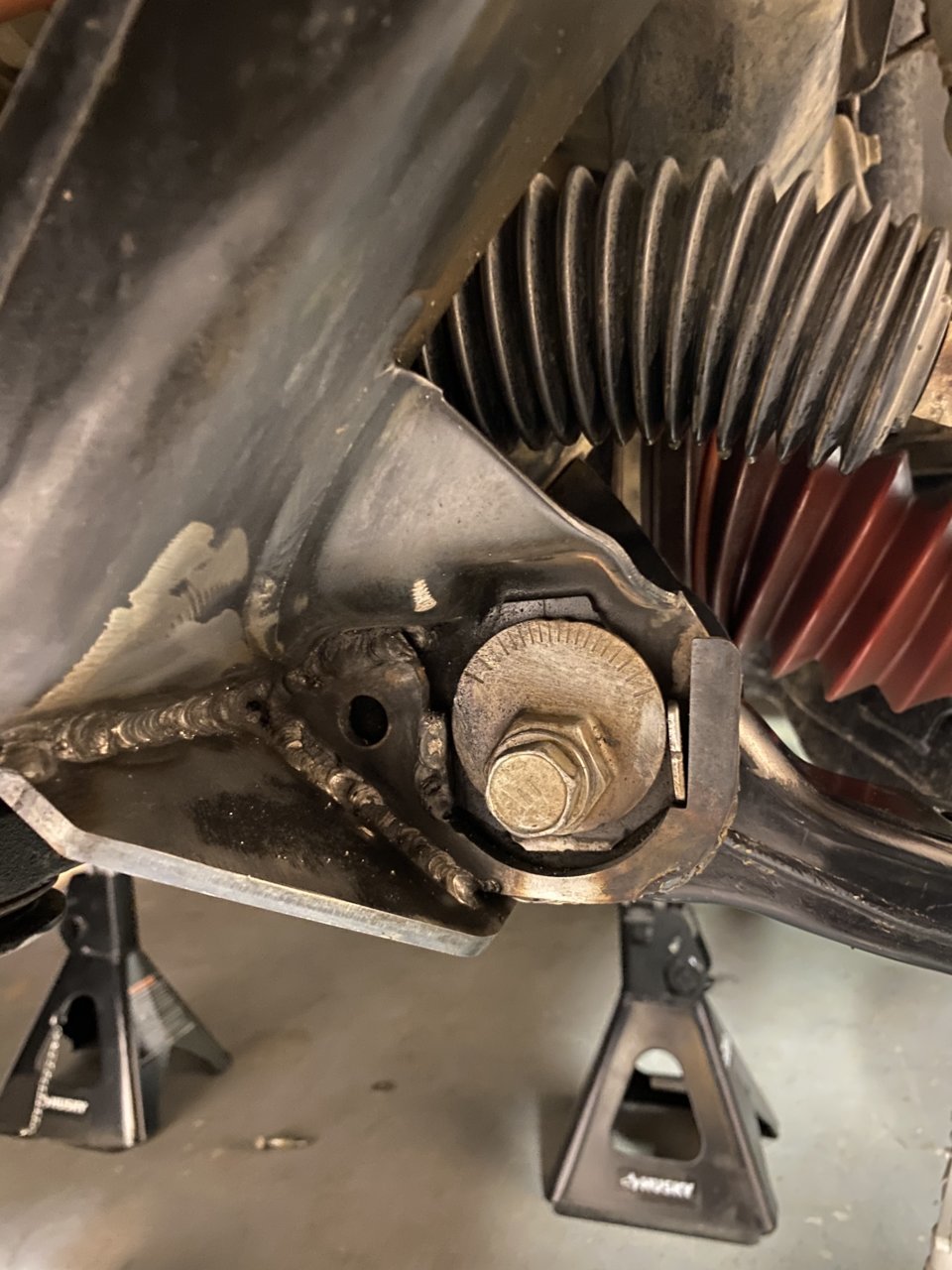

    Started mocking up my MC gussets last night. Mounts pretty bent which i bent back with a vice grip and hammer. also had to do some trimming on the gusset because as you can see doesn't fit right around the cam tab.

    Yea I ended up cutting a little off that tip by the diff cause it was contacting the diff mount. Maybe since my truck was a prerunner? Idk but it’s fixed now. It’s extremely tight and sucks being on the ground trying to weld. We’re you on the ground?

    I was almost directly underneath and slag fell off an went through my jacket and got me. Hurt like a bitch. Im taking extra measures tonight. This is taking a lot longer than i thought it would. Im paranoid so ill like run a bead and squirt a shit ton of water on the mount and wipe it off and wait to cool lol before i start another one. Seems like Powder coat on back side is flaking. Gonna be hard to paint in there.

    Yea might try that i have to figure something out. Not much room to work with.
