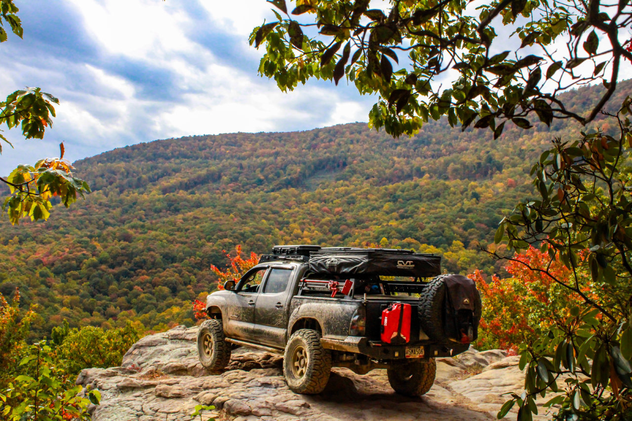

    Went to windrock park in TN with @pdaddy and @TacoFMS . HAd a great time and we got to meet uncle Rico (inside joke)…

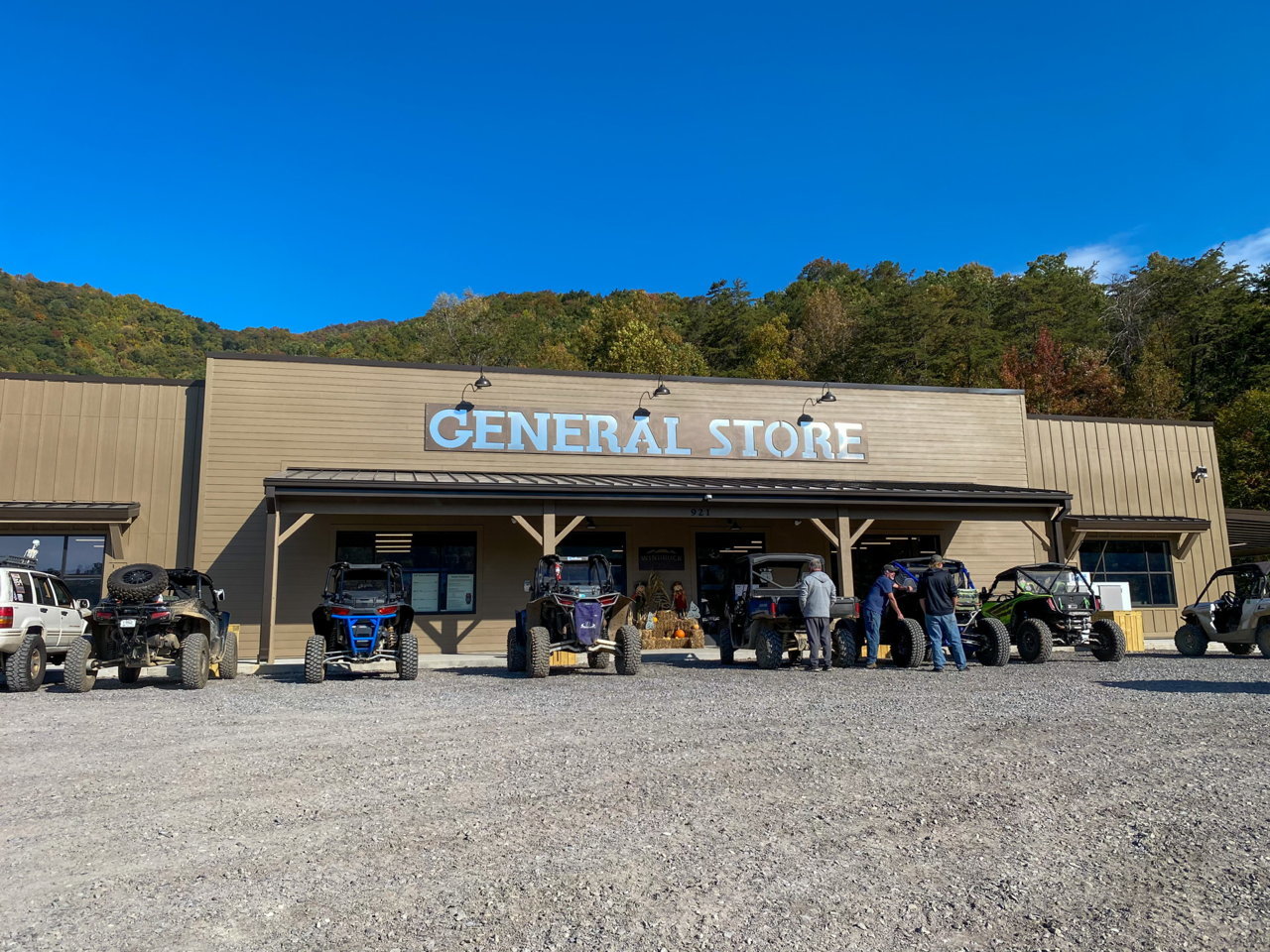

    Yes it is! Store is sweet! Much better than the old one. It’s like a mini bucees if you ever been there.

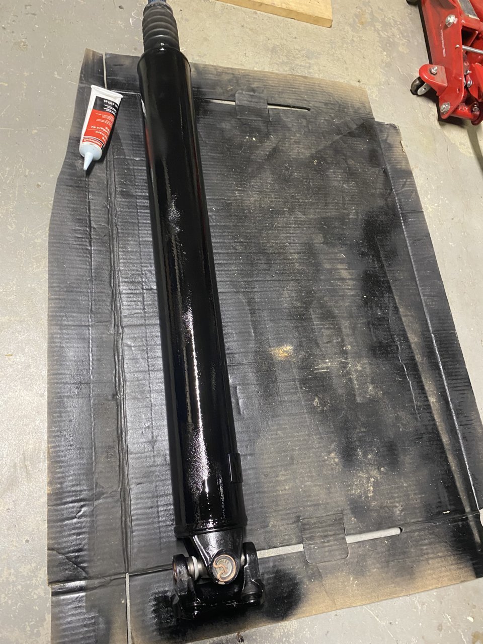

    New driveshaft ready to go in.

    Installed new driveshaft. Didn’t realize how bad my driveshaft was effecting the ride comfort until I changed it. Night and day difference. Also got the truck realigned. Added a .5 top hat spacer to my coil overs. Realized the spec shocks for this kit top hats were just about .5 inches more spaced down than the DK ones. Gained about .5-.75 inch more down travel. CV binding now. Will have to shave cv cups down to take advantage. Truck also sits about level not maybe a slight rake. Pretty happy with how the truck is now. Drives so much better.

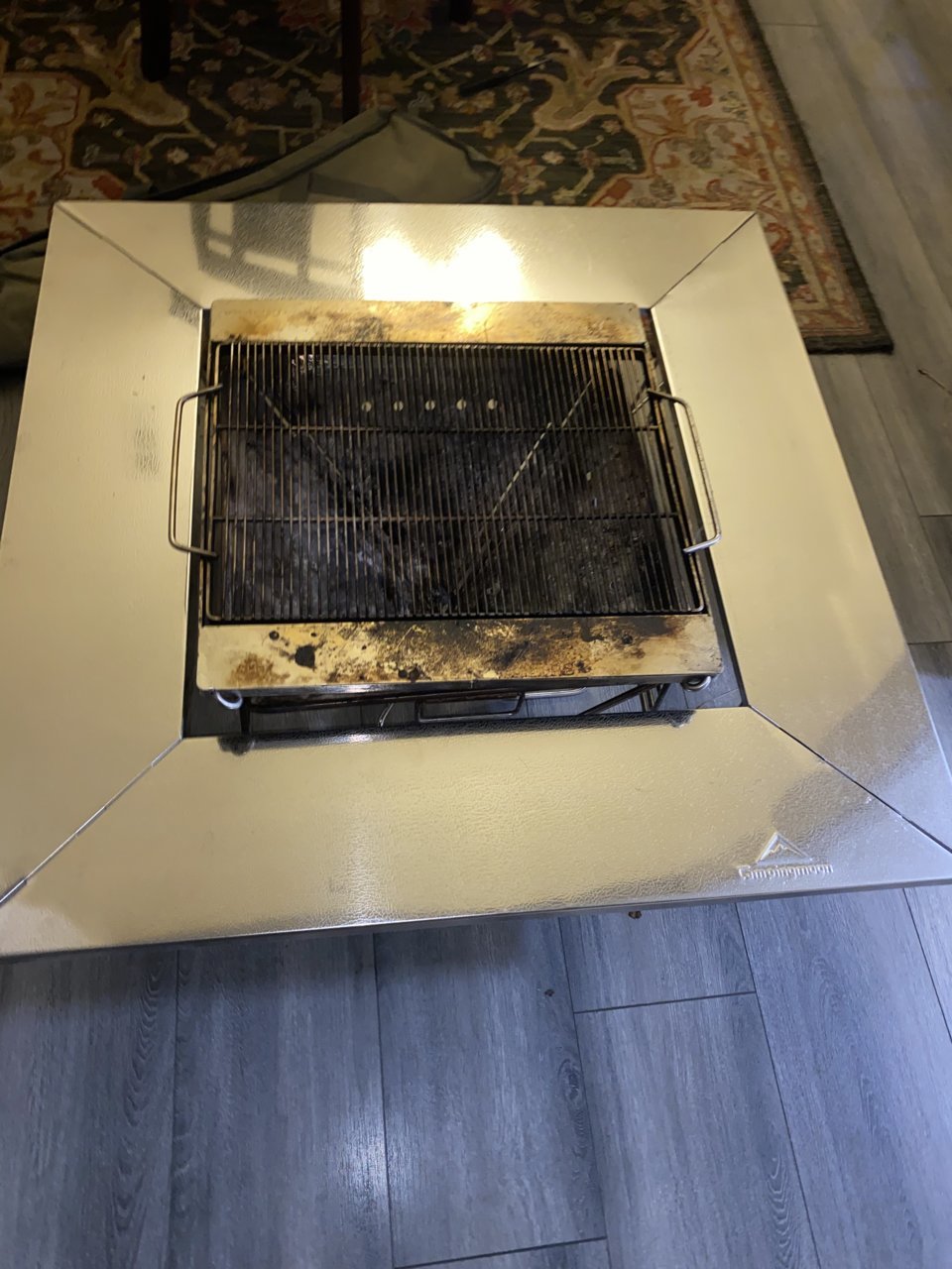

    Picked up the table for my fire pit!
