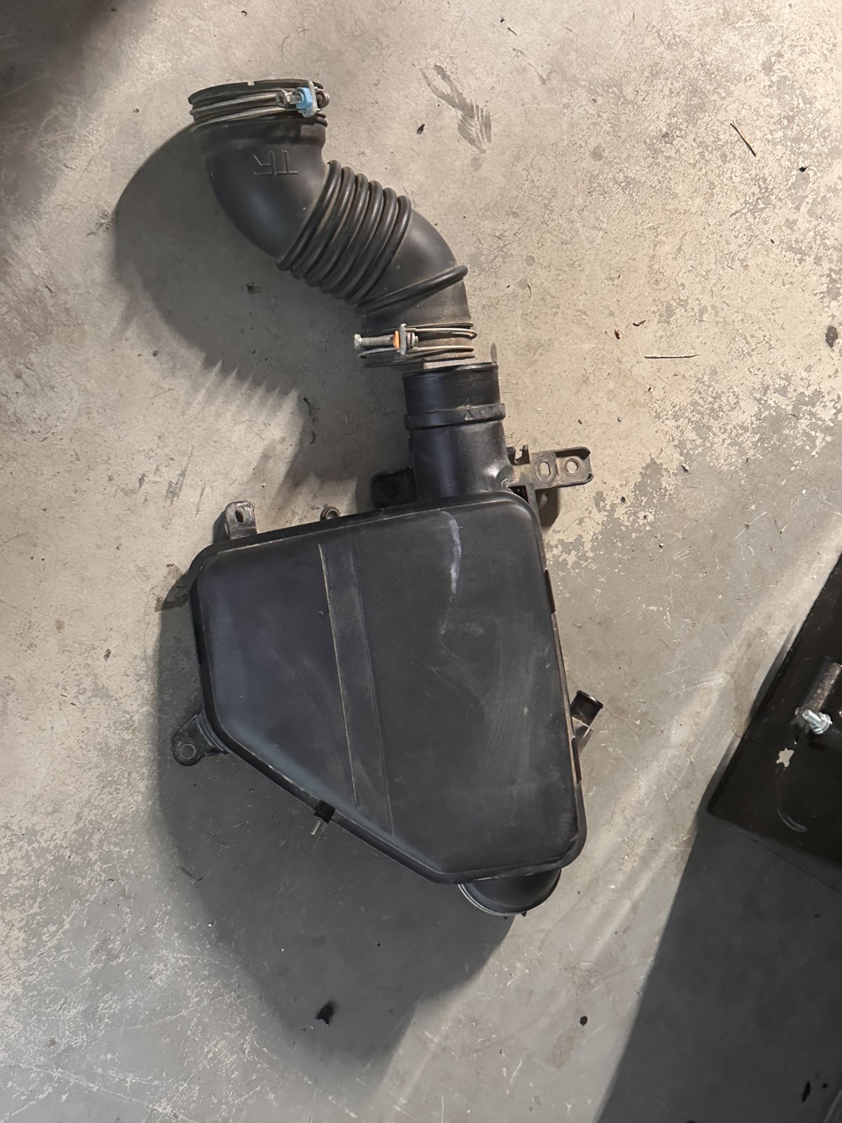

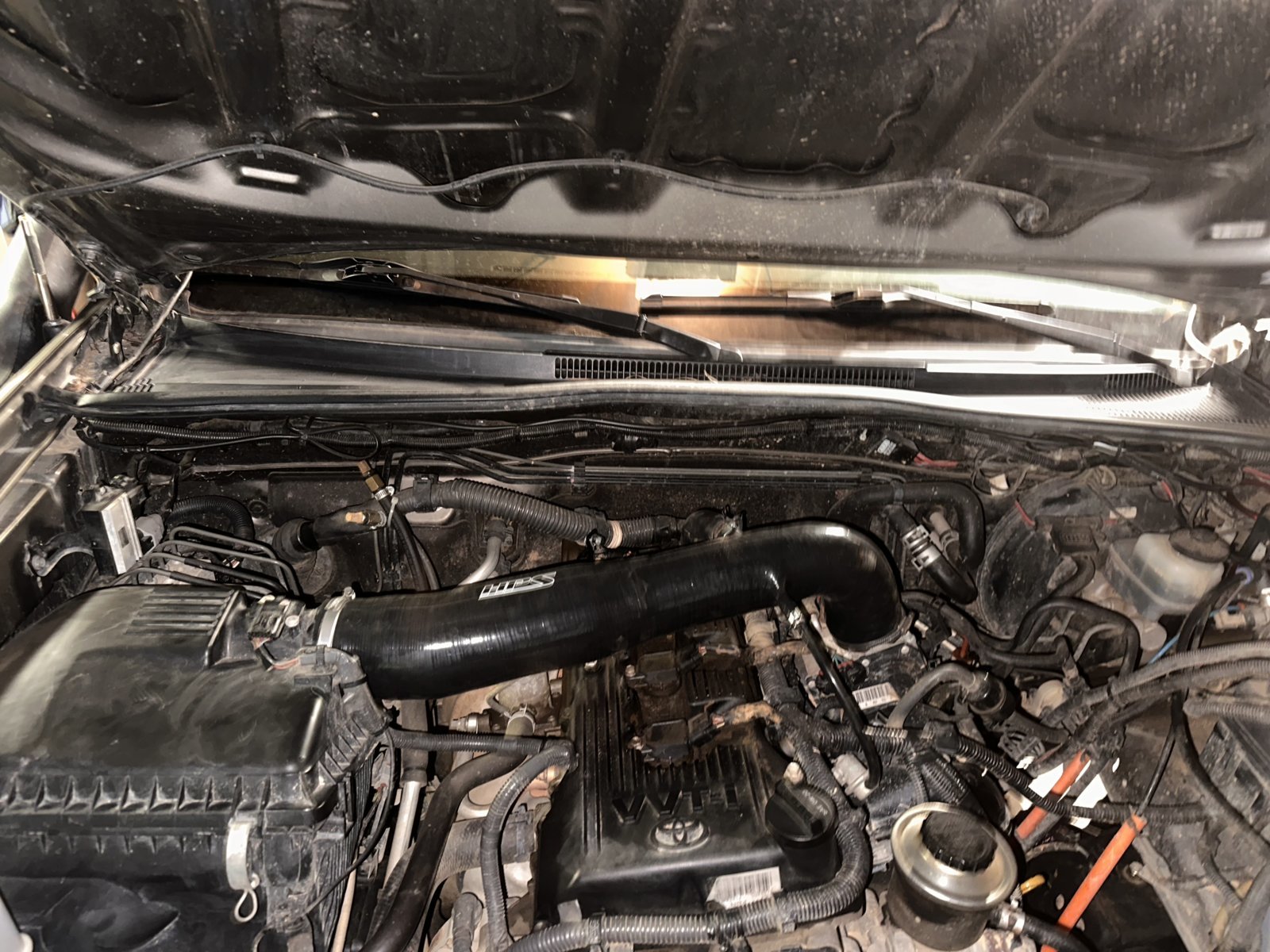

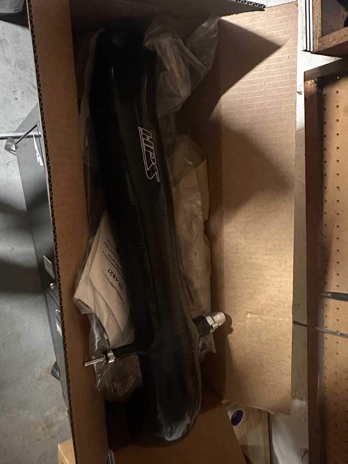

    nstalled an HPS intake tube. Def notice a difference in acceleration. Old restrictive box versus free flow silicone tube lol. It’s a lot louder lol.

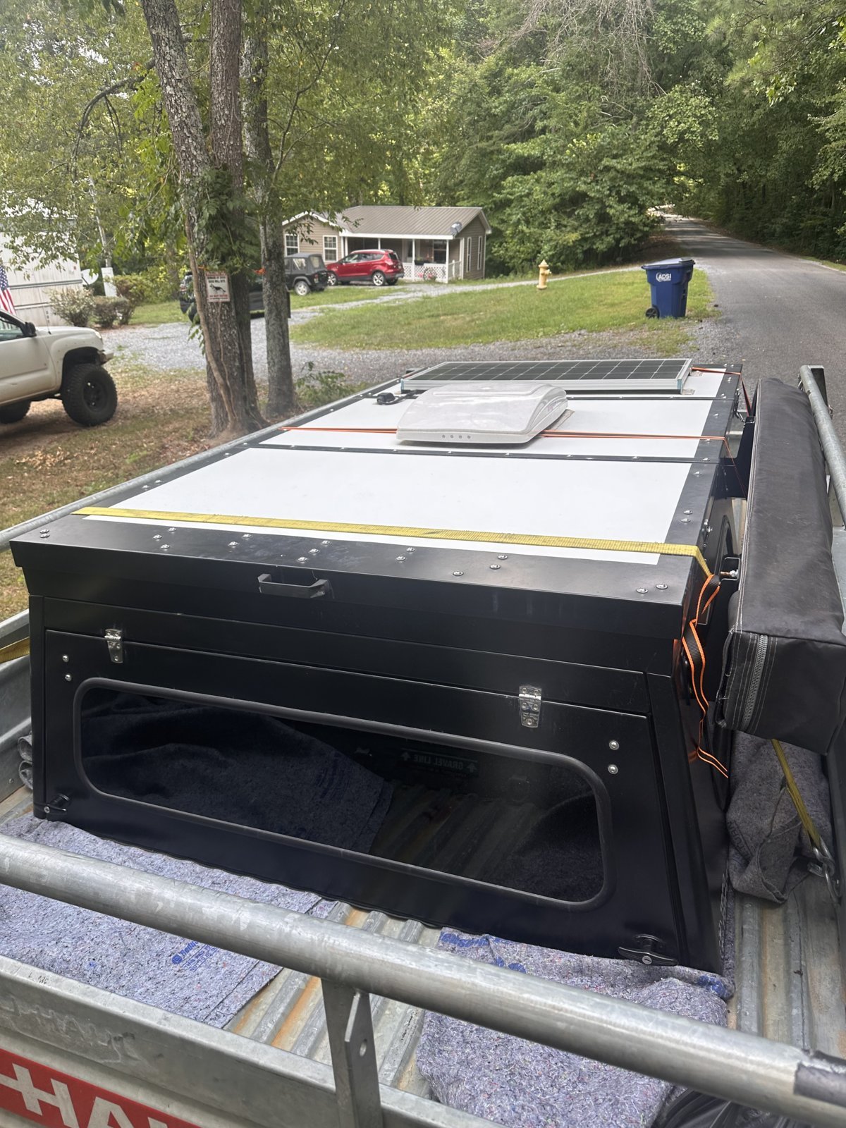

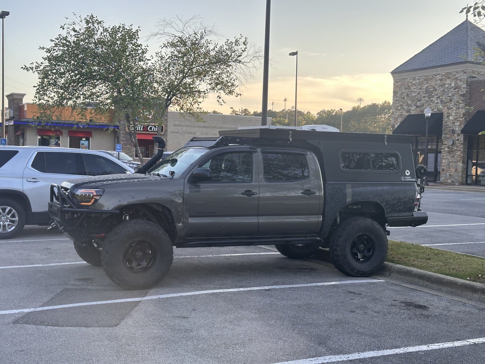

    Started building out camper yesterday.

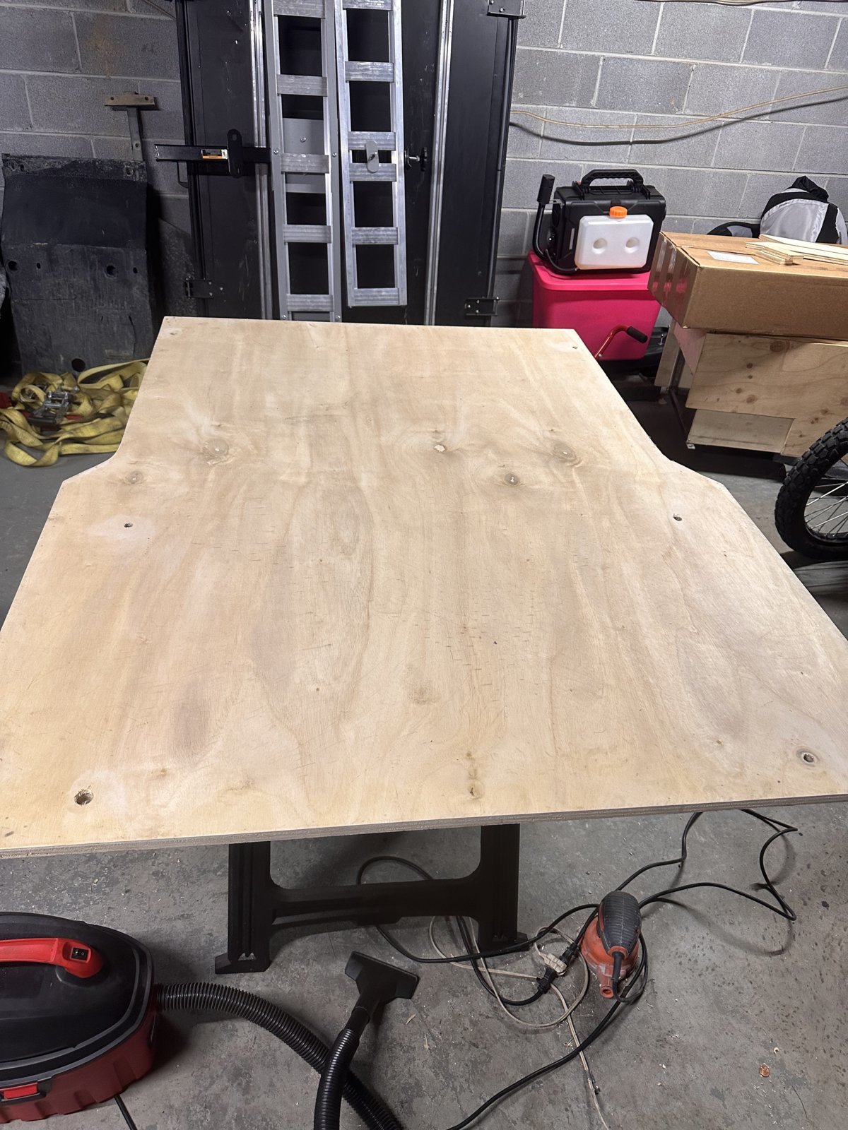

    Been working on the interior this weekend. Loving how it’s working out so far.

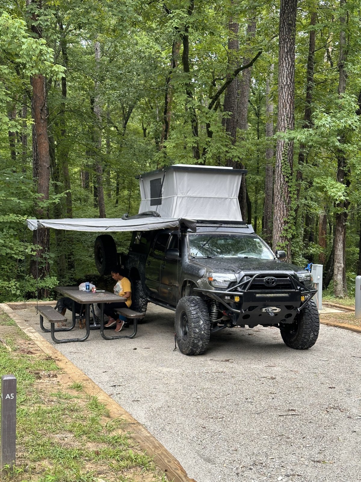

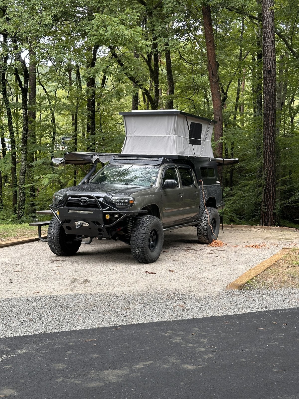

    Trail run camping in camper. Bought a stand up ac. It was nice considering its late July in the south....

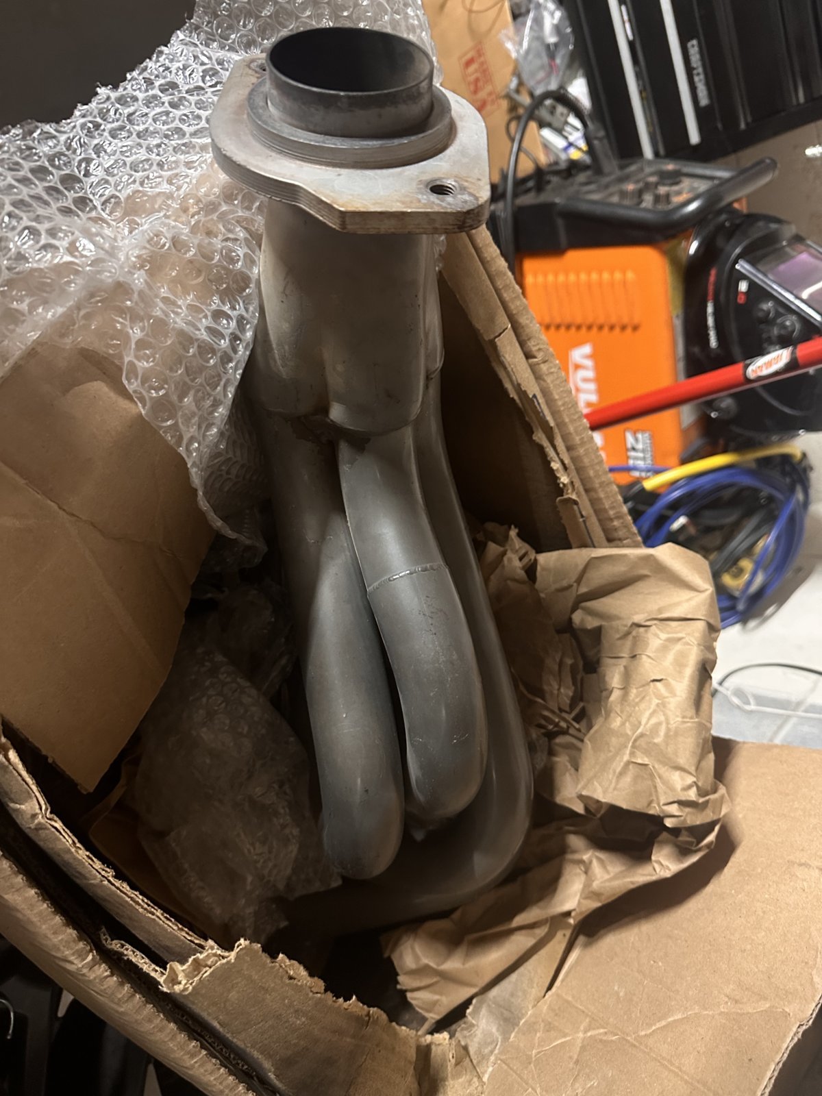

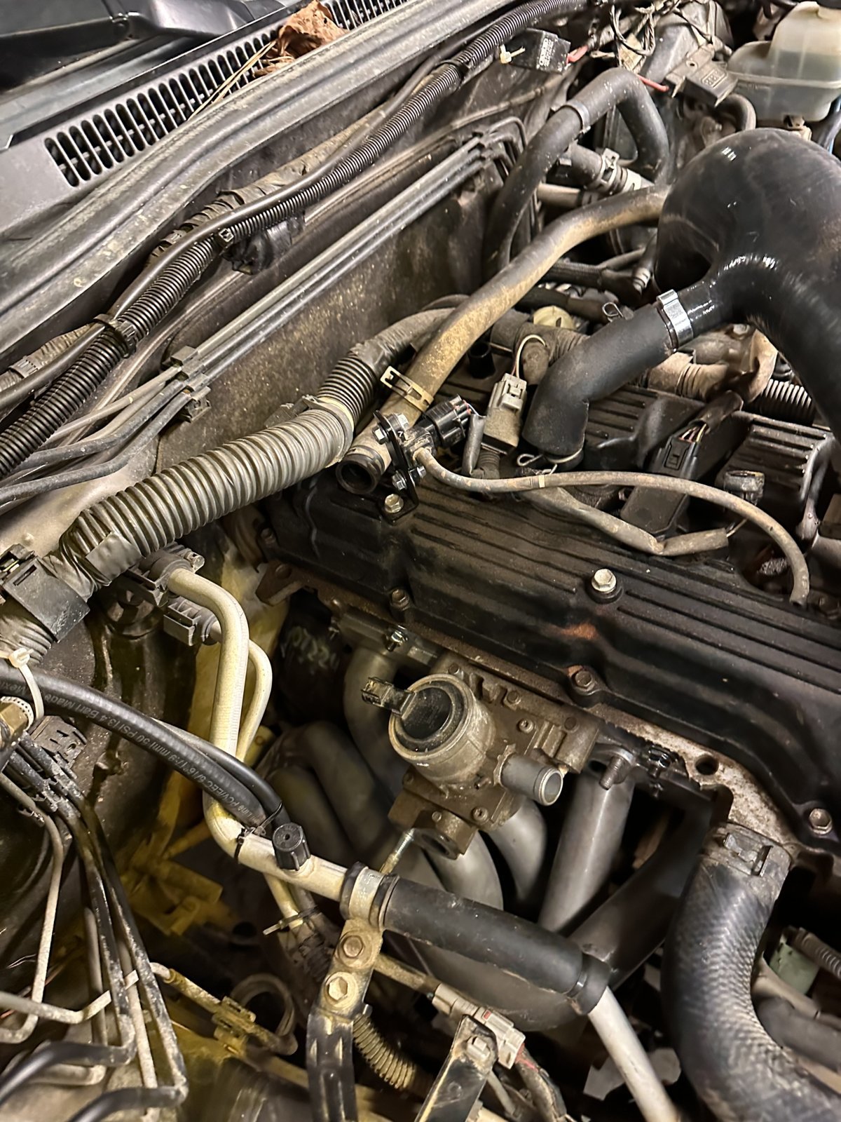

    @BassAckwards finally installing the LCE header. Got everything in now can’t get the air injection system back on studs. Like heart is in way. Any ideas?
  17. Jul 27, 2024 at 5:09 PM
    #1657
    BassAckwards
    BassAckwards Well-Known Member
    May 3, 2016
    #186002
    27,953
    2009 Tacoma AWD Turbo 2TR-FE
    Full-time AWD & BorgWarner EFR 6258
    It looks almost like the studs aren’t long enough. I never ran into that issue.. Would it be possible to remove the studs and find some longer bolts to secure it in place?
  18. Jul 27, 2024 at 5:12 PM
    #1658
    Brian422
    Brian422 [OP] I fell into the pit that is TW
    Jun 8, 2011
    #57958
    15,711
    Brian
    Birmingham, AL
    2012 DBCSB F/R Locked, 35's ,Long travel, 23 Tundra 4x4 limited
    Not Stock
    Isn’t it suppose to be flush with motor body? It won’t slide up against the body. Like the header is in the way or something
  19. Jul 27, 2024 at 5:14 PM
    #1659
    BassAckwards
    May 3, 2016
    #186002
    27,953
    Yes it’s supposed to sit up against the head. Maybe put some grease on it, slide it back on and try to determine where on the SAI pump it’s hitting. Might just need a little grinder action to get the clearance needed
    Brian422[QUOTED][OP] likes this.
  20. Jul 27, 2024 at 5:16 PM
    #1660
    BassAckwards
    May 3, 2016
    #186002
    27,953
    It might also be worth calling LCE to see if anyone else has had fitment issues. I’ve heard of folks with 3rd gen’s having issues, this is the first I’ve heard of issues on 2nd gens
