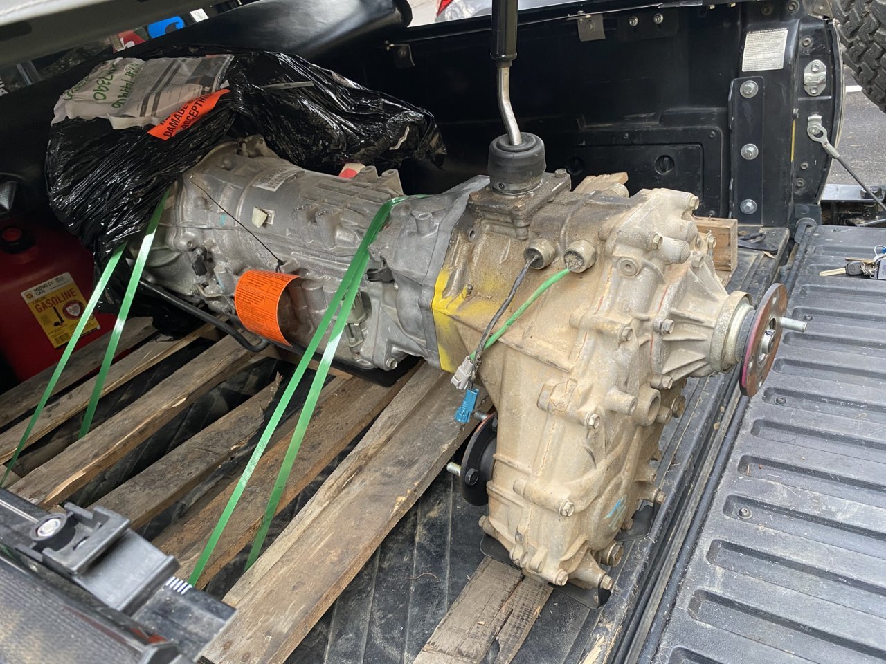

    So fit it up the FJ transfer case to the transmission and it fit like a glove bolt holes all matched up and transfer case for spinning with the transmission even went under my truck and looked at my transmission versus the one that I just bought everything literally is the exact same it’s just that this one has the 4 x 4 output tail shaft on it all they can down to the connectors it all bolts straight up!See pics

    How much did the trans run you?

    It was $700 shipped to my door. Only has 54k on it and 1 year warranty

    Nice! I'd be stoked with that deal, ive thought about putting an auto in mine. Have most of the stuff to do a 4wd swap too. Looking forward to seeing how your swap turns out:D

    Thanks man! I’ve still got a ways to go as far as materials. Still need front diff. Also going to probably get a custom rear driveshaft built. Going to have the only 4x4 double cab 4cyl. I’ve never seen one before lol

    Yes. And a 4cyl. And it’s swapped to 4x4 with an FJ t-case.

    Dang same thing im doing lol. Nice to know someones done the exact thing im doing haha. Hows it drive now?
