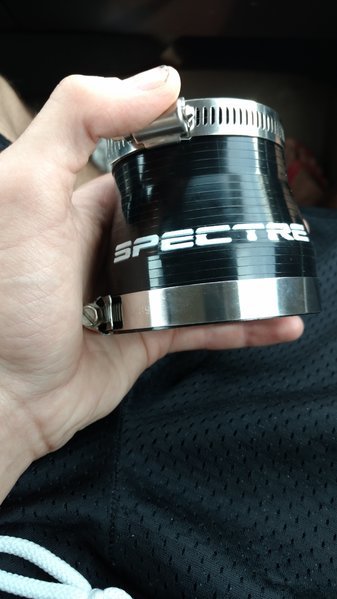

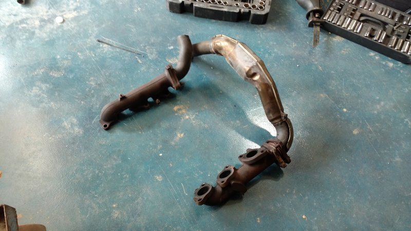

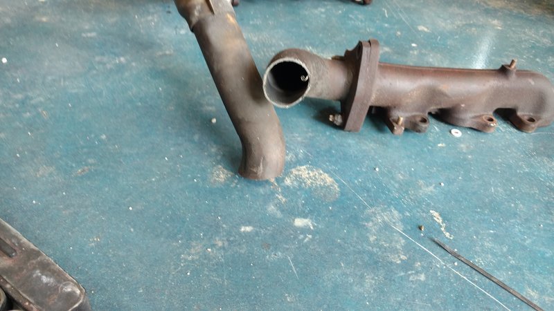

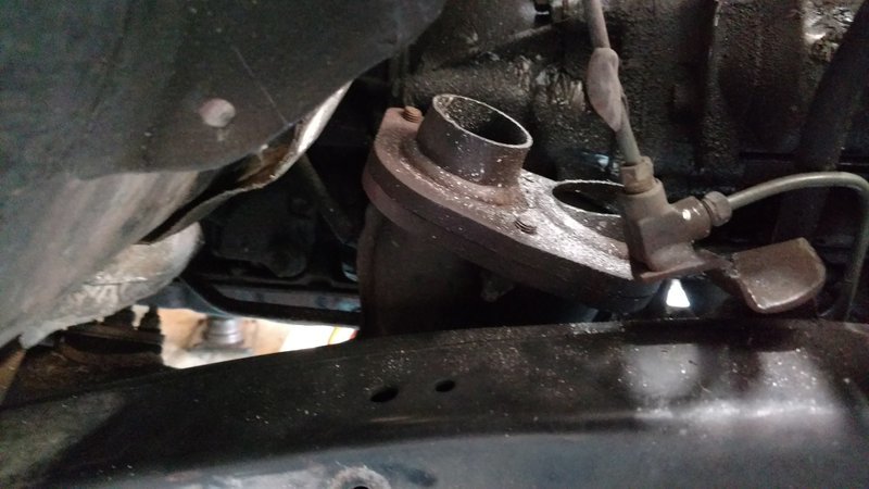

    Went ahead and ordered those two GM knock sensors and Intake gasket set. I already have the gaskets for the drivers side valve cover so guess I'll tackle that when I pull the intake. I also picked up some 3" to 2.5" silicone adapters at the auto parts store, as The stock MAF has a 3 inch body not a 2.75" as I had thought. Another lesson learnt I guess :D In other news...STOCK EXHAUST SUCKS! lol I ended up cutting the crossover on the passenger side and was able to unbolt it on the drivers side, after that it slid right out of the drivers side. Tomorrow I should be able to disconnect the lower portion, muffler, tail pipe etc... and get my inter cooler, oil cooler and manifolds mocked up. I was thinking of doing a side exit exhaust through the frame by cutting a hole, welding a pipe inside the frame and running my exhaust out behind my running boards to get a sort of corvette vibe :D Idk if the frame is even wide enough laterally to let that work...but I'll see tomorrow! Goodnight.
    P.S. My stock manifolds were CLEAN like super clean. I had to really scrape my thumb across the insides of the manifolds to get any sut at all, this is encouraging.
