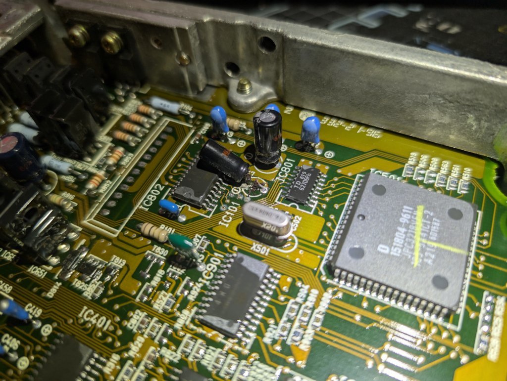

    It wasnt, but the multimeter I have cant do capacitance and the one that can doesnt have a battery.
    Spoiler, still didnt fix it.

    Probably yes. I was going over the diagrams that @Speedytech7 shared and I think I need to test the IGT and IGF wires before deciding on a new ECU. Last night I stole the caps off of my old 5vz ECU and basically recapped the Camry ECU (albeit with 25 year old caps vs 28 lol)

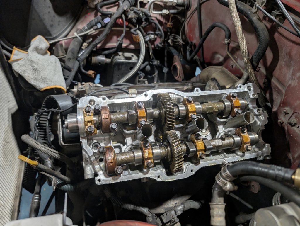

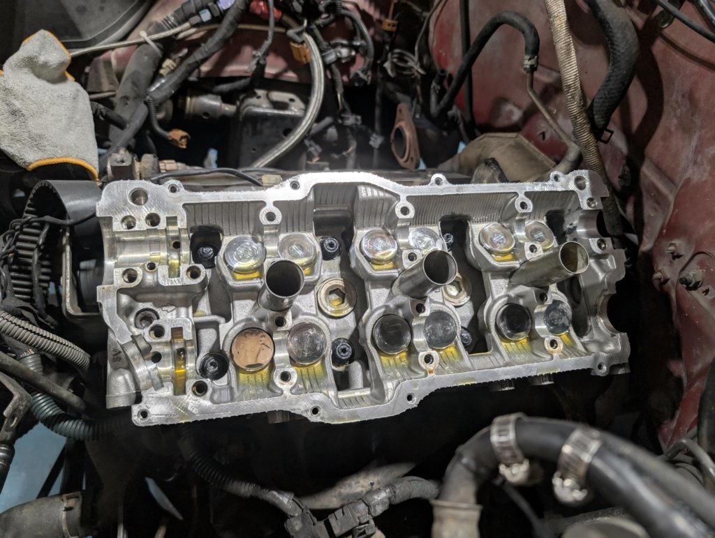

  11. Dec 27, 2024 at 7:16 PM
    #1991
    Brice
    Brice [OP] Turbo Member
    May 28, 2015
    #156265
    2,301
    Brice
    Texas
    1999 Tacoma PreRunner V6 SR5
    Wastegate assisted turbo delete

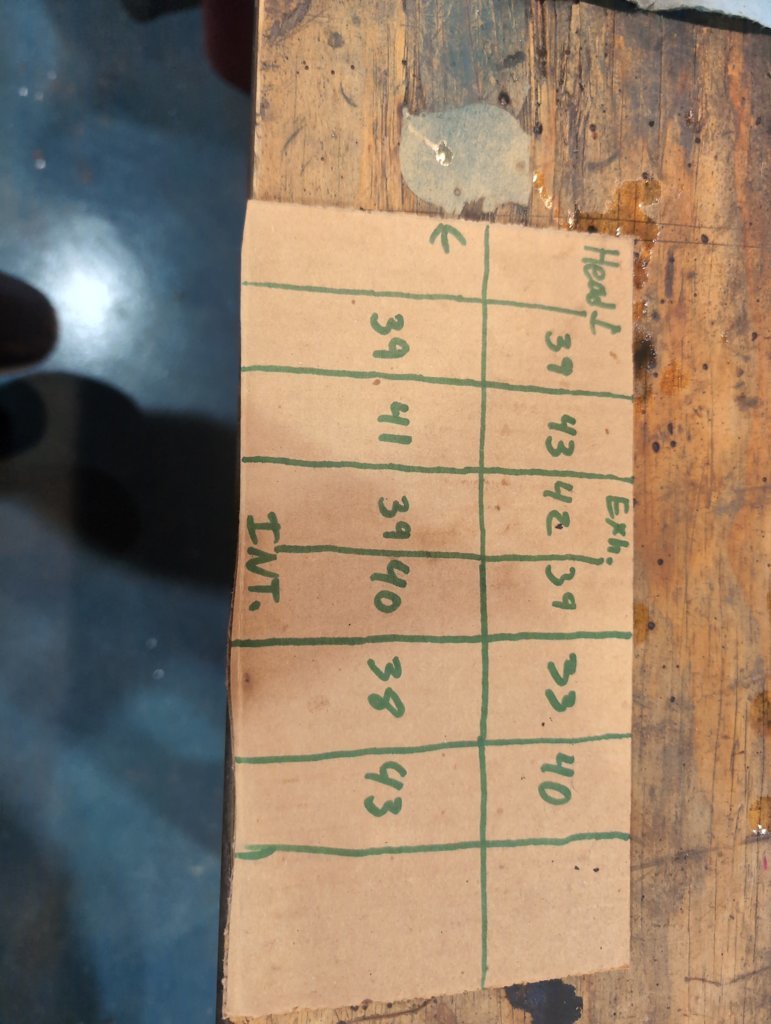

    Minor update on the truck: driver side cams, springs, buckets, head gasket and head studs have been installed. Below are what I used for shims, probably not useful to anyone but hey.
    Speedytech7 and unstpible like this.
  12. Dec 28, 2024 at 9:15 AM
    #1992
    Torspd
    Torspd Tor-nication
    Sep 18, 2009
    #22958
    26,300
    Tor
    The Great America!
    MMVI 4.4L 4x4 Access Cab
    Torspd Custom Turbo kit [] Borg Warner 9180EFR Turbo [] Haltech Elite 2500 [] TiAL Q BOV [] TiAL V44 Wastegate @ 15psi [] CP Pistons [] CP Carrillo Rods [] ARP Head studs [] ARP Main Studs [] ARP Header - Head Studs [] Ported Heads w/ 1mm oversized valves intake/exhaust [] Brian Crower Forged Stroker Crank [] Darton M.I.D. Sleeved Block [] Kelford Camshafts [] Torspd 160* T-stat mod [] APR Large Fuel Rail [] Walbro 460 LPH E85 Fuel Pump [] FueLab FPR [] APR T56 Conversion Kit [] KP RACING Built T56 [] McLeod Racing Custom Twin Disk Clutch [] One Piece Aluminum Driveshaft [] MGW Shifter [] Custom lowering kit [] Ohlins Front Coilovers [] QA1rear shocks [] Custom Ron Davis Radiator [] Dual SPAL Electric Fans []
    As long as all of the lash tolerances are good, well done.
    Brice[OP] likes this.
  13. Dec 28, 2024 at 12:30 PM
    #1993
    Brice
    May 28, 2015
    #156265
    2,301
    Brice
    Texas
    One of them is slightly out of spec (0.39mm vs 0.37mm max) and is a bit lose on the exhaust side, I doubt it'll be an issue other than a minor click.
    Torspd[QUOTED] likes this.
  14. Dec 29, 2024 at 5:25 PM
    #1994
    Brice
    May 28, 2015
    #156265
    2,301
    Brice
    Texas

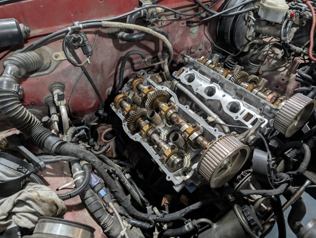

    Side 2 done. Tomorrow I'll be modifying some cheap eBay headers and moving towards reassembling this thing.
    Speedytech7 likes this.

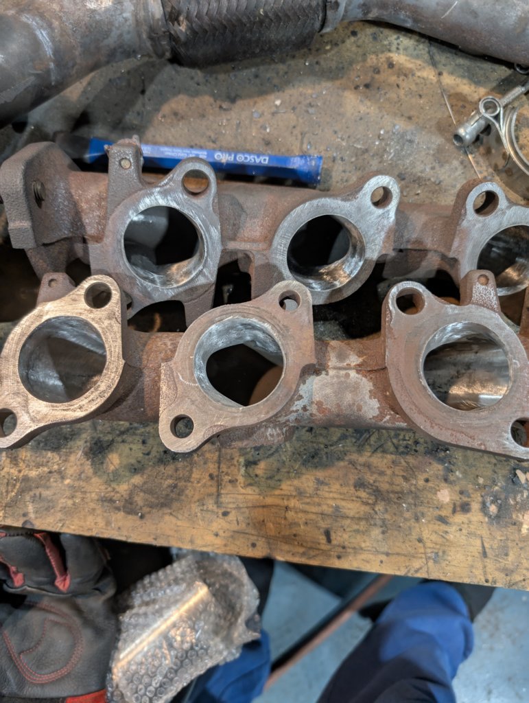

    The cheap eBay headers? Yeah they suck. I wasted alot of time learning this. So I've decided to run a stock ish exhaust with a 1gr muffler and 2.5" inner diameter tubing for now.

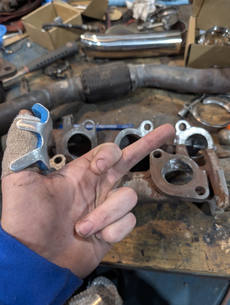

    Anyway I'm not sure what the rules are concerning gore/blood but while I was porting the stock manifolds to match up to the larger exhaust ports on the head, I slipped.
    I was using a single cut carbide burr about 3/4" in diameter and my right hand thumb started to get tired, so what I did was engage the die grinder with both hands and my thumb had enough umpf to hold the trigger in place. Unfortunately once I slipped the burr jumped across the top of my left hand thumb. It hit something hard so figured it did some damage. And damage it did! It cut straight through my skin and lacerated the tendon that allows the tip of the thumb to flex outward away from the palm. Luckily it only went through about 60% ish of the tendon. Thankfully it genuinely didn't hurt and I was given some stitches and a splint. Still feel fine except I can't use that thumb and have typed all this one hand lmao.
    I'd post the after math but it's quite uhhhh explicit, which is kinda cool because I could watch the tendon move around lol.

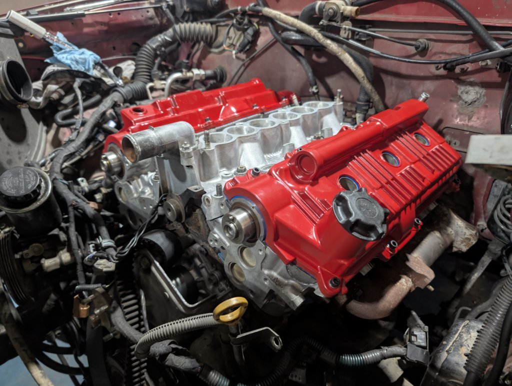

    Today's progress:
    I've been sick since last Thursday with something awful so today was the first day I've done anything productive since slicing my thumb open.
    Stock exhaust has been installed as well as valve covers and seals.
