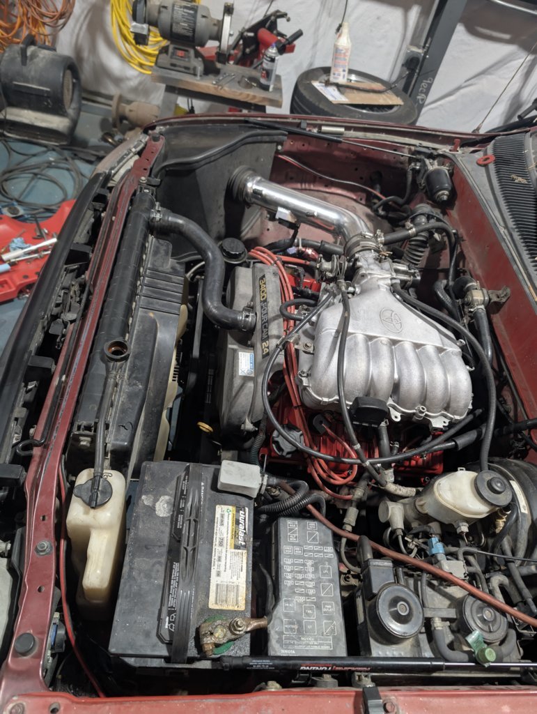

    Wastegate assisted turbo delete
    This isn't a great pic but I finished last night around 11:30. Truck runs! It still smokes a little but I think it's residue in the cat.
